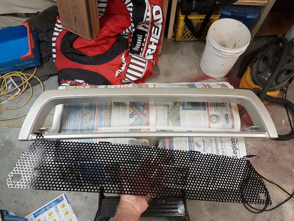

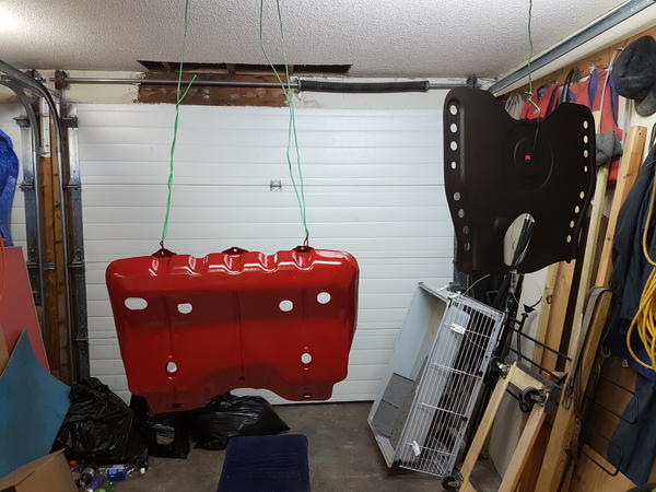

Re-painted the crash plate and grille yesterday.
It was just laying in the back. I worked on the truck late this week and didn't feel like moving it indoors and rain was coming.
It's a rather large 3tons hydro high-rise jack.
Not that heavy, it's just the floor basically didn't exist where I put it.
It didn't fall through, it's just the caster that "fell" in the floor.

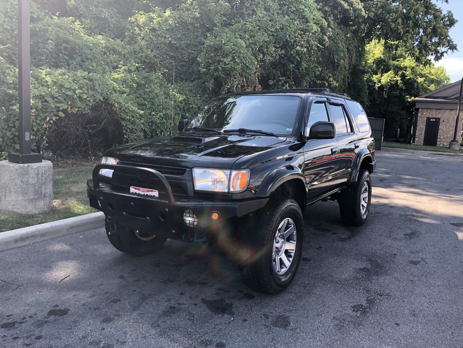

Installed a sport hood picked up at the junk yard yesterday in good condition of a same year black 2002, got it for $150.

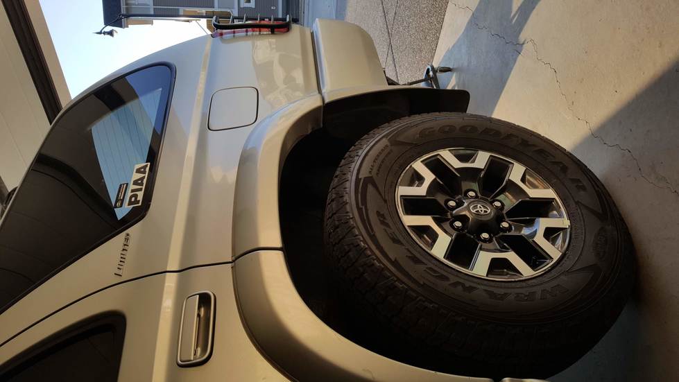

Installed some 3rd gen Tacoma rims and tires

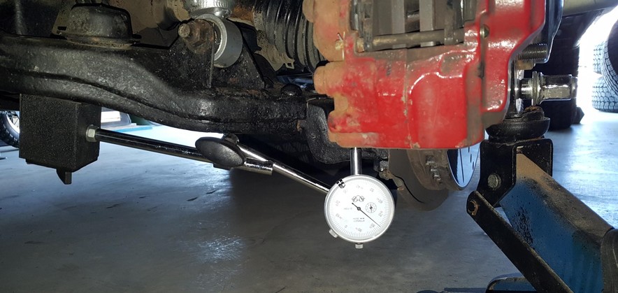

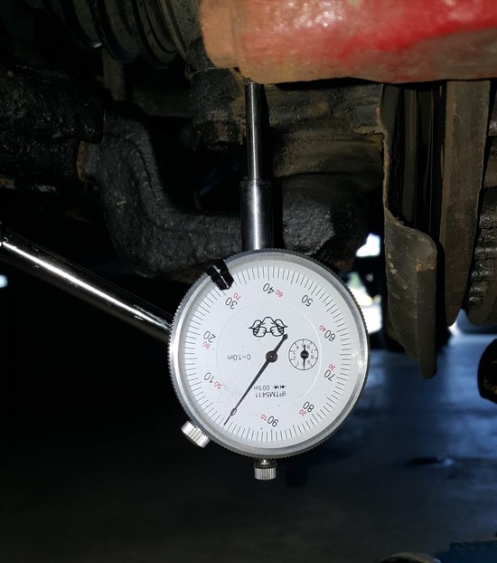

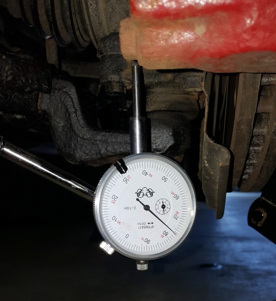

Measured ball joint play...
yes its out of spec.. guess who's ordering parts RIGHT NOW
Max is supposed to be 0.020" and i got 0.023"
Will post up some pics of the joint once removed, that's the source of the clunk i have been getting in the last few weeks

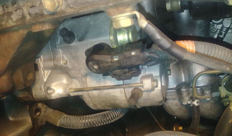

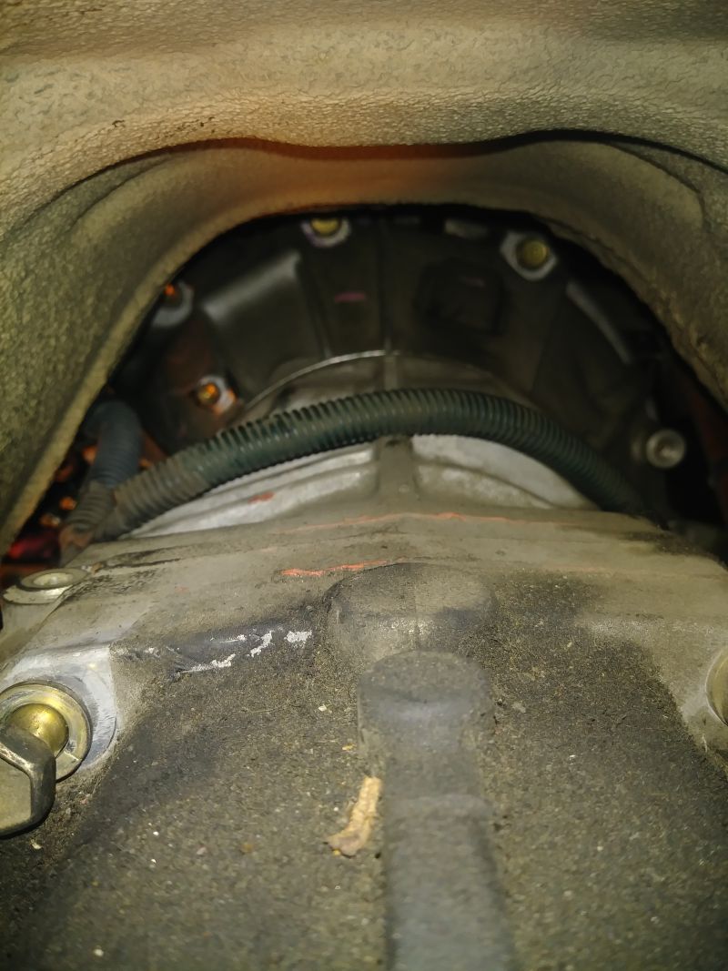

What I did last night was attempt to replace the clutch, where I'm stuck at figuring out how to unbolt the starter at the bellhousing where I can't see or feel the bolts that need to be removed yet.
So the last thing I did that was successful was remove all the electrical components and wiring harnesses so that the crown of the tranny is clean now. LOL.
Right around 'behind' the starter. They go in from the transmission side. Feel around the back of the exhaust, one on the top, one on the bottom. An extension and a swivel will be your friend...
How's that dial indicator treating you? Would you recommend someone purchase the same one? If so, could you please provide a link to where you purchased it? Thanks!
Thanks Charlie for confirming that both bolts go in from the tranny side because every hint helps when all I want to do is "remove two 14mm bolts" on the starter as part of the DIY to disconnect stuff from the transmission.
Your hint allows me to stop wasting time looking from the starter toward the transmission where I can spend my time looking from the transmission toward the starter. I can't believe how hard it is to find the missing two bolts.
But did I find the first one already or not?
Is the one bolt that I circled in the previous picture one of those two bolts?
(Also does the starter actually come out or do I just leave it dangling on wires like I did the slave cylinder?)

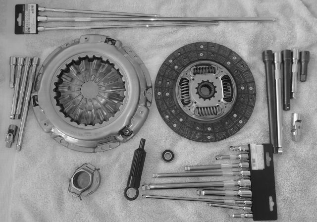

Regarding the extension bars and swivels I have PLENTY where this picture shows some of them as I was preparing the tools! LOL
Are you working on a 4-cylinder? The pics don't really match up with the V6 (starter is on opposite sides, I think). You'll find the last bolt, we all have faith!
As for the starter itself, if you can find a decent spot to set it, just leave it hanging. Make sure your battery is unhooked - the main power cable to the starter is UNFUSED and will cause major problems if it shorts to the engine/body/frame.
-Charlie
Yup. 3RZFE 4-cylinder. 5-speed manual. Starter is on the driver side.
If it's the last bolt then it must be on top of the starter 180 degrees from the bottom bolt since the bottom 14mm bolt that came in from the transmission side came out when I disconnected the brake line & harness combined bracket.
Thanks for letting me know I can leave the starter dangling on a wire. The battery negative is disconnected.
I may take off the driver side wheel (easy enough) to see if that gives me more room to at least SEE the damn upper 14mm bolt and maybe the sway bar but I don't want to remove anything that won't help or that I don't have to.
I'll go back and look now that you've confirmed I only need to look in from the transmission side for the head of the hidden upper bolt.
