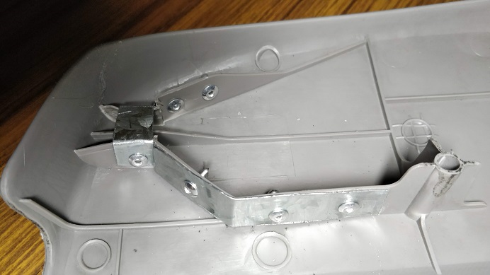

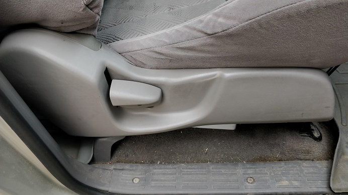

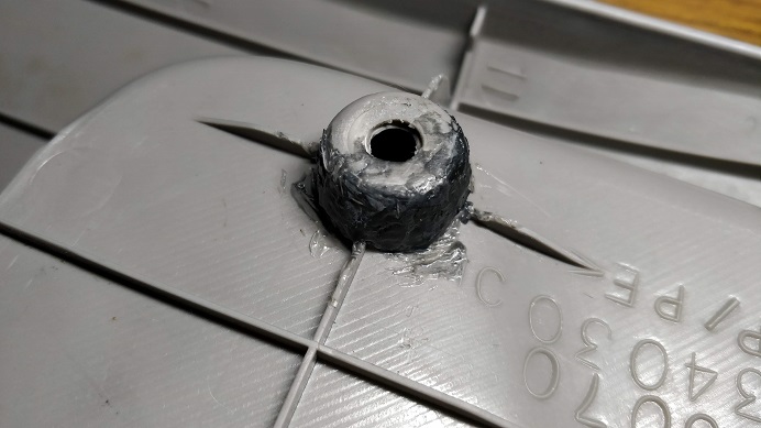

Every single passenger that I have ever driven slides out of the seat rather than lifting their lazy a**es out... So, like many 3rd gens, the plastic panel on the outside of the seat has been broken for forever. Finally got around to fixing it! A little plastic welding, some wire mesh, scrap metal and a few rivets did the trick :)
