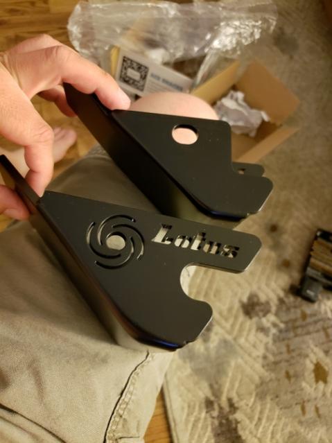

I got some Lotus lower control arm skids. I figure it's done cheap insurance.

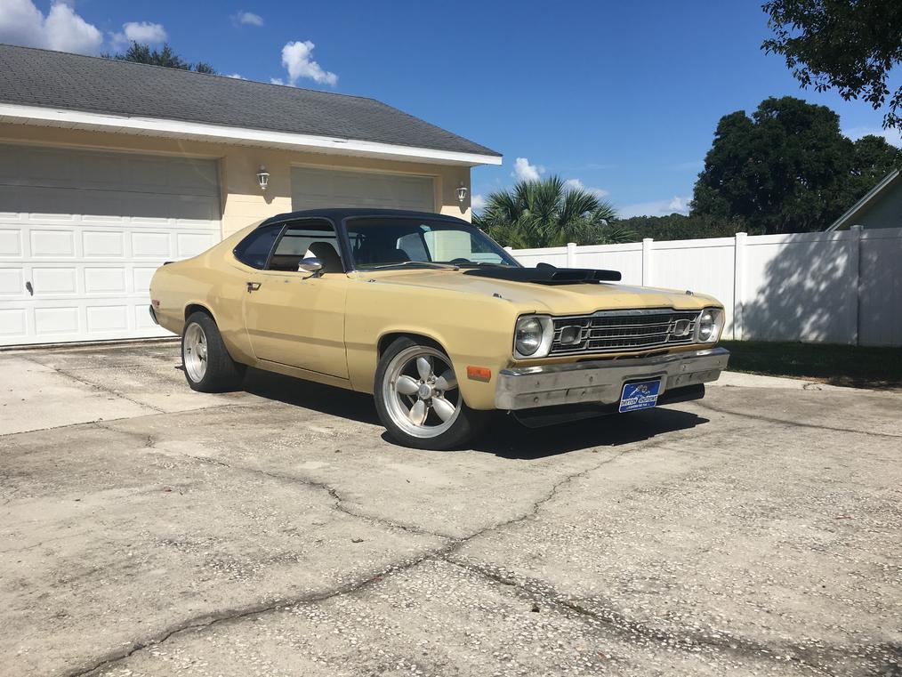

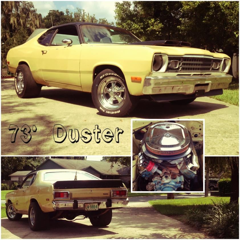

How have I not noticed the 73 Duster before? Right on, I rarely see any others around anymore. Here's my 72 340 car, parked in it's reserved spot haha.
The duster also has a champion radiator, they are a great value for the price. 4Runner is still going strong with a factory one.
Damn she looks great! Nobody plays with the old stuff any more especially in the 21 and down age group. Everybody has a new Mustang or Camaro except me :dancin:

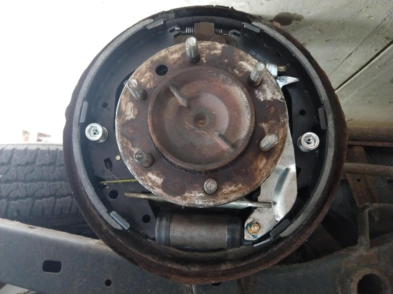

Finally got the rear brakes finished on my '01! Started because I had a cylinder that had burped fluid a couple of times under hard braking. After replacing the cylinder and shoes, I noticed the drums were a little over dimension, so I replaced them as well. After putting it together I thought I would adjust the parking brake. At that point I realized the bellcranks were seized, so I tore the brakes apart one more time and ordered one more part and replaced them as well. Lastly, I removed the console and adjusted the tension on the parking brake cable. Overall between fixing the front bakes a couple of weeks ago and now the rear, there is a huge improvement in braking on the runner, and I even have a functional e-brake! Not sure why the image flipped over when I uploaded it...I assure you I didn't work on it upside down!

Very cool, I think my bell cranks are seized too. Been hesitating to take the rears apart. soon! Congrats
