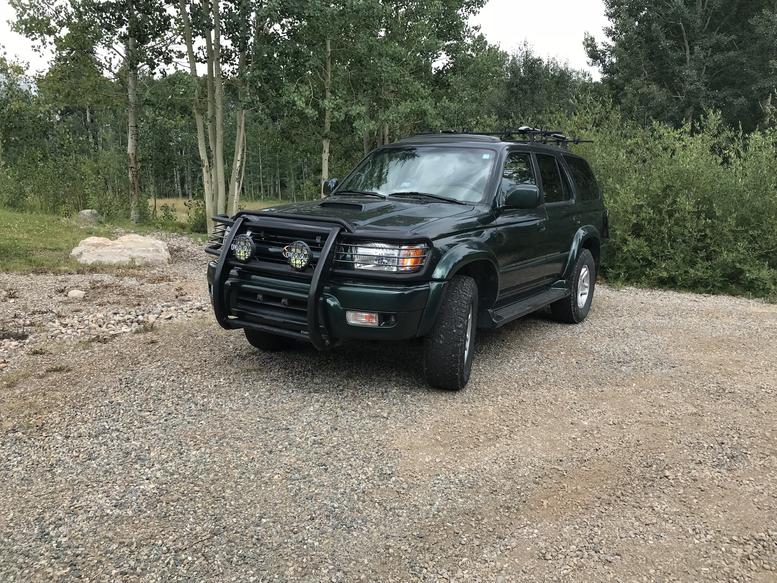

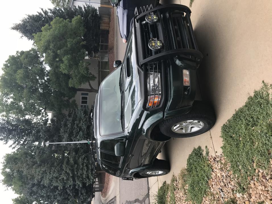

Pulled the running boards off my otherwise bone stock '00. Hopefully first in a long line of minor changes
Before & after pics...not sure how to rotate attachments

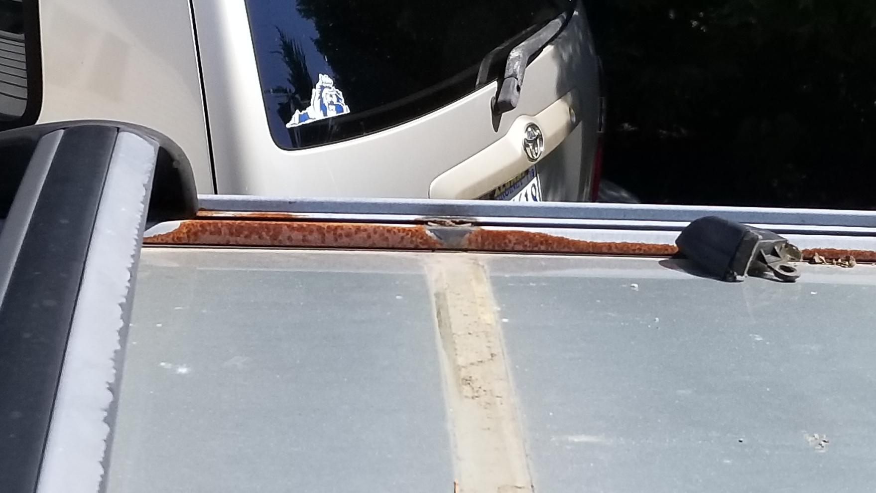

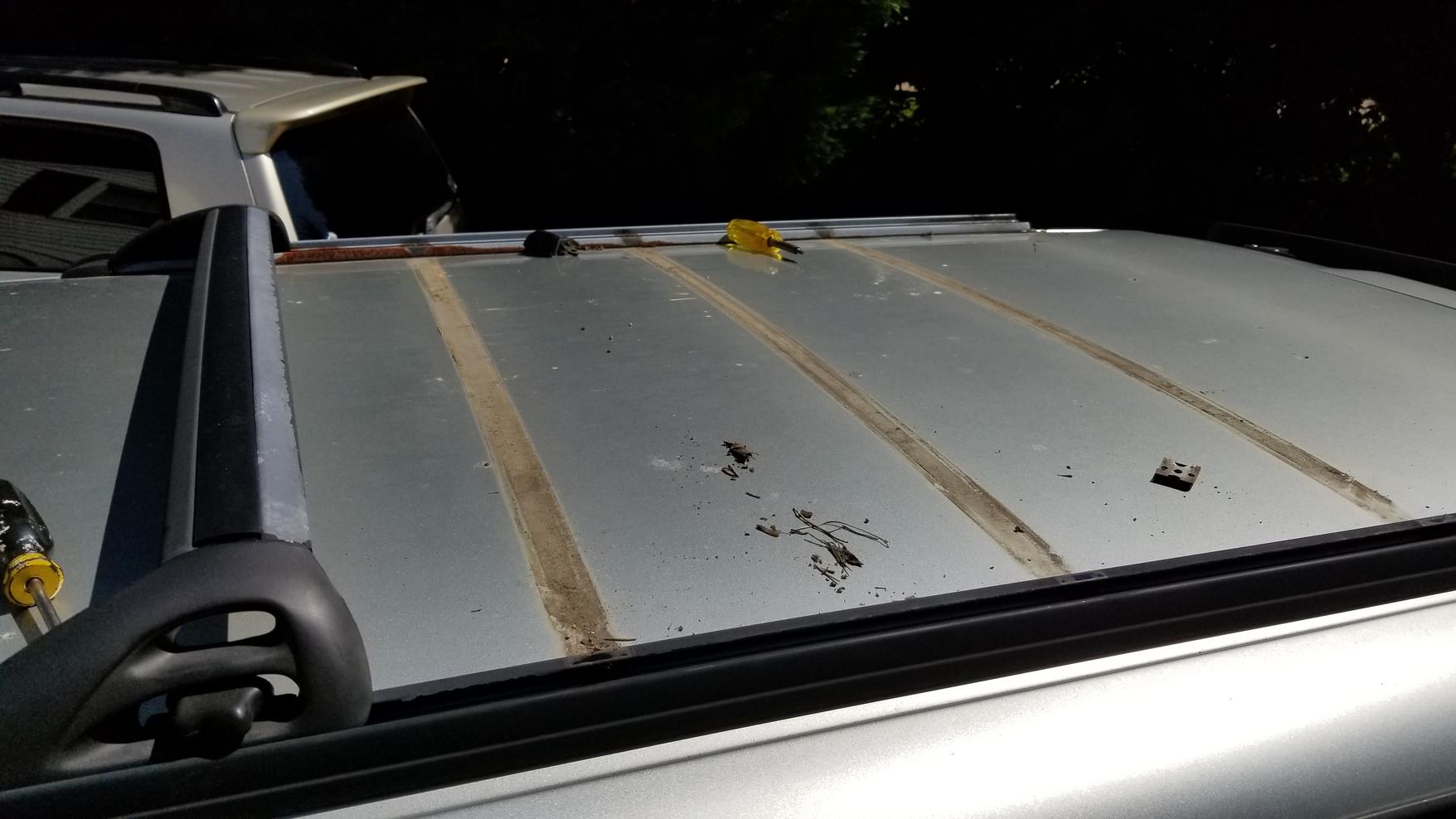

Started pulling off the stock rack to add Thule crossbars and basket. Found a nasty bit of rust. Will be pulling the stock rack off and have it powder coated.
Anybody else remove the roof rack? Is water leaking an issue?
Yup. Those screws go right through to the inside. If you take the roof rack off and leave it, you will have holes directly in to the space above the headliner. Maybe put the screws back in and seal them up temporarily.

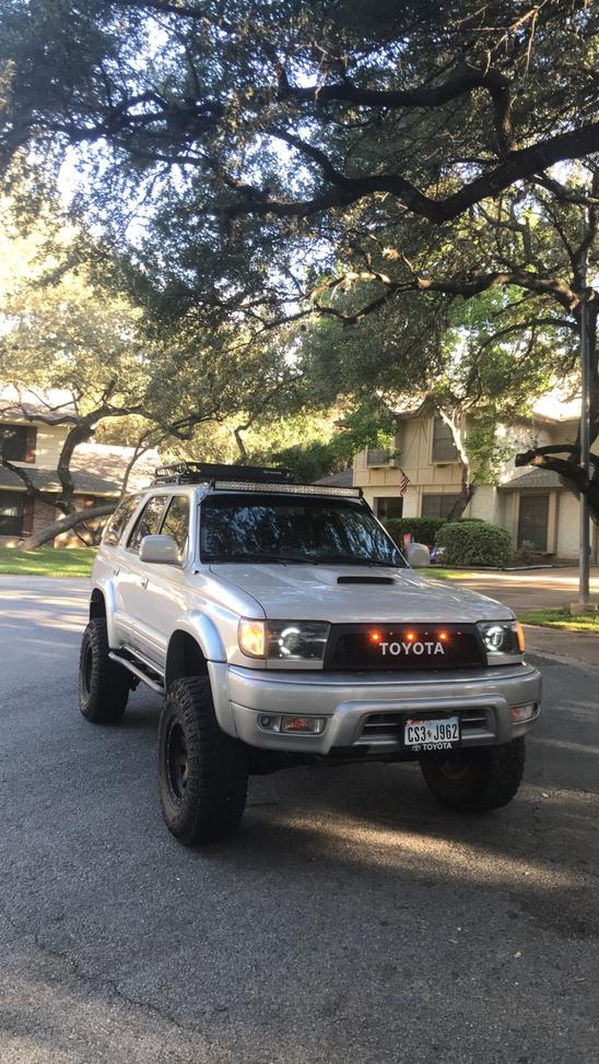

Went from the top pic to the bottom pic.

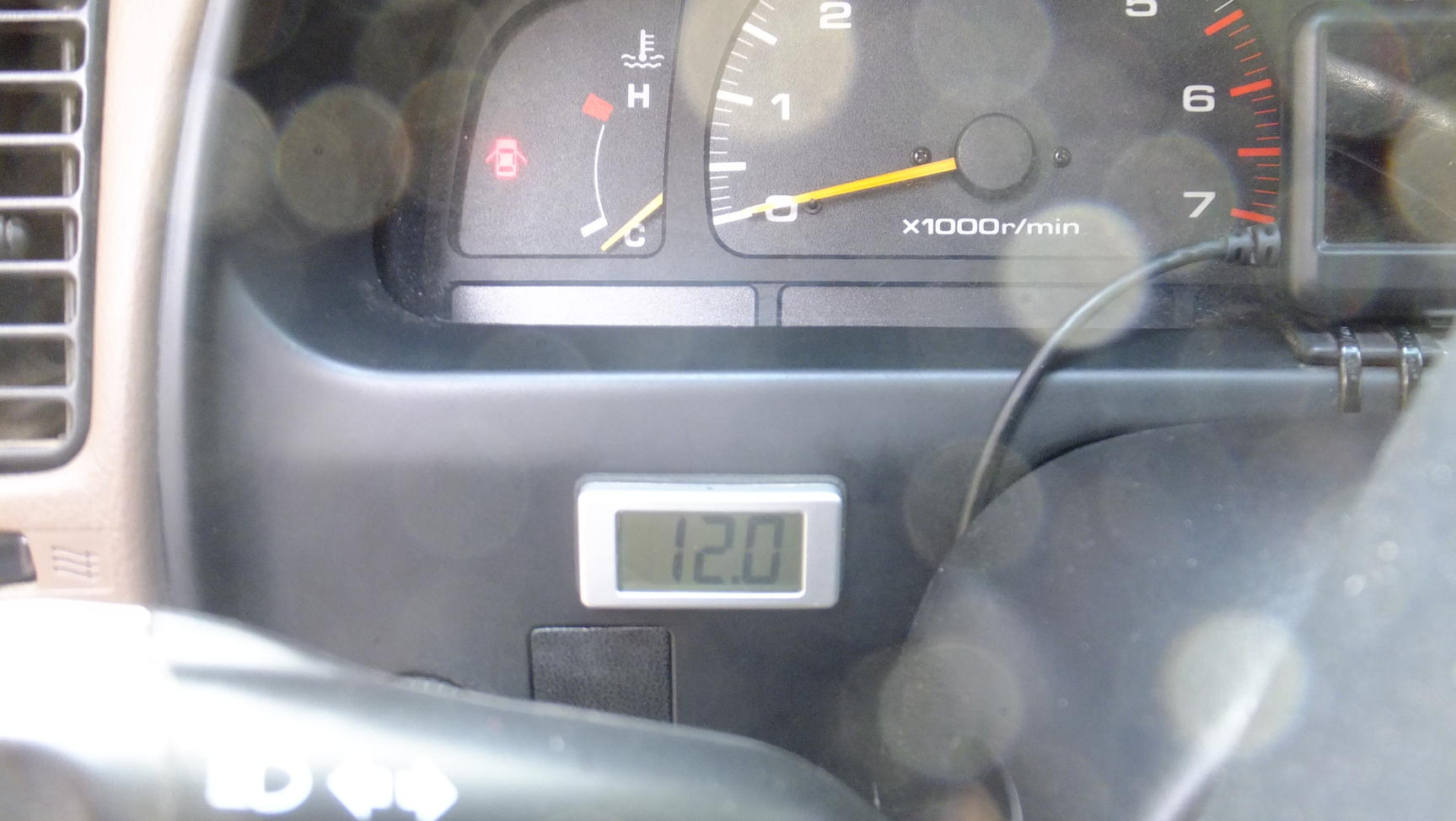

Volt Meter
Relocated my volt meter to a more permanent location with better visability.
It's fuse tapped to the ACCY. fuse so it comes on and displays battery voltage whenever the key is turned to ACCY or IGN. It also has a calibration function so it is calibrated to match battery voltage across the battery terminals. It's nice to be able to check battery voltage just by turning the key.
I know my battery is reading low. Sorry about the big photo.

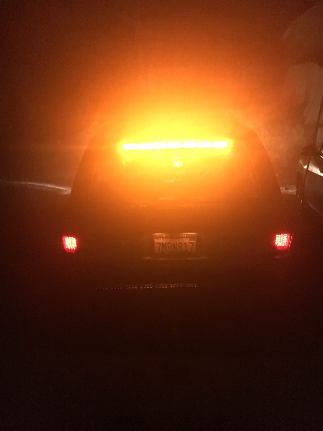

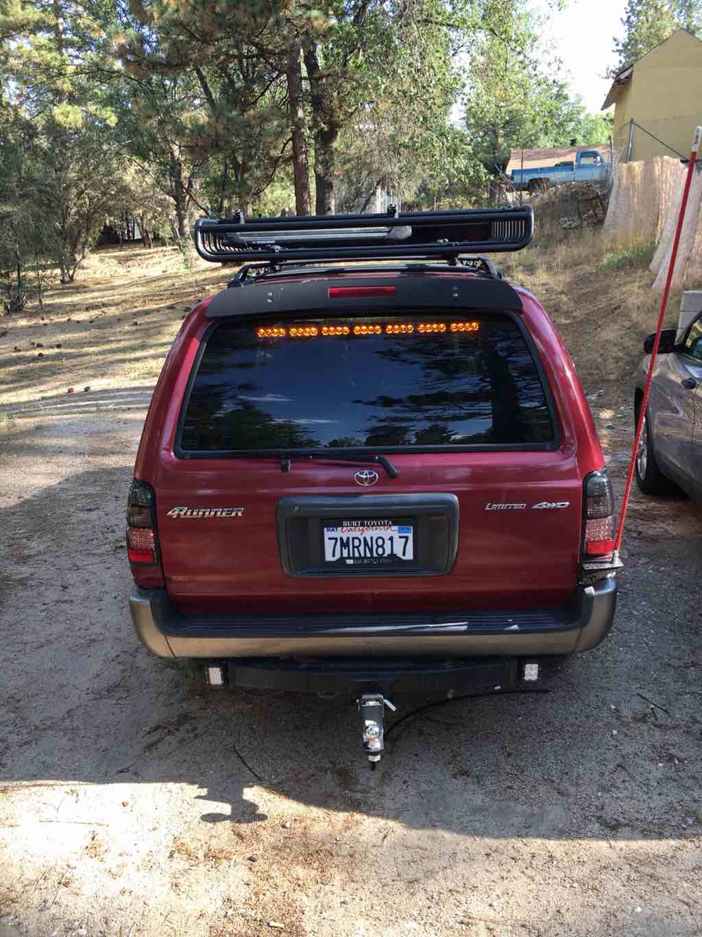

Wasn’t done today. But I added this rear guide light bar. Super simple to install and works great! Has like 12 different modes.

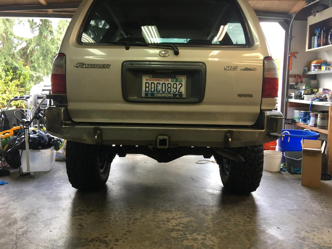

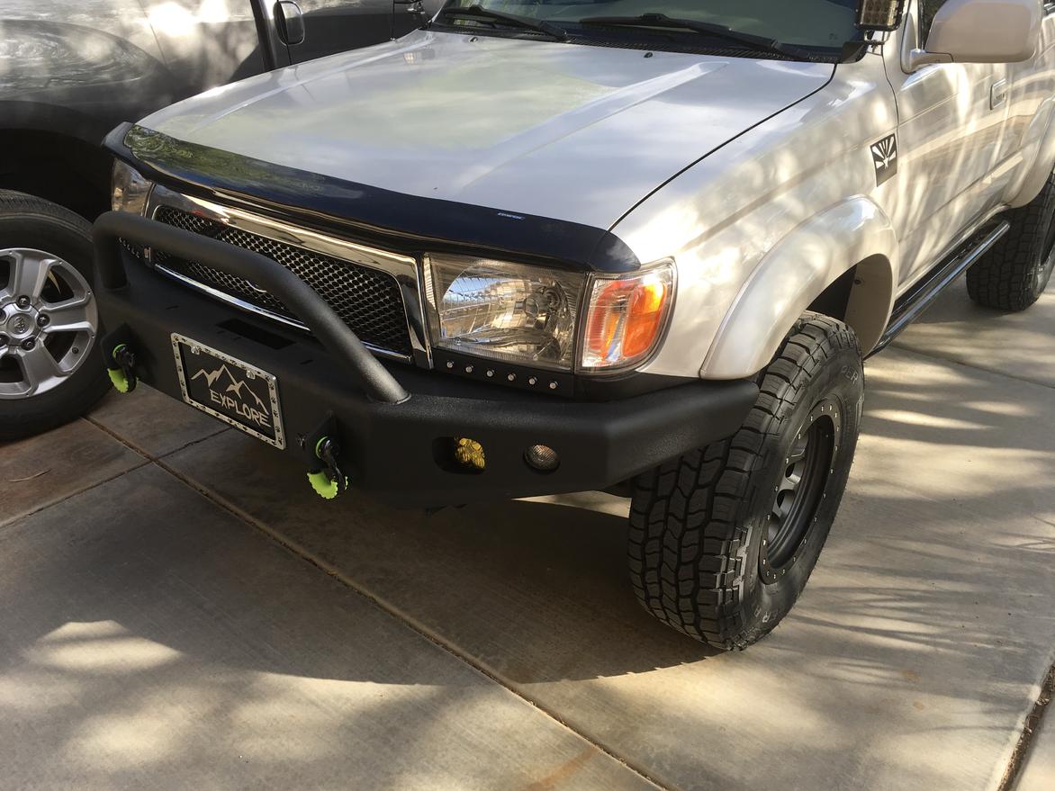

Test fit the 4xinnovations rear bumper before paint.
