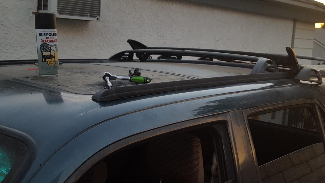

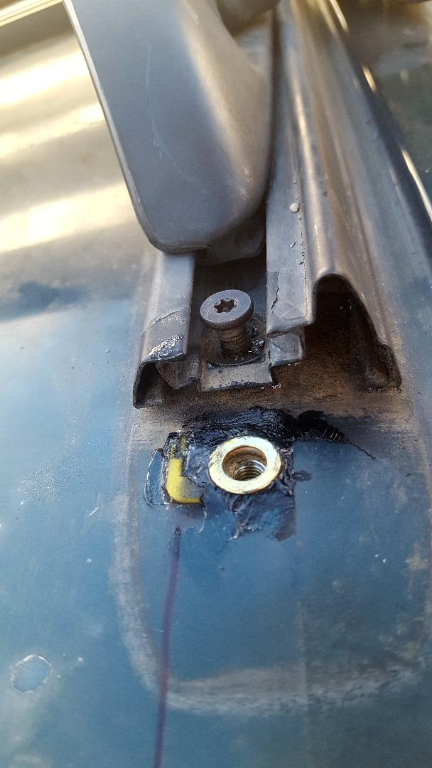

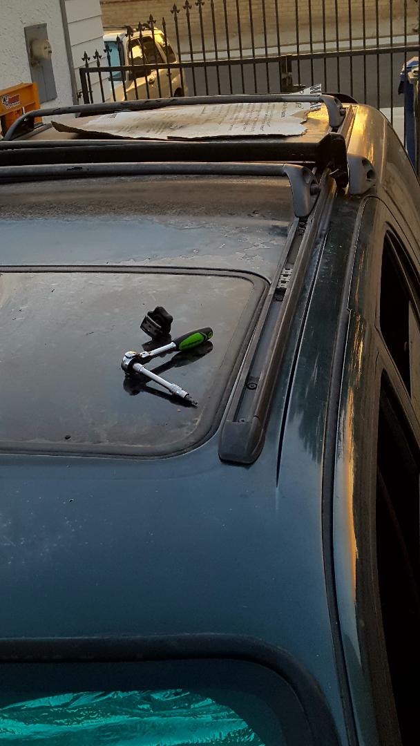

I extended my stock roof rack by adding a little more than half of one I got from the junk yard and cut down. This way it will have much better support up by the windshield for the kayak. It's just barely is wide enough to straddle the sunroof. Some carefully placed M6 rivnuts, being sure not to hit the sunroof hardware underneath. I extended it as far as I could go to where the roof starts to contour down. It's my 1st experience using rivnuts/nutserts and I think it was well worth the $58 for the set of 10 sizes(5 metric/5 SAE). It's basically a pop rivet with threads inside.
You are a far braver person than me, but it looks really good! The factory are really short for kayaks and canoes.

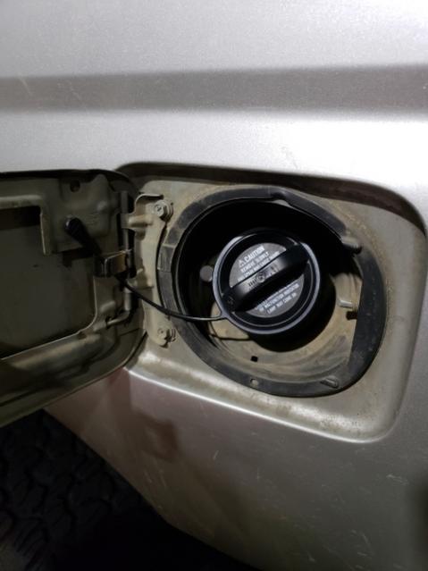

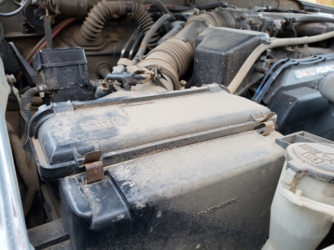

The last trail ride did my air filter in. I ended up with my engine throwing a CEL. My air filter looked ridiculous as well as the mass airflow sensor. The sensor was completely dusted on one side like it was powder coated. I cleaned the sensor up and installed a new air filter. That should take care of the CEL. Oh, and I changed out the gas cap because I had a brand new one laying around that I never installed.

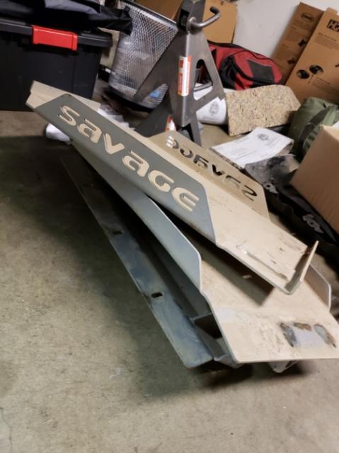

I'm going to drop my rig off at the shop tomorrow to get 4.88 gears and a rear ARB Locker installed. I figured I would take the. Savage skids off and be nice to the diff shop. That and they could use some touching up. I figured I could knock that out while I'm waiting for my rig to get sorted out for a few days.
you have anymore photos of this and the insert kit? very nice mod.

Also interested in more details especially how you connected the two rails. Looks OEM to me!
Make sure you get one with steel rivets. Mine is very similar to this one, the kit came with 10 rivets in each thread size.
I just butted the two ends together, I might put a little black silicone to fill the seam but it doesn't bother me how it looks right now.......yet. LOL
