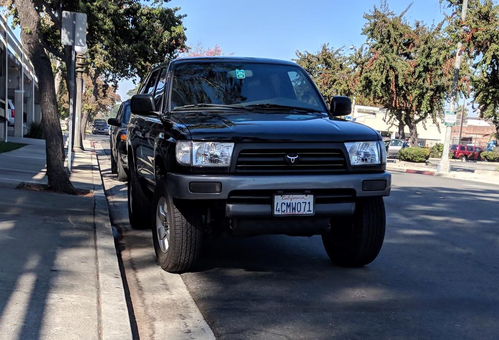

Also finally got rid of some plastidip; it feels good to go back to factory paint.

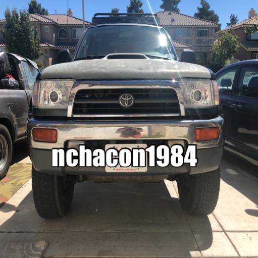

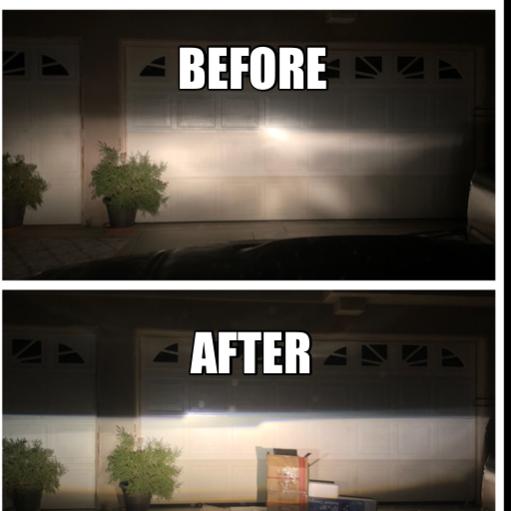

duuuuude i owe you a beer!!! Finally someone who actually quit blinding people and fixed their crap/led/hid/conversion headlights. Where do i send it!!!!!!!
Thanks. I had the regular halogen lights, never cared for led/hid conversion. Do it right the first time so I saved enough to have a pair made. About the beer, I’m always in the mood for a good brew and good company. :biggrin2:

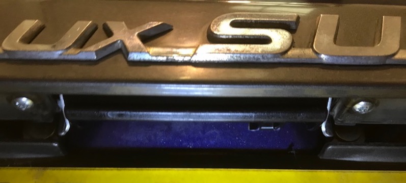

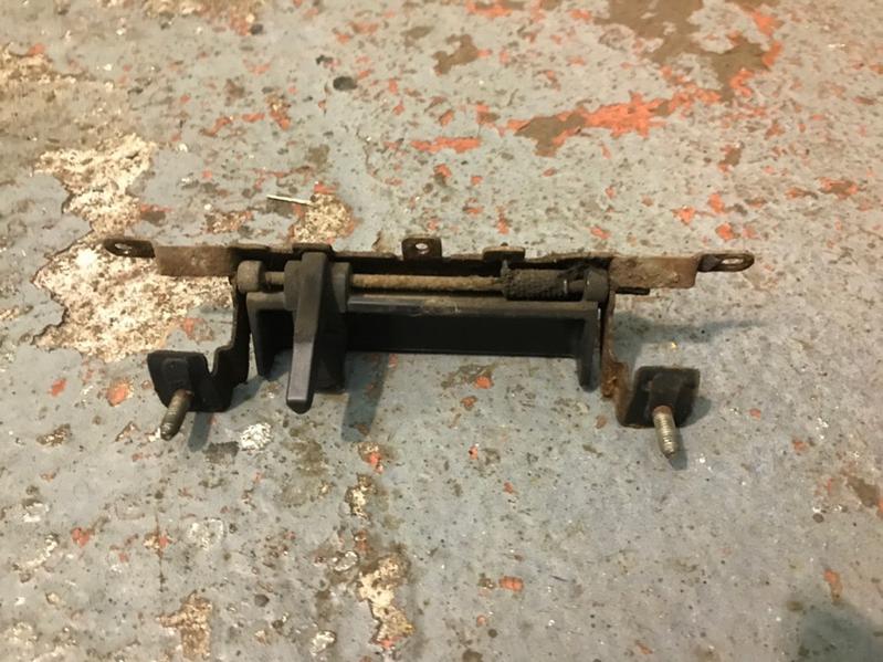

The tailgate handle on my 3rd Gen had always been a bit stiff to operate, but it got to the stage where the built-in spring was too weak to return the handle back to its normal position. You had to manually push it back after opening, otherwise the tailgate wouldn't click shut. I opened up the tailgate a few weeks back and discovered it was the handle itself - everything else was moving freely.

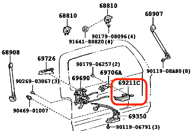

I took a guess and ordered the part (69023-35010) from Amayama. The illustration that Toyota have in the parts book isn't that clear!
Fortunately, the part that arrived looked correct.

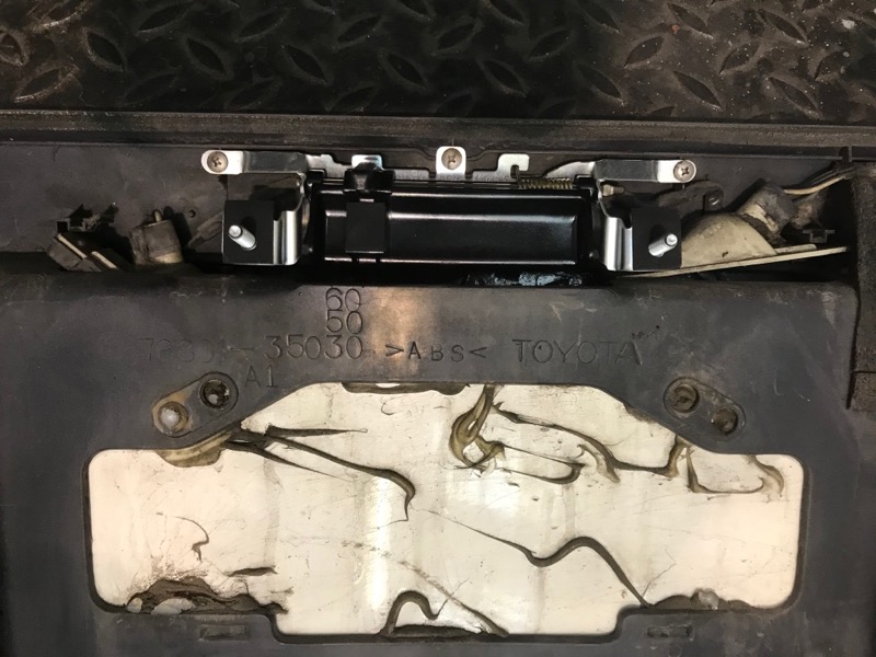

Fitting it is a bit awkward, as the handle is fixed both to the tailgate and to the licence plate surround. Here's the new handle fitted to the surround. The two M6 studs are fixed through the tailgate.
Here's the rusty original:
While I'd got the licence plate surround off, I gave the area behind as well as the inside of the tailgate a coat of Bilt-Hamber UC wax. It sprays on nicely and doesn't stink the car out for days after!
All back together and working nicely.

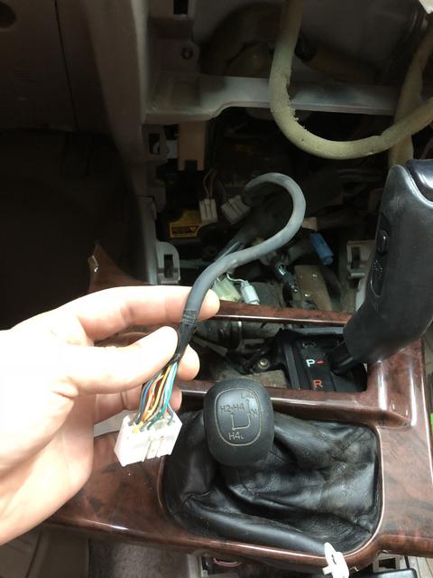

Can anyone identify where this wire harness plugs in? It comes out from Under the factory amplifier, I have a 2000 limited.

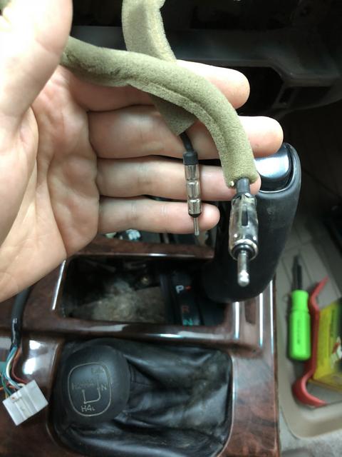

Also where does the smaller plug go below, I know the bigger one is the antenna.. I’m removing the PO’s radio and both of these were unplugged..

In the first photo, my guess is either the main harness for the factory radio or the factory amp.
In the second photo, the smaller one is the jack for the diversity antenna that’s embedded in the rear passenger side quarter glass. You’ll need a Metra splitter (or equivalent) of you want to run it to an aftermarket head unit. The factory radio has hookups for both, aftermarket radios only accept the larger one for your front passenger fender antenna.

So the question is, has anyone used the Metra splitter for both on an aftermarket deck? And does that 2nd antenna really help at all or is it gimmicky?

Most people say it’s not noticeable but I have no experience personally. I bought a splitter years ago when I put a Kenwood head unit in my old ‘96 thinking I’d need one during the install, but it didn’t even have the diversity antenna in the quarter glass! In my 2000, I left it unhooked because I don’t listen to the radio and opted for a manual micro rocker switch to allow my antenna to only raise when I want (which is probably less than 5x a year lol). At least I don’t have to worry about it when wheeling or automatic car washes!
