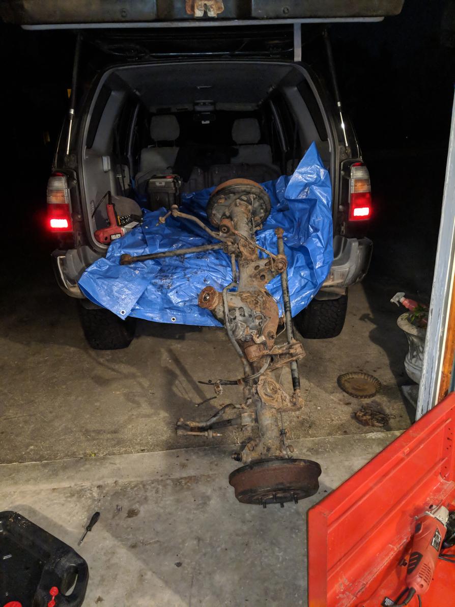

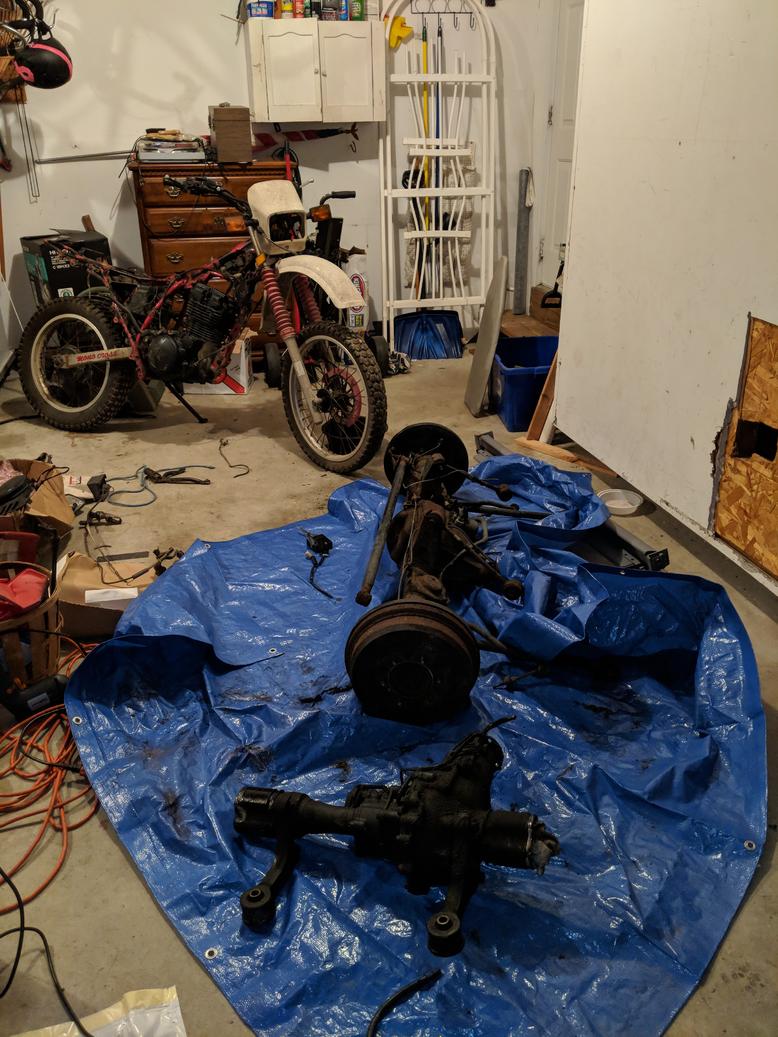

Bought an e-locker thingy. Sure is heavy when you're by yourself lol

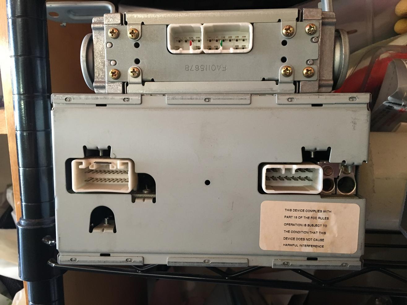

The factory amp and the factory double din CD player each have 2 white connectors that plug into them. The one in your photo goes to the radio and I believe it’s the one that plugs in next to the antenna jacks and is a 12 pin, and the one on the other side of the radio is a 20 pin. Not sure what wires in each harness are for though. Hope the photo below helps.

Very helpful thank you so much! Very odd as the aftermarket harness I got for my head unit only uses the wire harness from the amp.. hopefully it works lol.

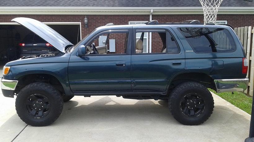

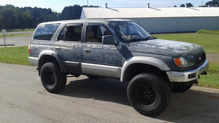

Getting my 97 Limited ready for Raptor liner
Finally got around to getting the flares back on. Put some ProComp 7069 wheels and Falken Wildpeak tires on it. Trying to get this thing sprayed in the next couple of weeks.
