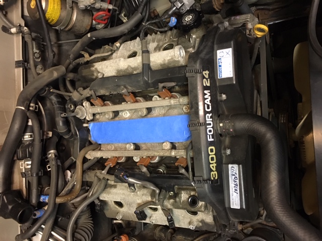

Valve cover gaskets

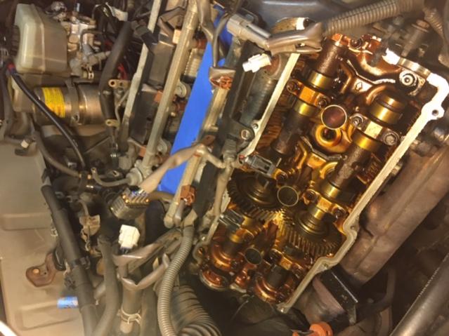

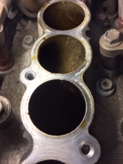

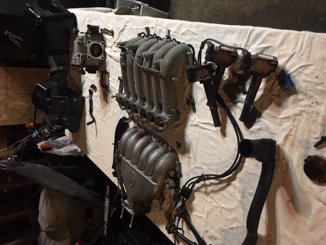

Successfully replaced both valve cover gaskets with help from posts on this forum by [MENTION=120071]mtbtim[/MENTION], [MENTION=102606]infamousRNR[/MENTION] and [MENTION=122940]ramonortiz55[/MENTION]:clap2:
Everything looked good except some deposits in the third intake from the firewall. All the others looked nice and clean. Anybody know what would cause this or if I should be concerned? photo below
Looks good and clean. And no, zero concerns.
I agree with Leon, zero concern, the deposits in the intake plenums are normal. Eventually you will need to clean or replace your IAC and PCV - those are the common sources of oil in the intake.
Don't forget to retorque the valve cover bolts after the first 500-1K miles, and every year or so; the rubber under the VC washers harden over time. Also recheck torque on the throttle body bolts/nuts or you will weep oil from the TB/intake seam eventually.
Looks clean, good job :thumb:
Thanks man. I did replace the PCV and grommet when I did the vc gaskets. And thanks for the tip on re-torqueing the bolts! I'll definitely be doing that. A couple of the vc bolts were so lose when I went to take them off I could have turned them with my fingers.

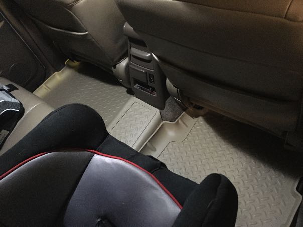

- Installed some rear Husky Liners due to children...
