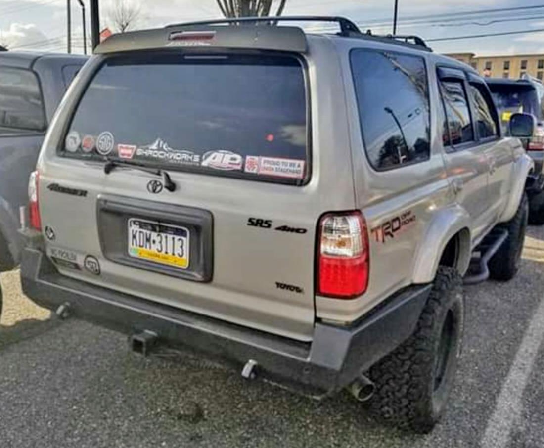

Just bought yesterday... took a lot stickers off back window

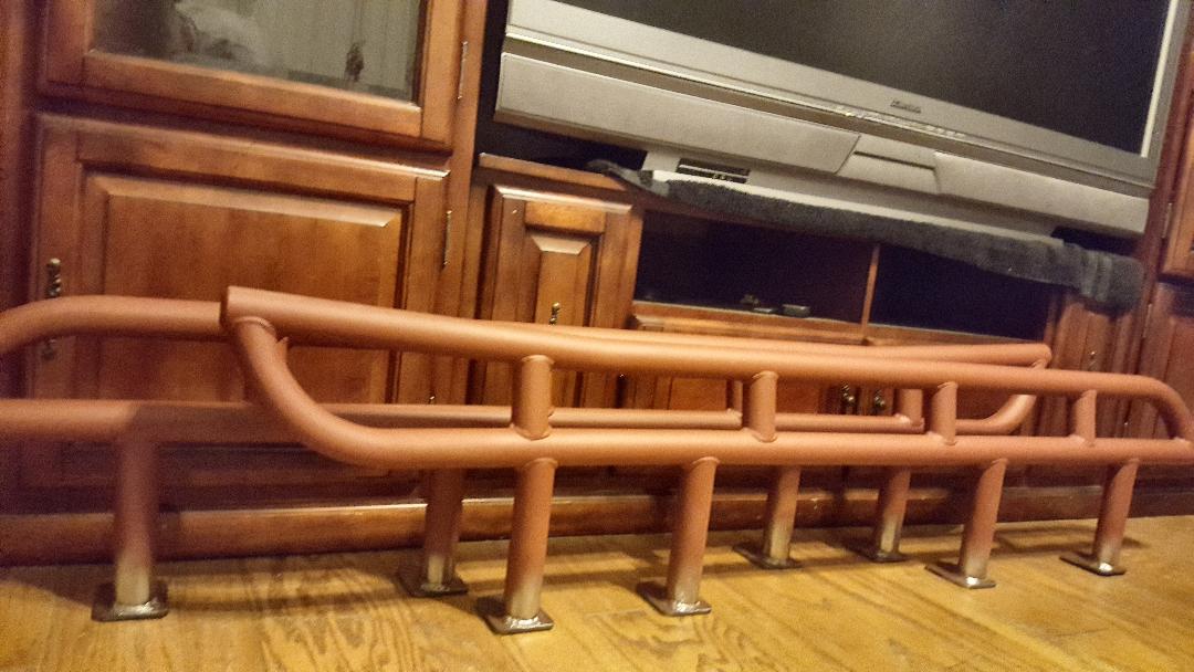

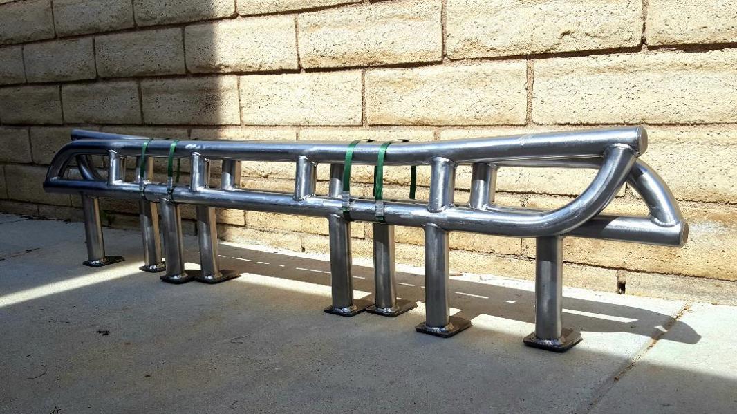

Mr. Brown delivered sliders from Mr. Stubbs which promptly got a coat of red oxide. My new babies are sleeping inside tonight

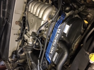

spark plug wires
replaced spark plug wires with new NGK wires. Now dealing with rusted license plate light cover screws... PITA. Got one out!
