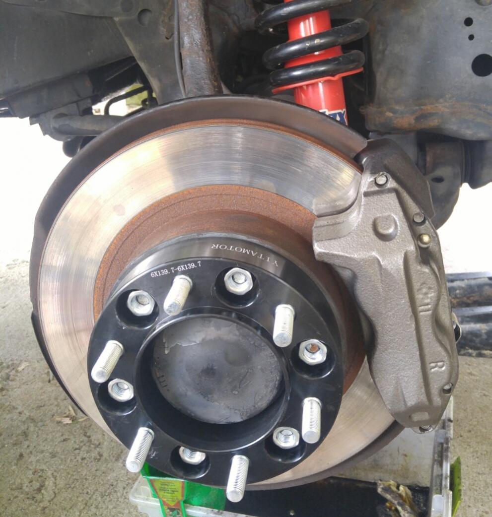

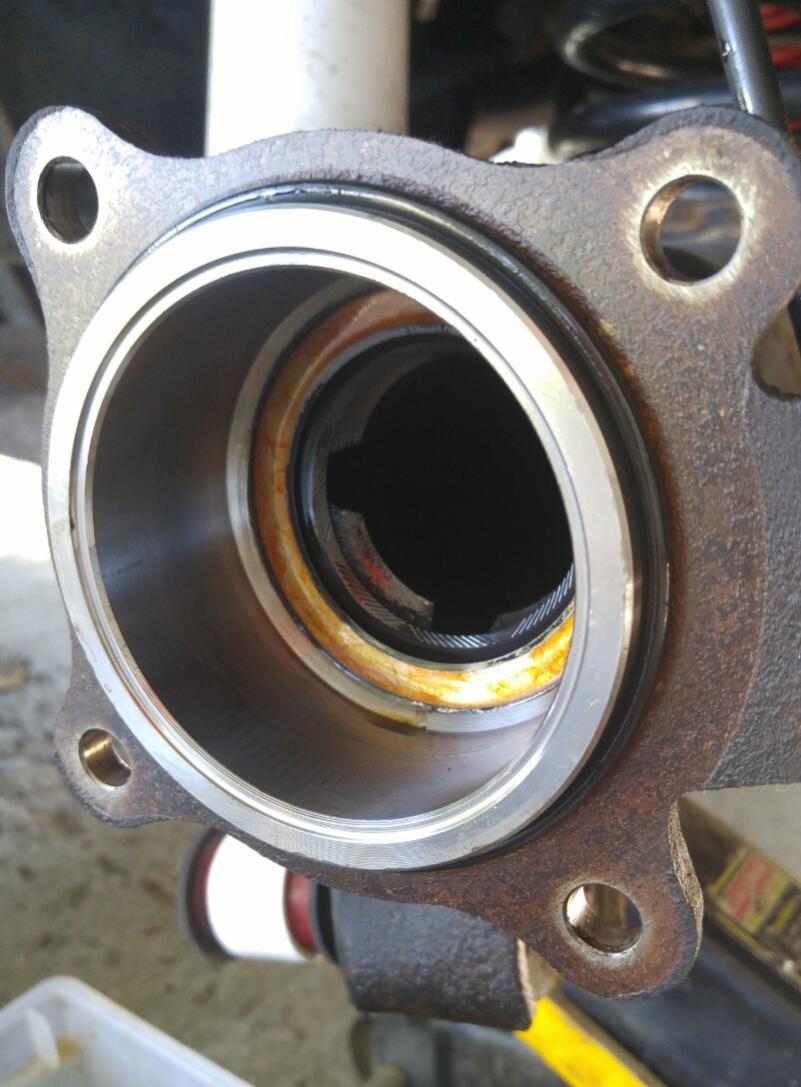

Axle seal, brakes, wheel spacers
Replaced rear driver's side axle seal. Was actually a pretty easy job. Hardest part was removing the old seal. FYI, the brake parts do not need to be removed to do this.
Replaced front brake pads, and surprise! A piston was locked in the passenger side caliper. So it was replaced too.
Installed a set of yitamotor 1.5" wheel spacers. Love the look and only $50 on fleabay. I can see why some think you need extended nuts on the front, but I was still able to get 8 or 9 full turns. Good enough for now I hope.

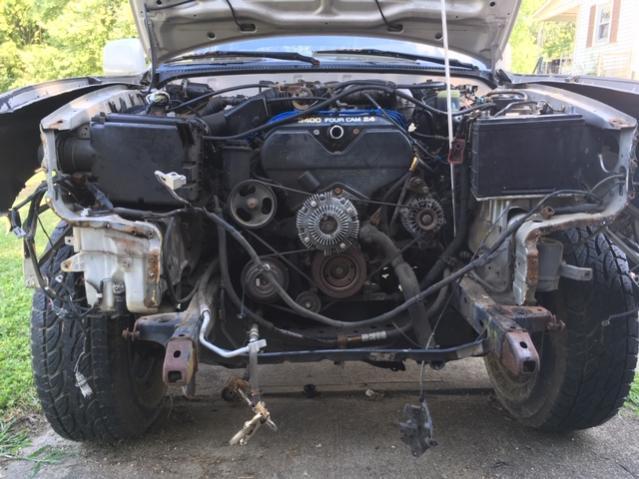

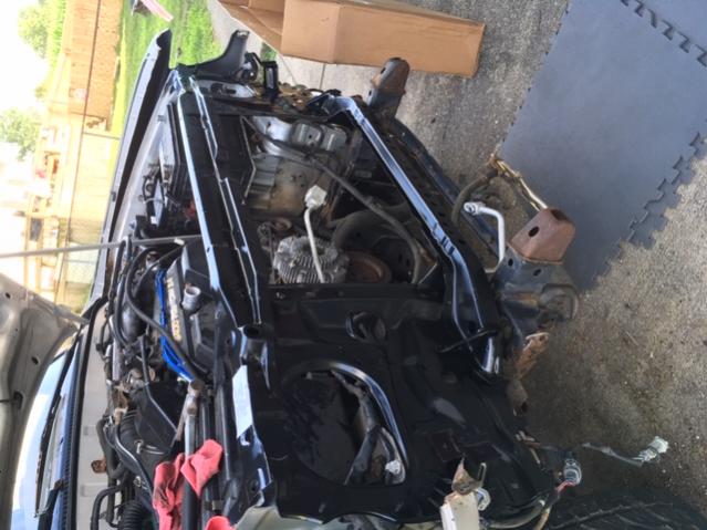

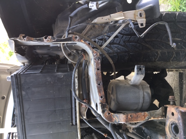

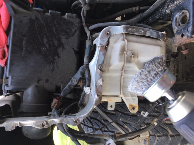

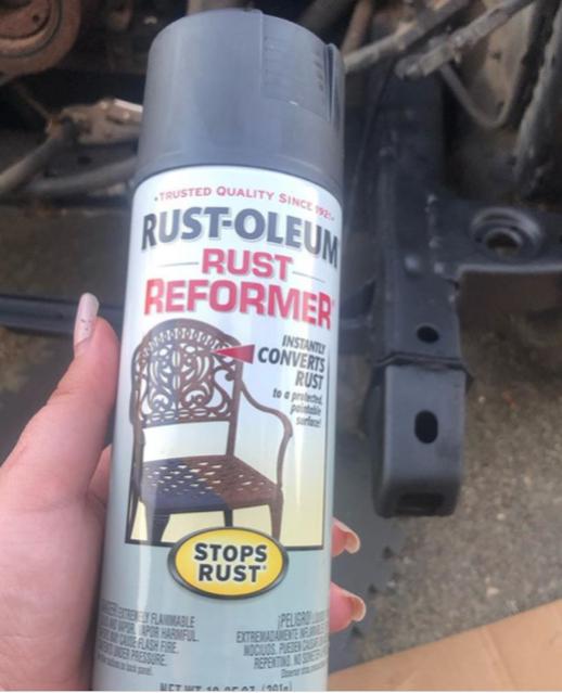

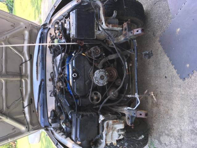

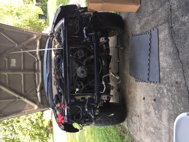

Radiator Support is out!
I finally got the old radiator support out. I used a wire wheel and cleaned up the rust, and sprayed some rustoleum for prevention. Also replaced all the drive belts having the best access to everything rt now. One step closer!!
