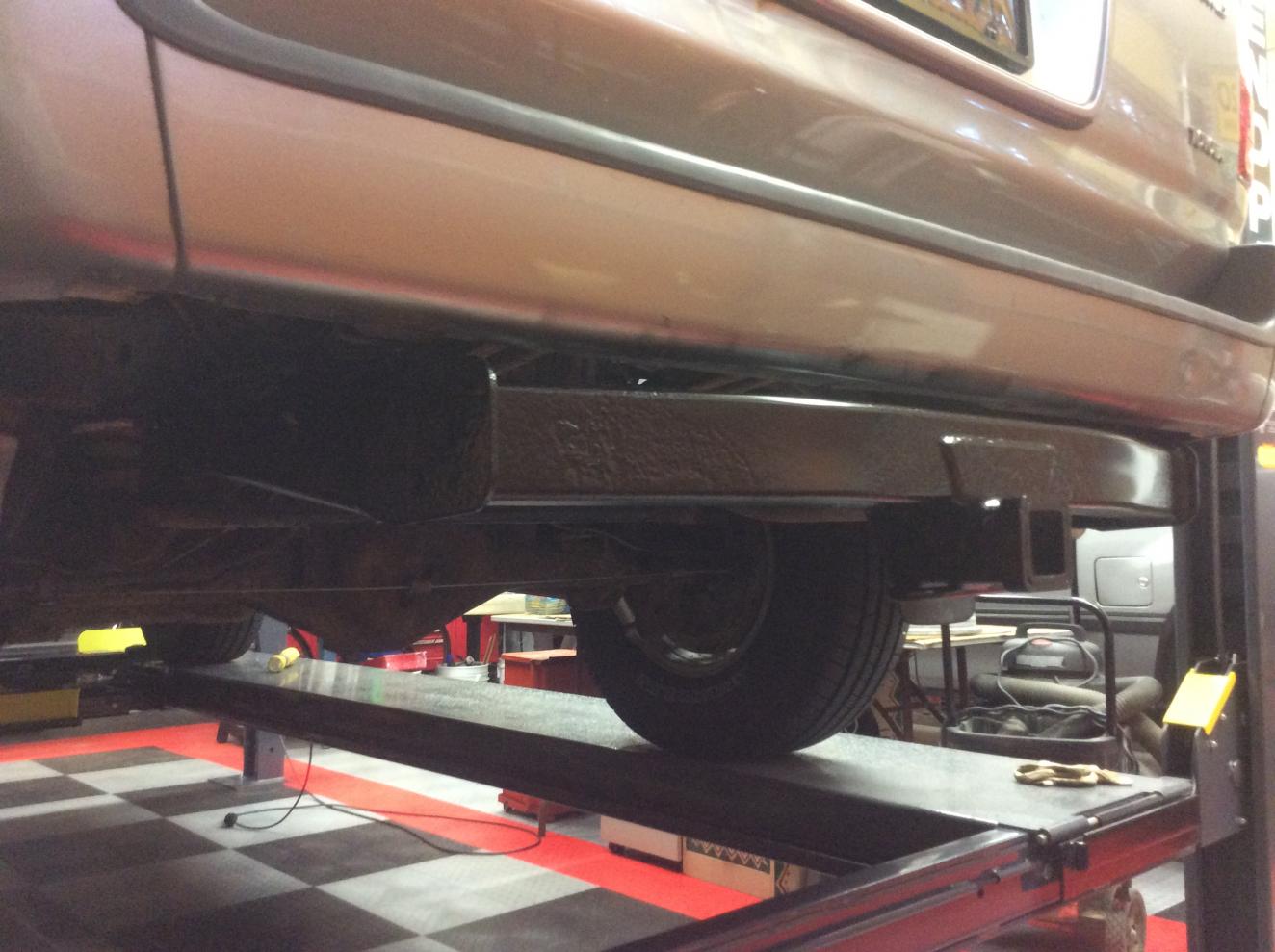

Got tired of looking at the rusty factory tow hitch on my new to me 02 SR5 Sport so I busted out the Makita angle grinder with wire wheel and went to town.
Is it perfect, no way but looks way better than before!
