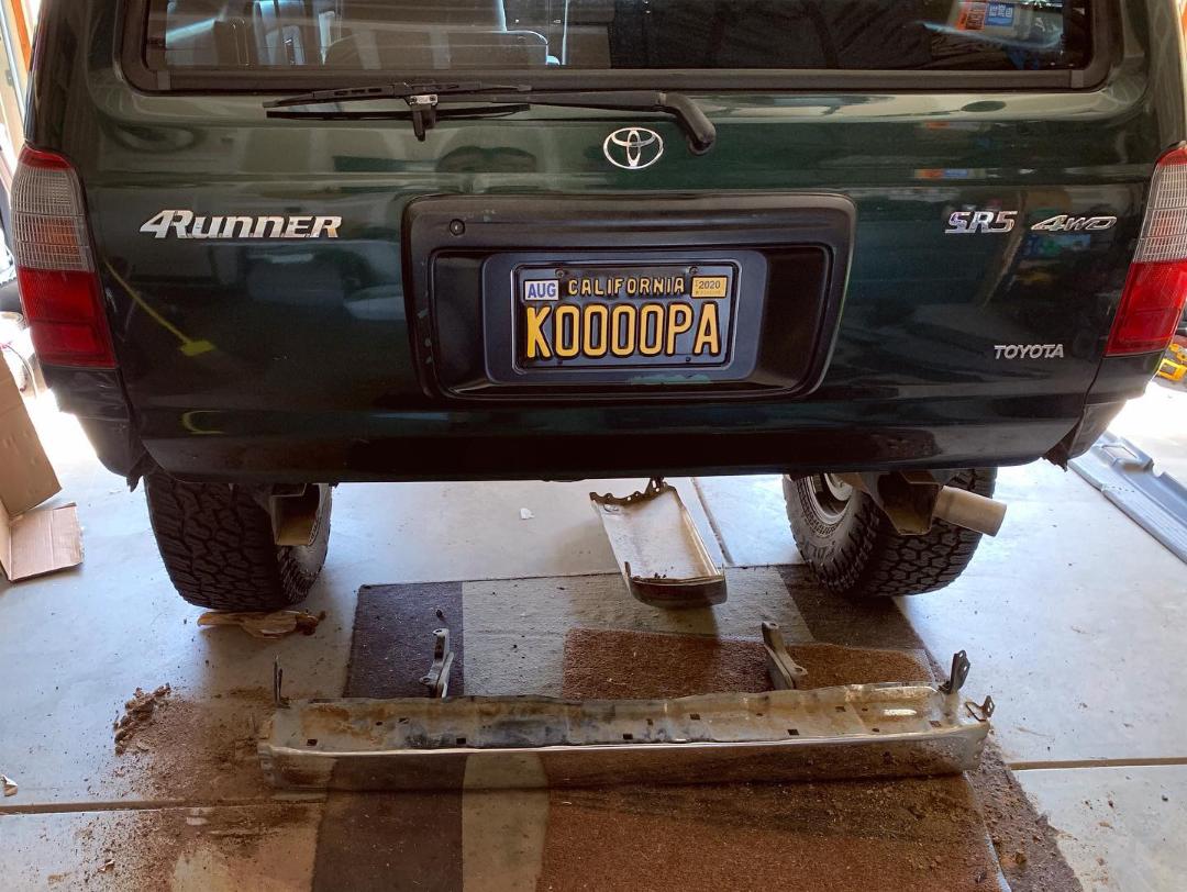

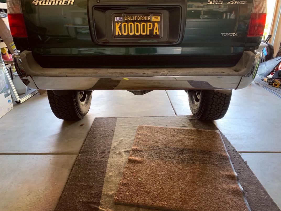

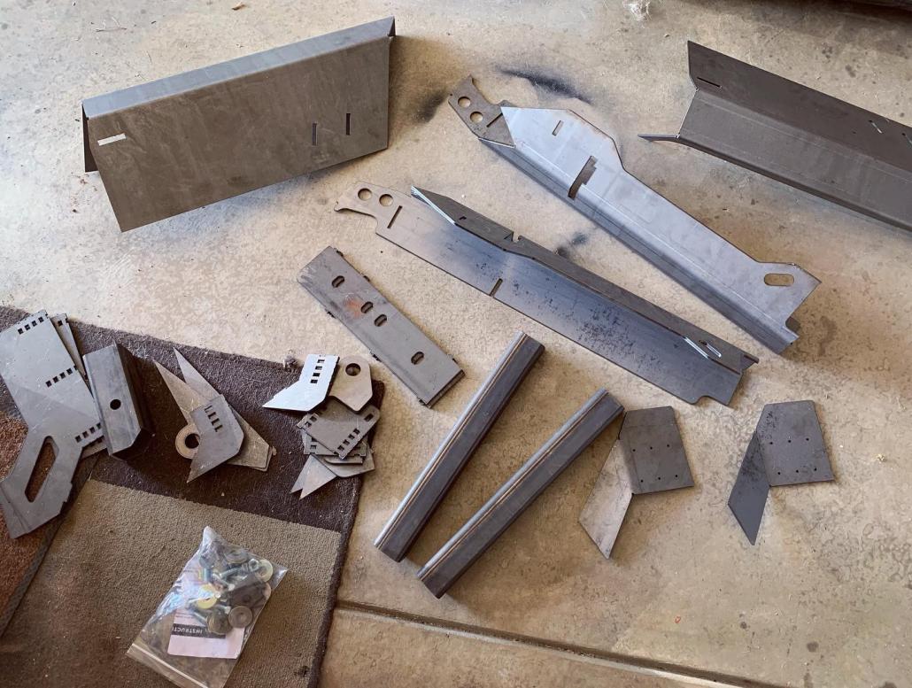

Removed rear bumper to prepare for True North Fabrications rear plate kit. Even for a California rig, three bolts snapped due to rust.

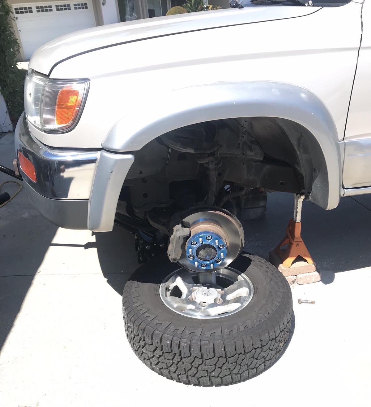

5100s in front today, rears were done a few weeks ago. 1:1 swap with 10+ y/o 4600s. Likely will swap out springs eventually when armor comes, or go Tundra 5100s if I can find springs.

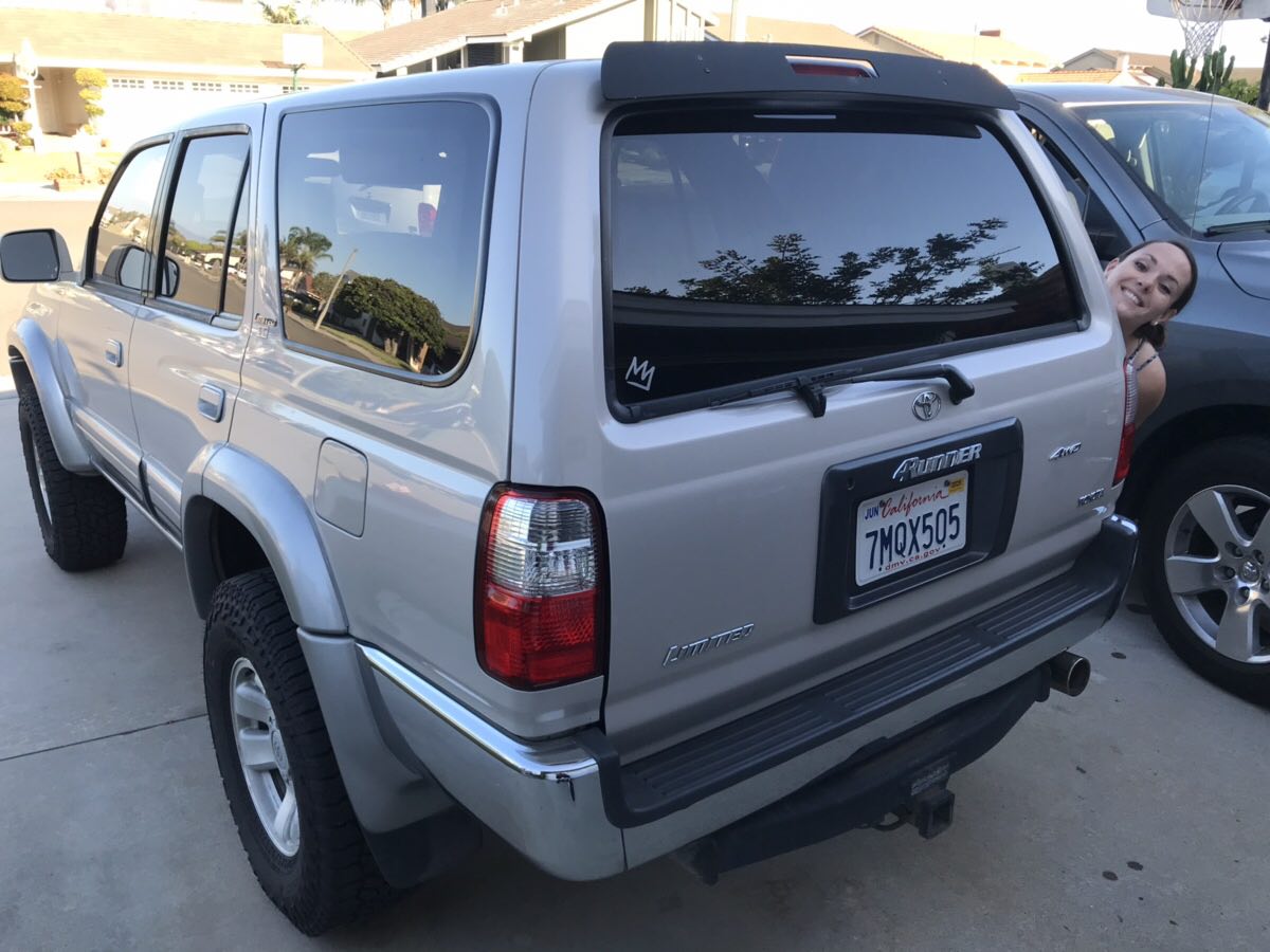

Also installed 99-02 headlights and 01-02 tails that I picked up from the junkyard last week

For the tails did you have to swap harnesses as well?
I'm not the OP, but having done this taillight swap, your best bet is to also use the '01-02 harnesses, which terminate just inside the rear side trim pieces, so you'll have to pull the trim off a bit to get to the connectors. Otherwise you'll have to splice your '96-00 harness because the bulbs are different.
Such a simple upgrade that improves it greatly.
Like [MENTION=198376]4Runner4Leon[/MENTION] said, it's so much easier to get the pigtails along with the lights themselves. You just have to get behind the trim panels and unplug it/undo the one ground and you don't have to splice in any different bulb holders. I got my set from a guy parting out a truck and he was nice enough to include those harnesses as well.

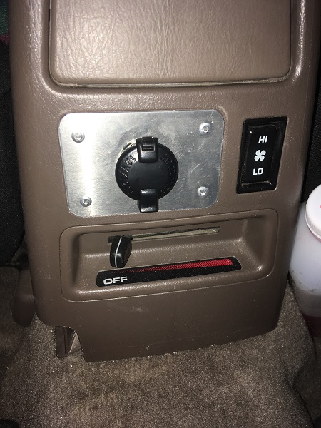

Rear cigg. lighter plug. Full time powered from my little blue seas panel under the glove box.
A little industrial looking but solid. There is a slightly larger aluminum plate on the inside and the rivets pull them together pinching the plastic tightly. Outlet is a toyota one I scored out of something at some time, had it in the parts bin.
Will come in handy for listening to podcasts while sleeping in the back or charging the laptop.
