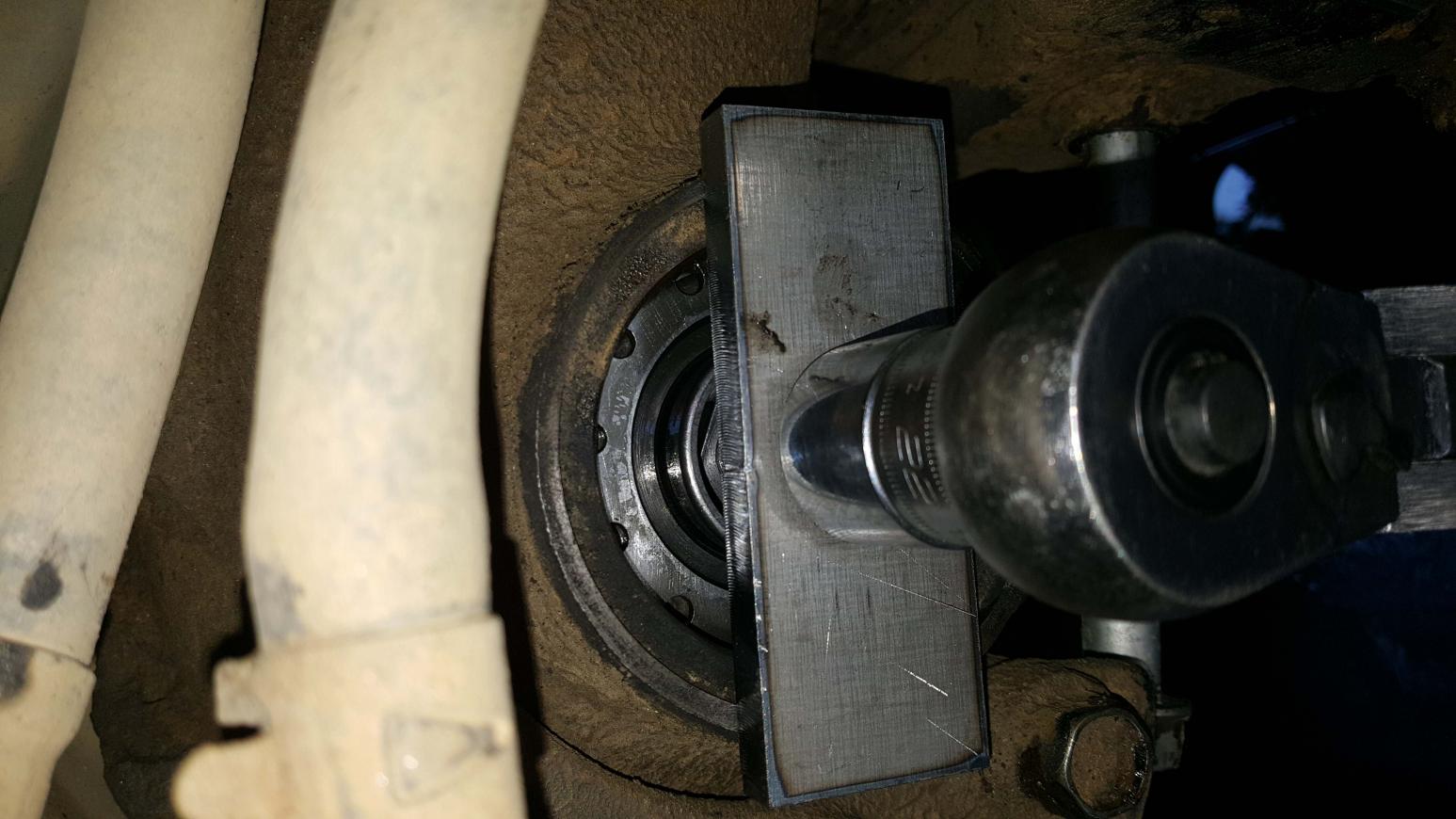

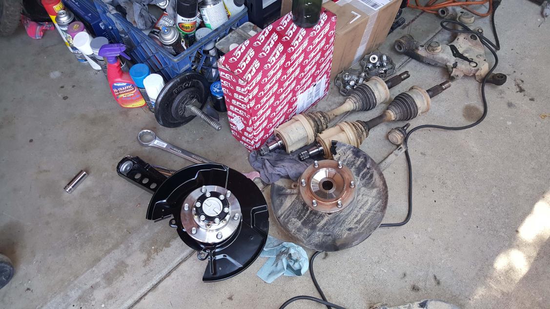

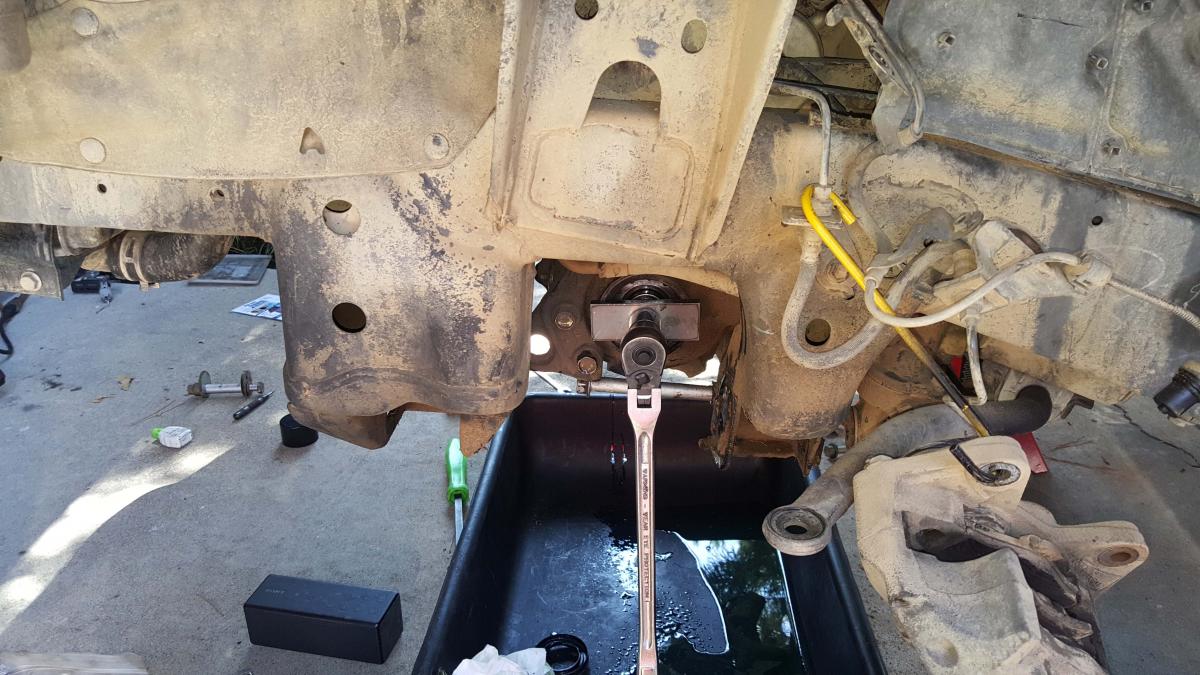

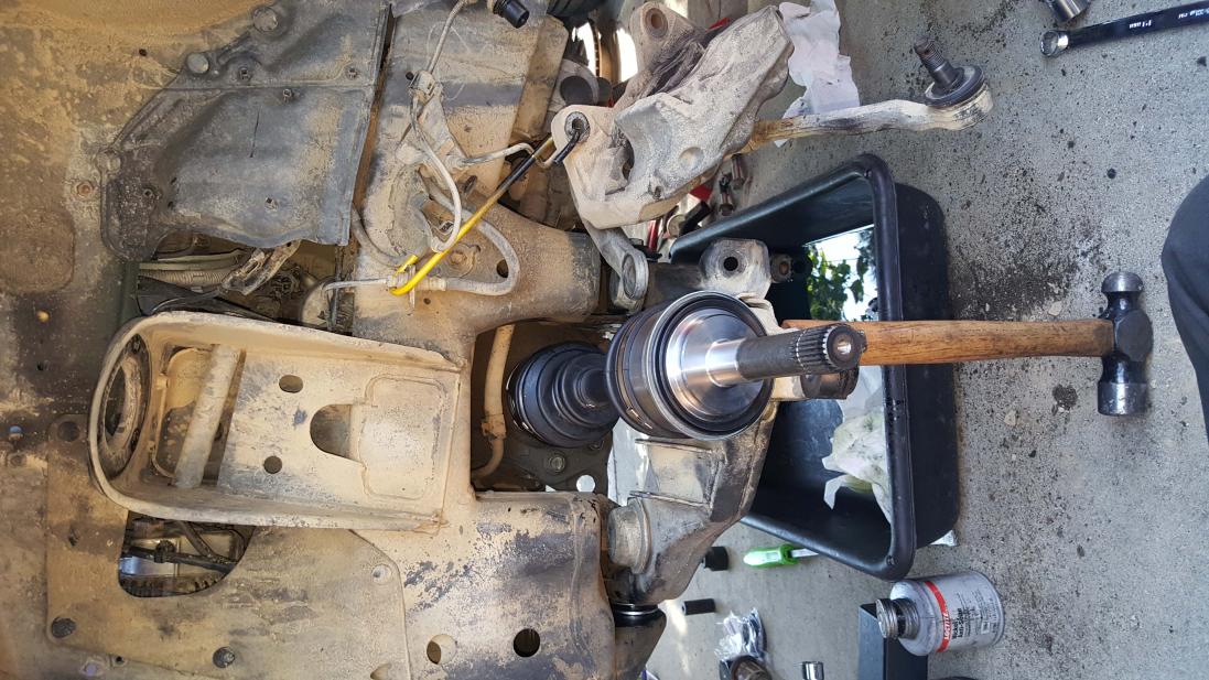

Started the front end refresh and manual hub swap. Got everything torn down and the drivers side reinstalled. Have to turn the spc ball joint 180 as I have it in wrong (I was a bit tired and rushing). But So far I have done the following:
Spc upper arms
Whiteline poly lowers
ECGS clamshell bushing
Cv seals
New manual hub cv's
Wheel bearings/seals/hub
Manual hubs
Poly rack bushings
Inner and outer tie rod ends
LBJ's
Will finish up tomorrow. Right now I'm pooped, but looks awesome none the less. Should firm up the front end quite a bit.

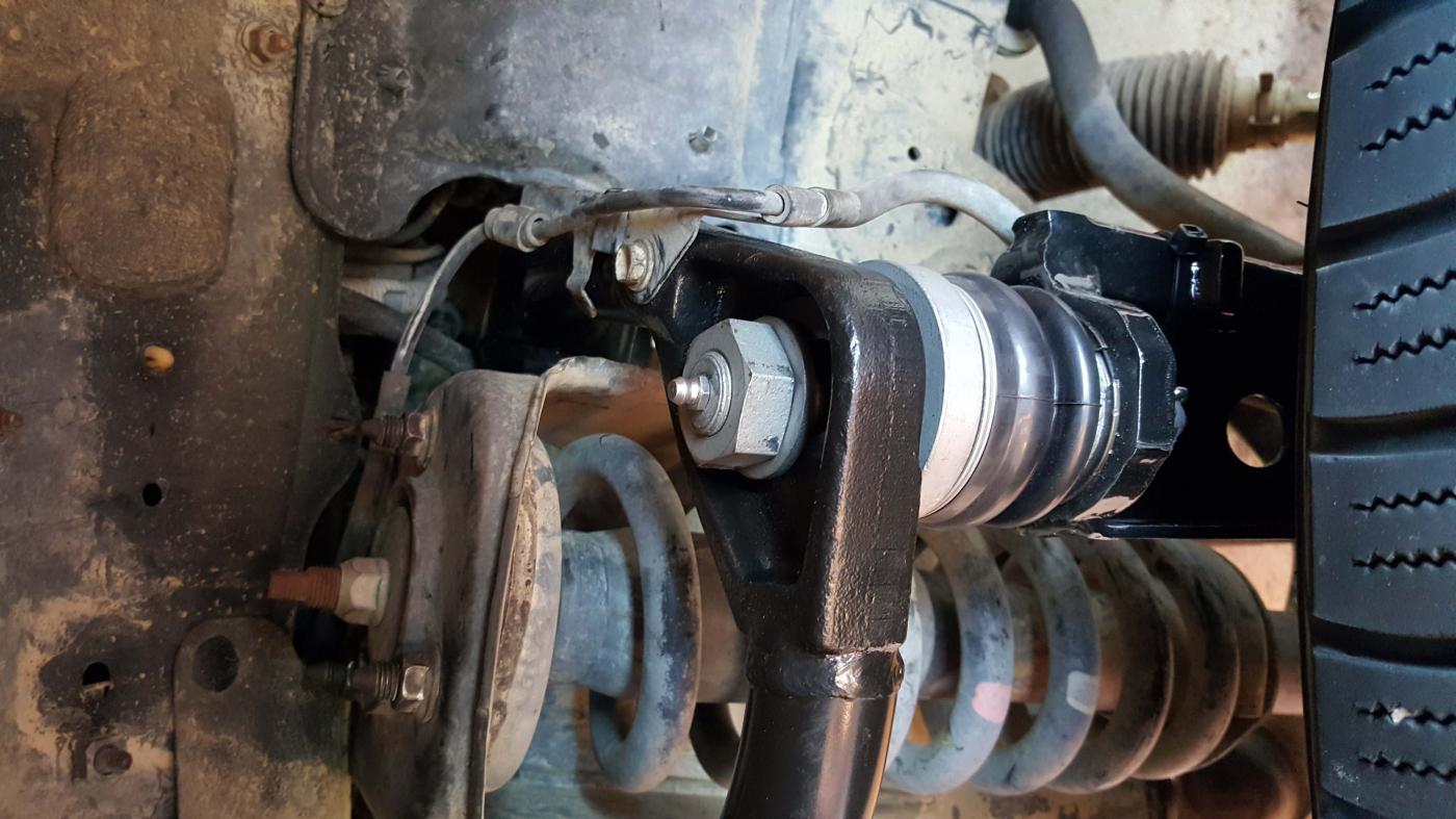

Day 1 of 2 doing a front-end refresh (suspension, bushings, lbj). Decided to work from the top down, so I started off with the upper control arms. Couldn't follow Timmy's method with the bearing splitter as mine is just too chunky at the edges, so I took to the metal lip with a hacksaw (sawzall) and just pushed the buggers out normally...
Replaced with OEM, which went in great. The hardest part was having to be stretch armstrong to reach into the engine bay to move the bolt while holding the UCA from the wheel well while installing.
Then I moved onto setting up and installing the new Bilstein 6112's. Didn't order a new tophat (don't know why), not that it's necessary but it would have Looked nicer and I wouldn't have had to disassemble the OEMs. Be Warned!! This spring compressor ~ https://www.amazon.com/Powerbuilt-648627-Strut-Spring-Compressor/dp/B001OC5QJS ~ which is what Advance Auto loans, does NOT fit the Bilstein 6112 well. I don't know if it's the extra 1/2 inch body difference or what, but it Barely had ahold of the spring. No photos during because it was so sketchy.
Then it was time to get the truck up in the air so I could comfortably sit under it and do the steering rack bushings. These were a Lot easier than I had anticipated. Not sure if it's because I've only been doing control arm bushings, or they were excessively rotten (they were, IMHO), but they about just fell out. Replaced with some Energy Performance units, also did the sway-bars and end links with the same.
This feels a little ghetto, but when the truck is on a lift about 6' in the air, a jack support just isn't going to cut it. It's stable and secure though. Looped the ends around the frame rails:
And that's all in getting ready for tomorrow, where I'm doing the lower control arm bushings, lower ball joints (with new bolts) and getting the truck back on the ground for a final torque of everything.

Finished the manual hub swap and front end refresh. Ended up pushing myself a bit much the 2nd day in the heat we were having and received on hell of a heat rash and got really light headed and dizzy. Greased the ball joints yesterday and today/tomorrow I'll top off the front diff, and torque the lugs. Then time for a test drive yay! Eimkeith's bumper should be here next week so I have to get the 1" bl installed, so I'll start prepping for that today.
So for all that work in the heat, take plenty of breaks and drink plenty of water and know when to call it quits. I was rushing to get it done so I could drive it on Monday and darn near paid the price for it.
