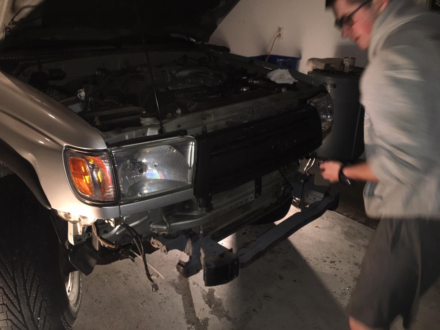

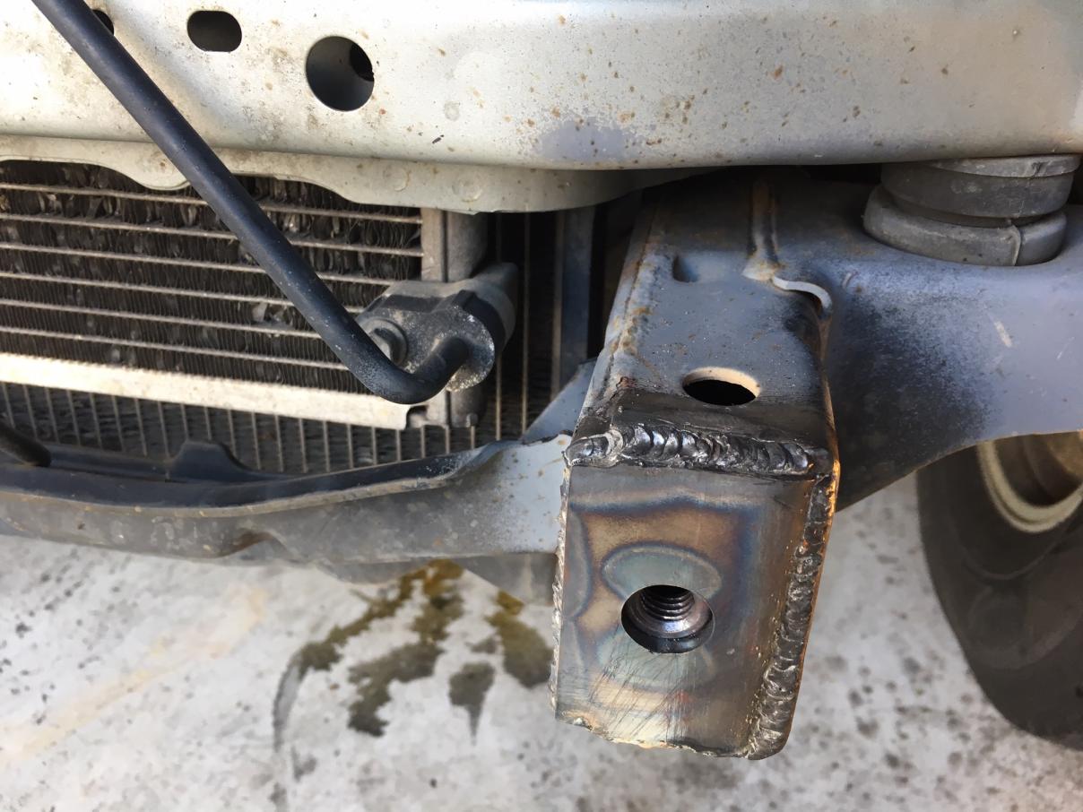

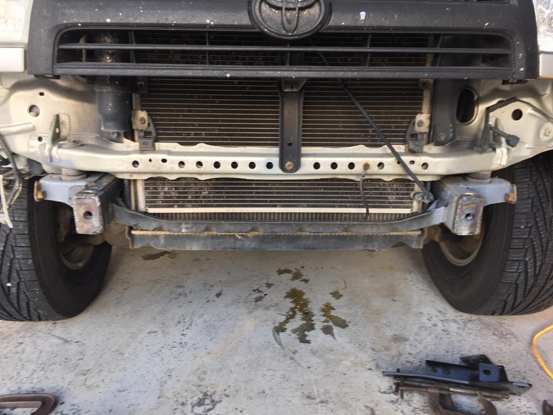

Back on topic, just ordered the hitch receptacle and will pick up the cross bar steel next week or this weekend. Also got the compression fitting and hose barb ends today. Poly body mounts will be here tomorrow and body lift will be installed this weekend. Getting an alignment tomorrow, and with all the front end work, the front rides so much better, minus the oem 19 year old shocks and 11 year old tires. I'll start work on the bumper next weekend yay.
What are you using for the crossbar and hitch receptacle?

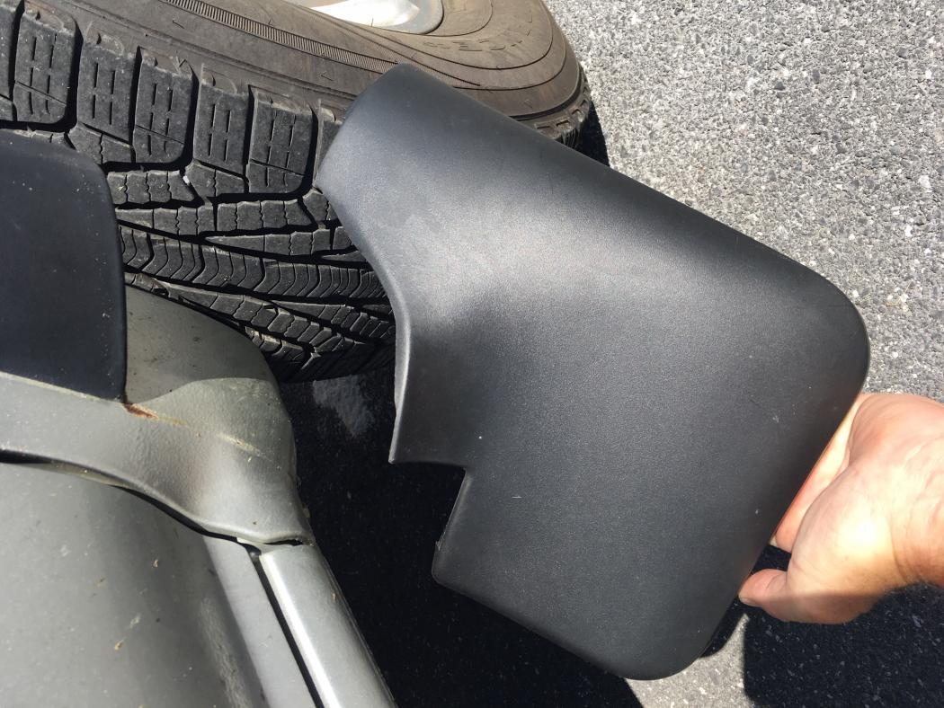

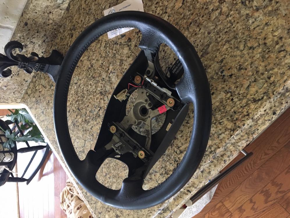

Unicorns and Steering wheel

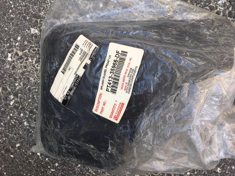

come back from business trip with some nice stuff for daughter's runner sitting on the front porch.....I don't think she appreciates how rare the PT413-35966-DF is.
4th kid now gets to dress up the 5th 3rd get 5spd in our family
Using eimkeiths rear bumper, but bought a etrailer 2" receiver 6" long and .188 2x2 for the cross bar. I got a 5 foot stick of 2x2x.188 and I'll cut it down to size and the leftover I'll make some type of bicycle hitch with the leftovers.
Right in the middle of a alignment now, got the steel this am, decided to get some el chepo rear tires today to get me by for now to give me more time to bump up to 35's and save more money for rims and tires. Was going to do 255/85's but changed my mind. Will be on the lookout for a front 4.30 or any clamshell then send all the diffs to ecgs to get regeared to 5.29's and front arb.
Where the hell did you find one of those new?

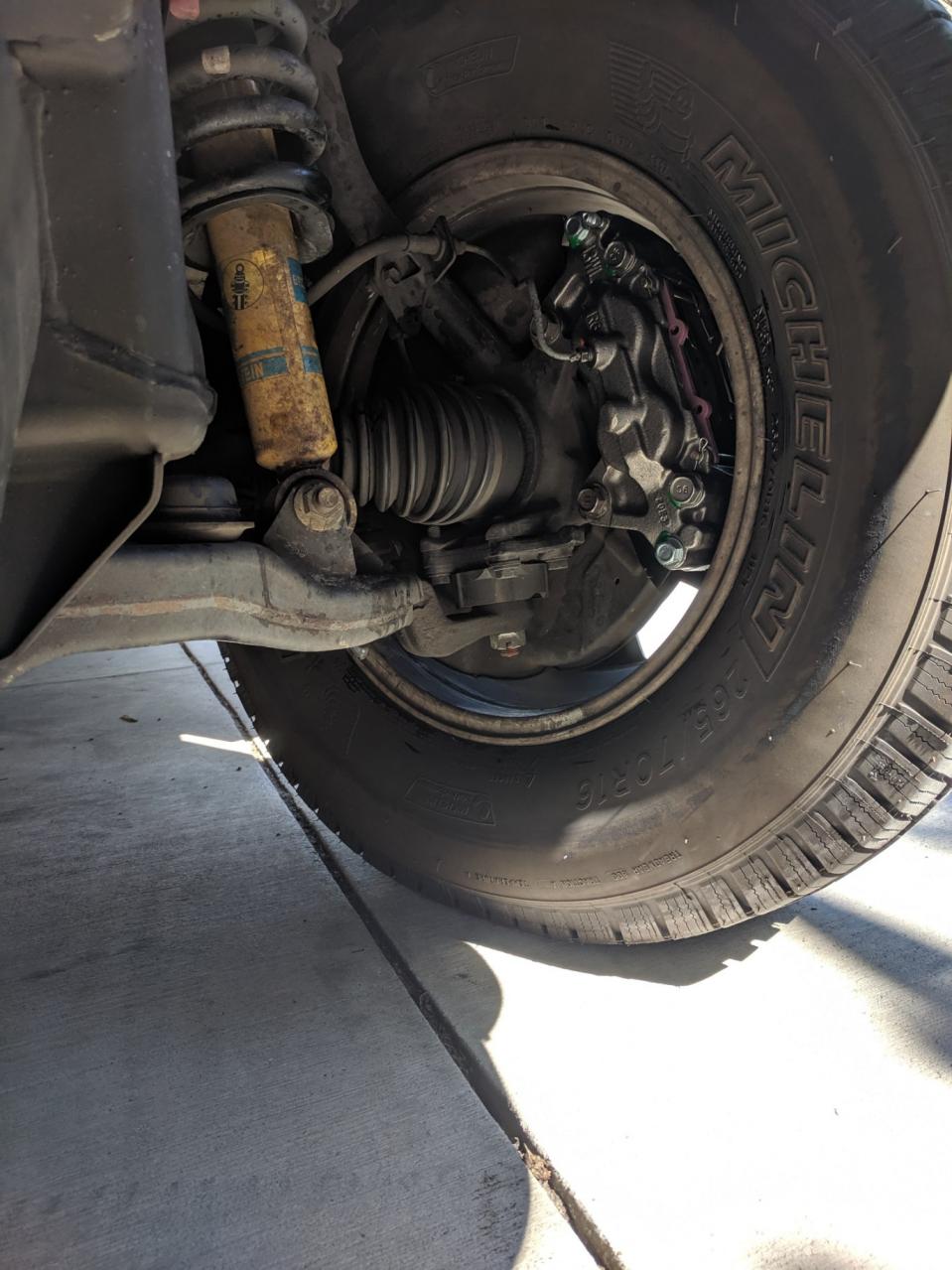

2005 Tundra Break Upgrade

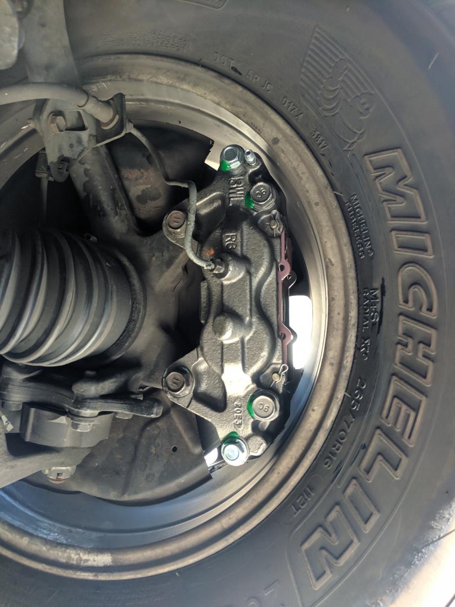

Hi Guys!

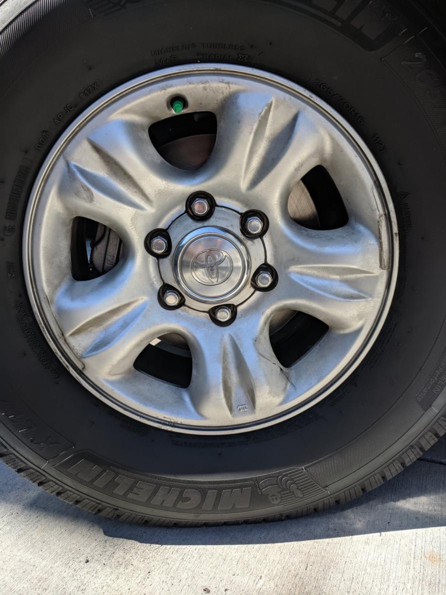

So I finally did the 2005 TBU. I went with the 231mm- 13WL
On stock 16" OEM 4-Runner 5-Spoke "Flower" Wheels, found on '01-02 models. I did zero modifications to the wheels or calipers to make it fit.
I've been driving for about an hour; the breaking feels stronger, controllable, bites immediately, and no more gliding to a stop.
There is a little more peddle travel that will take some getting used to.
I've owed the 4Runner over 10 years and should have definitely done this modification a lot earlier.
Parts Used
231mm-13WL Calipers From Auto Zone- C9951(Driver) C9950(Passenger) 89.99x2
OEM Rotors- 43512-0C011 2x$64.37
OEM Brake Pads- 04465-35290 $63.75
Thanks to the 4Runner community for the help, information, guidance, and part numbers. Hope my post helps someone!

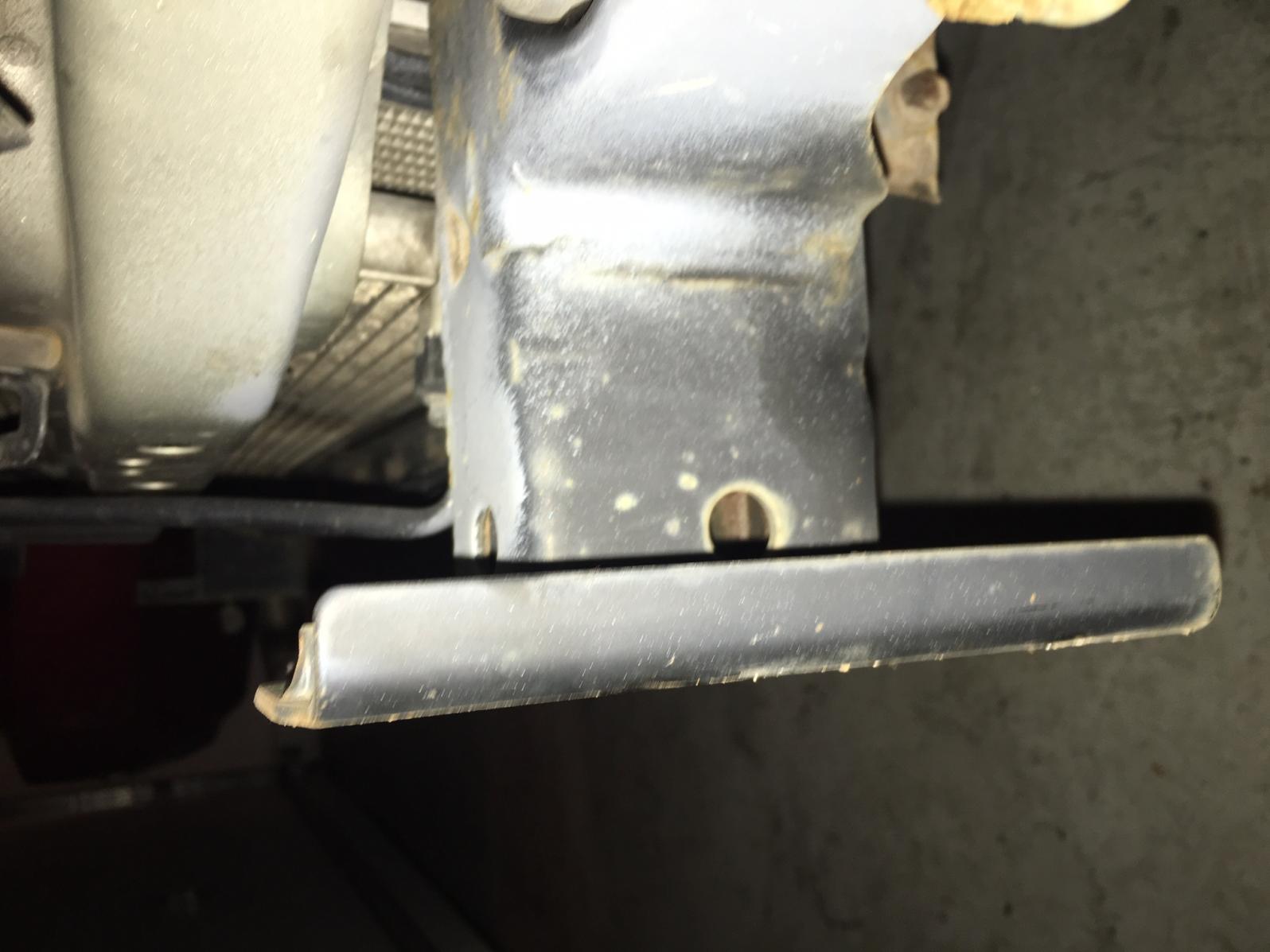

OEM Skid Plate Help
Hi guys, I'm new here. I visited a junkyard today and found an 98 SR5 that still had the front OEM skid plate that covers the very front of the engine near the radiator. I myself have a 2000 SR5 with only the oil pan OEM skid plate, but it looks like there is a spot on the front frame on my 00' that it might bolt on. Does anyone have any knowledge of if 98' OEM skids will fit a 00'?
I want to get it (and get it fast before it's gone) but not sure if it would fit or bolt on. Also is anyone familiar with what mm the bolts are? The yard closed and forced me out right as I was looking at it. I assume a 10mm or 11mm as they were rather small.

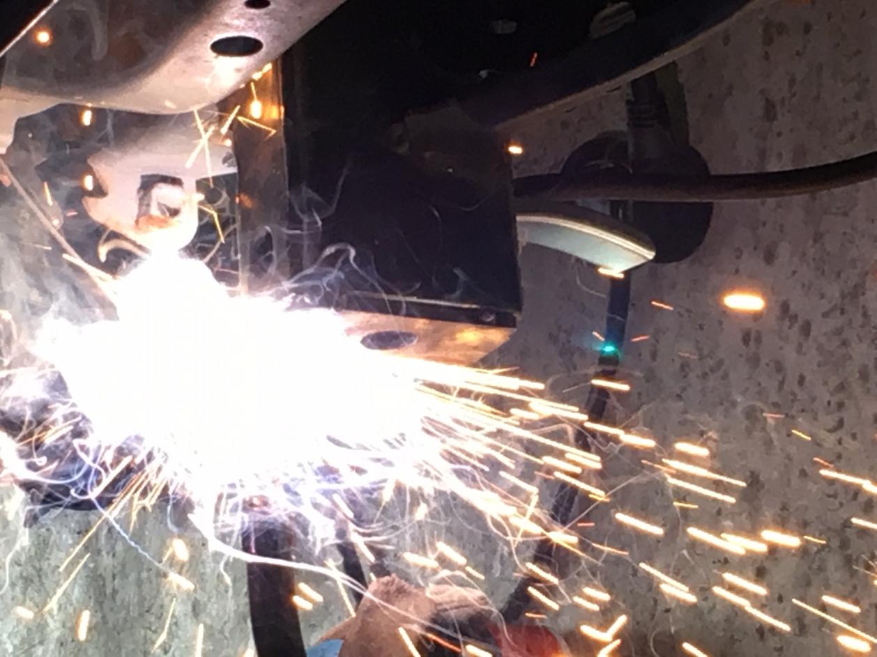

nice CL find with full armor dump from gentleman whose frame rotted away before he could do the upgrade - frame rail prep on 2nd boy's runner - no winch $$ in hand, but might as well be prepared

felt like I found Amelia Earhart's plane
Hi Repo - Central PA - still in original unopened packaging - trembled a little when I opened it. I would have filmed the unboxing experience - except I was weeping.
