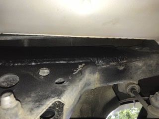

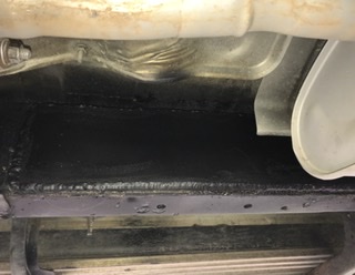

It was a local all around repair/maintenance shop here in central Arkansas, but they also specialize in 4x4s and custom crawlers by the looks of the yard. Was recommended by an off road tire/parts shop in the area. When I talked with them initially the service guy brought up that they build and work on custom frames so that put my mind at ease. The service guy cut out the rot on the inside frame rail then welded the new plate in there.
After reading other frame resto threads here I knew going in that anything quoted under a couple hundred couldn’t be trusted and this shop quoted me $600.
Here’s a couple more pick to show how far he took it up the frame.

Did he vacuum inside the frame? I ended up having to patch my frame as well and there was a good bit of loose rotted metal around the rot. That stuff is a moisture magnet. I vacuumed as much as my hose would reach. Took my front bumper off, stuck my garden hose through the rear opening, and got some more out. I pumped a good bit of used oil into the frame to neutralize whatever remained. I hate rust!
I hear ya. Don’t think he went to that extent. It’s definitely cleaner than it was, there’s still some loose pieces. My frame/undercarriage is due for another good inspection, wire brush and reseal anyways. Starting to see a lot of surface rust pop back up in the rear.
