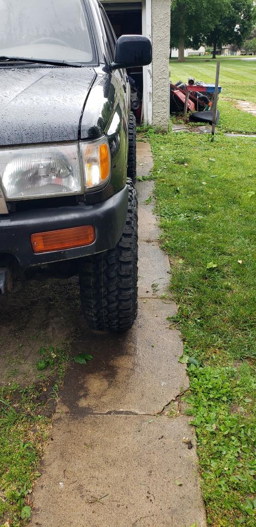

"2018 18' wheels" as in those are 18 inch wheels? I have those exact same wheels and they are 17 inches.

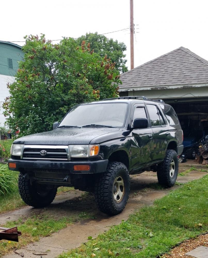

Yes I mistyped 17’’ wheels sorry, no rubbing whatsoever but its close. Had I not replaced shocks and coil springs could a couple years ago may have been a problem. Today I washed her, cleaned MAF, added some seafoam and ww fluid. Gonna do some beach riding tomorrow.

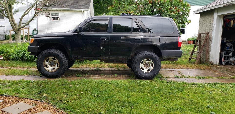

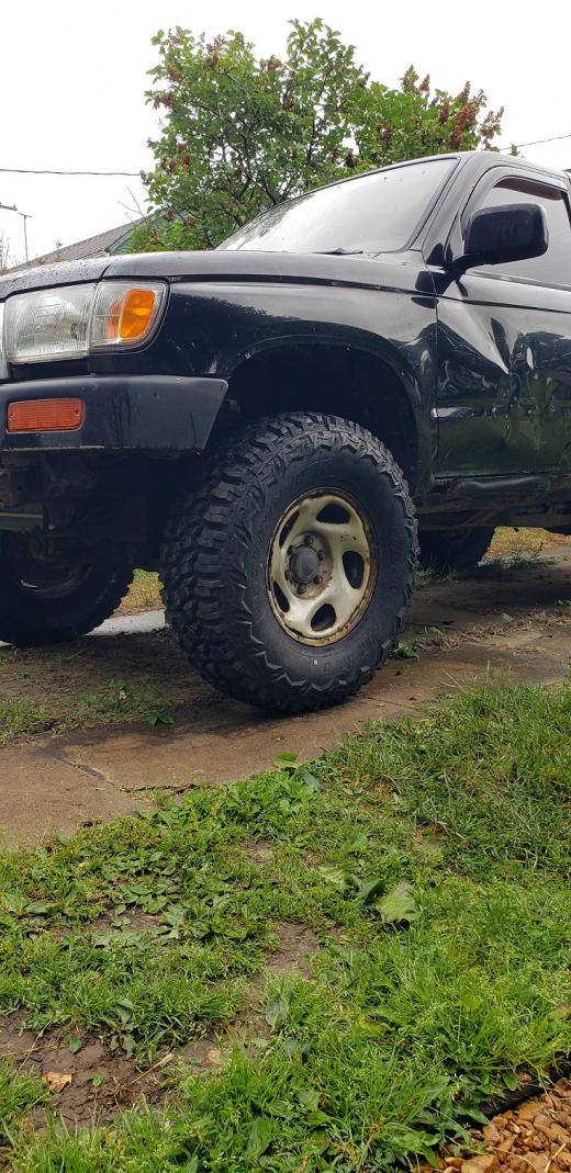

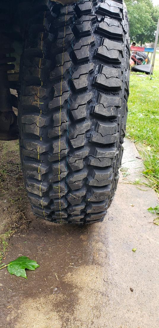

Got some 285/75/16 Thunderer Trac Grip mt tires mounted up today. First real mod other than trying to paint the hood, fender and hatch black couple weeks ago. Going to be painting the wheels black to cover the rust on them when it dries out

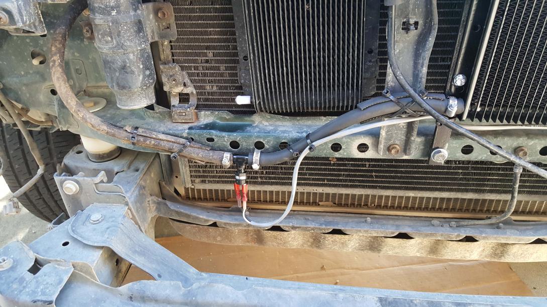

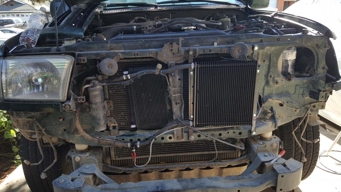

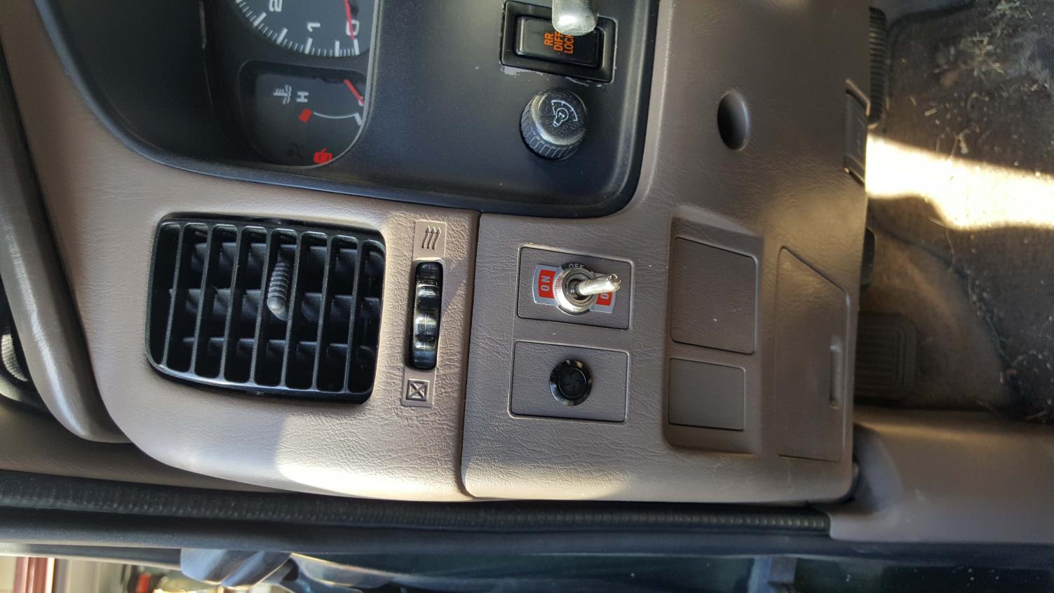

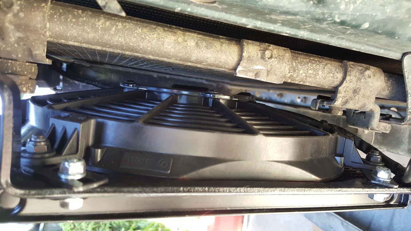

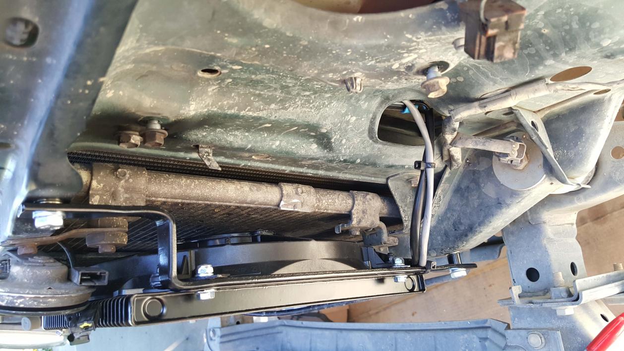

Today I got the new trans cooler with fan installed. Took longer then I expected, but came out great. Leaving the old cooler in and I'll run it as a power steering cooler as it gets cooking hot. Fan has 3 modes via spdt switch and relay, pulls 809 c.f.m .@ 15 amps. Normal operation (turns on at 180 degrees via thermo switch), completely off (water crossings ect.), and manual on. Even added a radical little fan led. I have the front still stripped apart to do the ps cooler and hid headlight retrofit. Man I'm working harder on vacation then at work lol. Front end lift stuff should be here end of this week.
Interested in seeing how well this works for you. Have been considering doing something similar for a while. Have had the fan for over a year now just waiting in the garage.
What trans cooler is that? Fan and controller come with?
Did you happen to experiment with the fan in the front, pushing ambient air through? I tend to think it being behind pulling, as you did, is desirable, for a couple reasons...
Not particularly impressed so far with mine.
Just driving around, the fan of course is a large obstruction of air flow, and cooling is noticeably degraded. When the fan is turned-on, I have not yet noticed an appreciable benefit. Wondering if a thinner profile fan behind pulling is the way to go...
