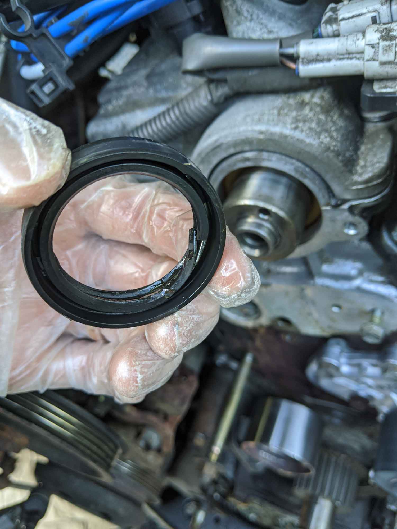

I finished replacing my front rotors, pads, rear drums, shoes and rear cylinders with R1 Concepts brakes. I opted for the slotted and drilled rotors. Everything is good as new.
You are a brave person for trusting amazon products that deep in the engine.
For me it's OEM from the dealer unless the labor to change it again is like 5 minutes and the part is not critical. I've got moog sway bar links and that's about it.
Don't worry it was OEM off amazon. It was very obvious where the leak was from when I took the old camshaft seal out... must have started tapping it in before I seated it with my hands, or it was dark, who knows. But fixed now and running 100%!
