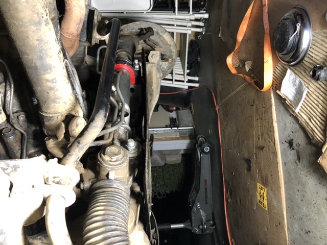

Installed energy suspension steering rack bushings, fixed the squeek in my steering..

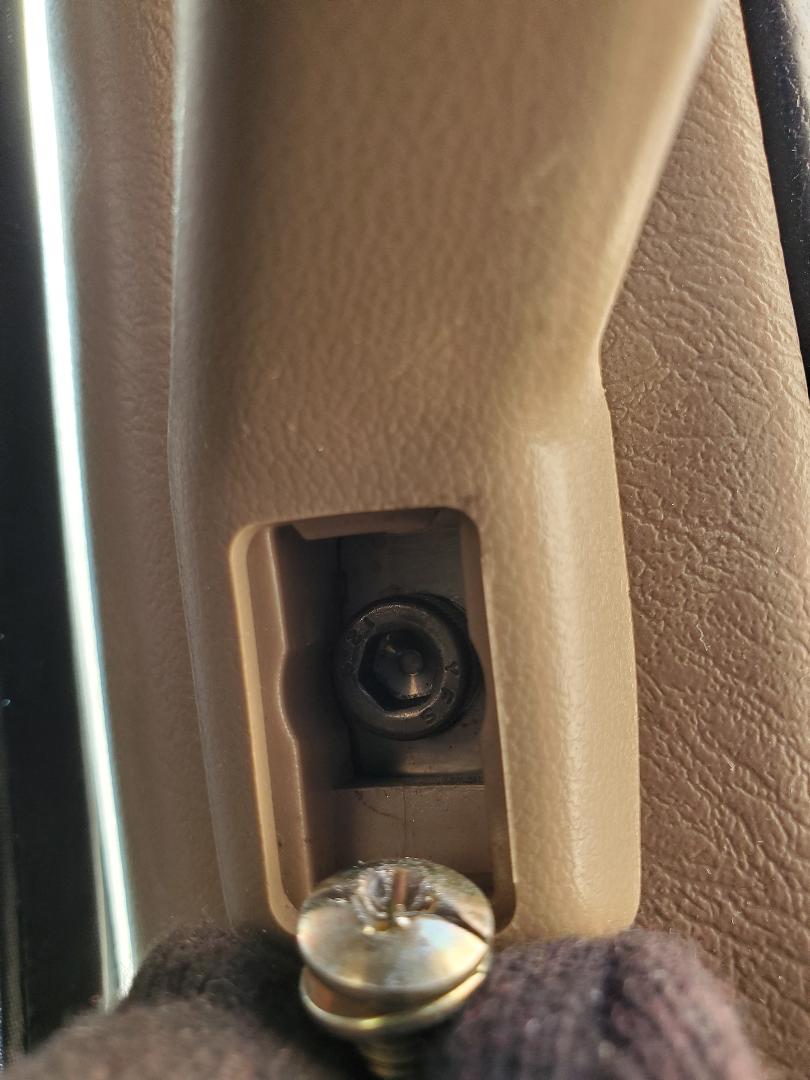

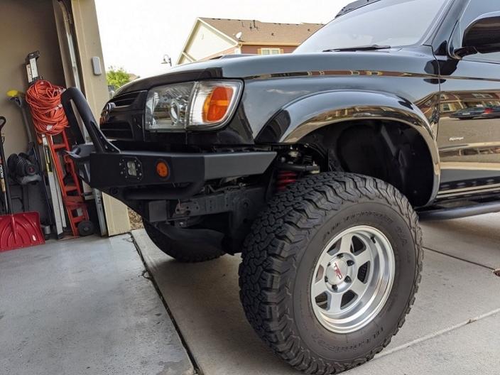

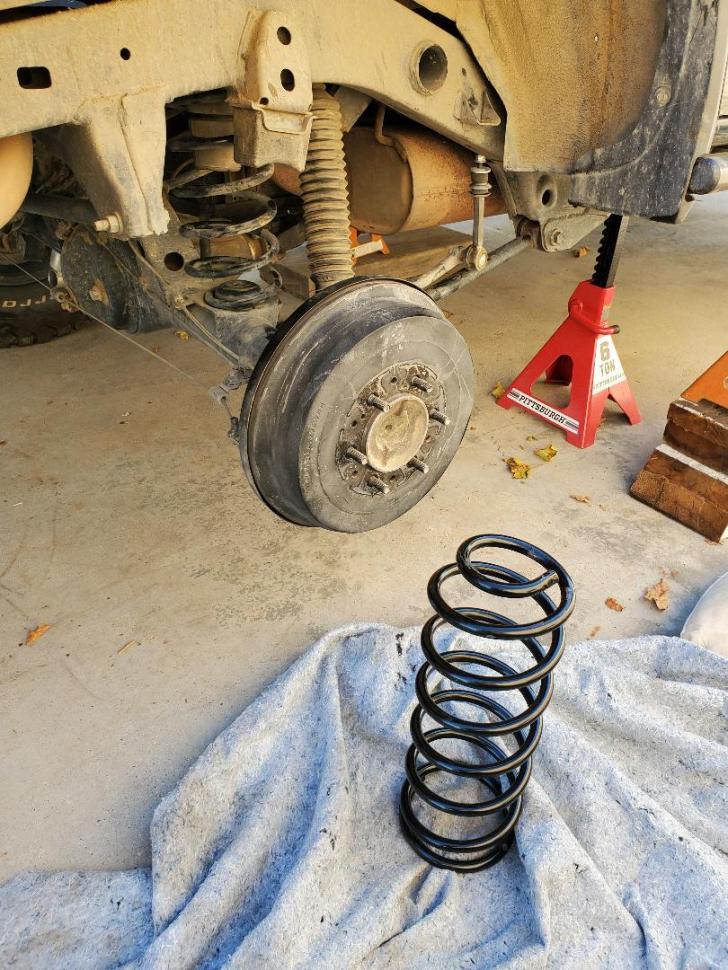

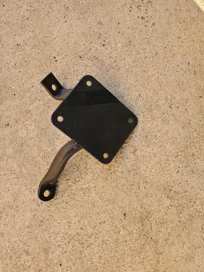

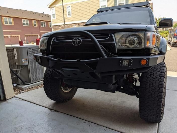

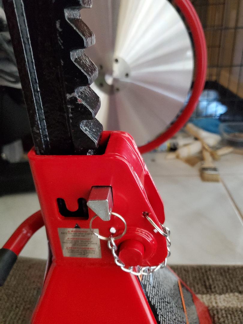

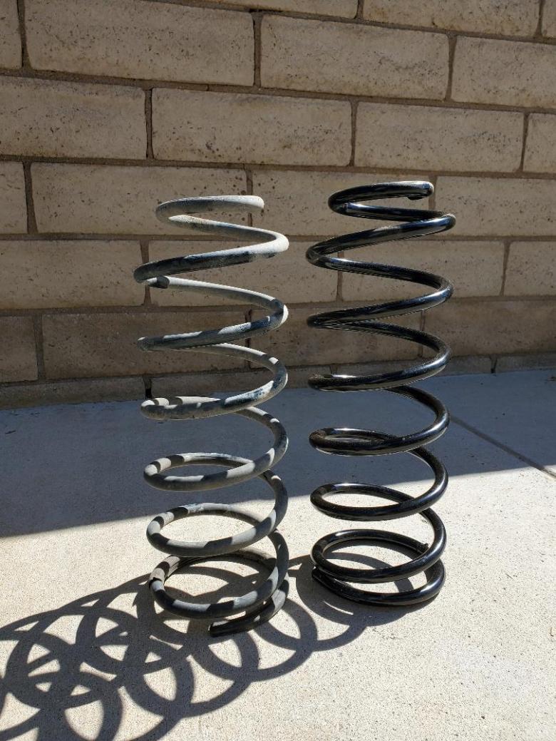

Installed the Moog 81041 springs to fix the ~1.5" rear sag but they were just as saggy so I got Daystar KT09107BK 1.5" spacers and they are perfect. Also got better stands with a safety pin. Changed the JIS head interior grab handles to hex head. Made a little mount for the ARB actuator pump.
What jack stands are those?
