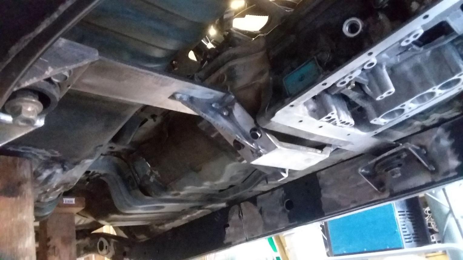

Devbot: Shit's armored to the teeth. All steel? Gotta be heavy, what's your suspension set up?
Not that heavy and purposefully built (I hope), U have to take into consideration that I have removed all the OEM cross members and my engine in stock config puts out 280hp 338ft/lb stock... and ill be turning it up a bit more.
once my kings get here and I can start working out a basic design Ill post a pic of the suspension
The window deletes do not weigh anymore then the windows they replace.

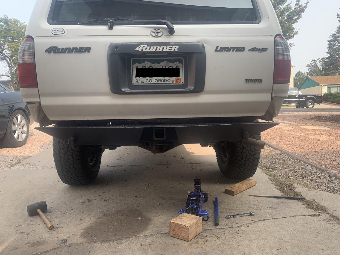

Tried my hand at fabwork... just got a flux core welder for messing around with earlier this year so made my first big project, a bumper (kinda hard to see since it's black). don't love how it turned out but it's a starting place! gotta figure out how to add some quarter panel protection eventually.

dont worry,
we all have to start somewhere
look at my front bumper,
I started with some plate and look at the result
just dont give up.
