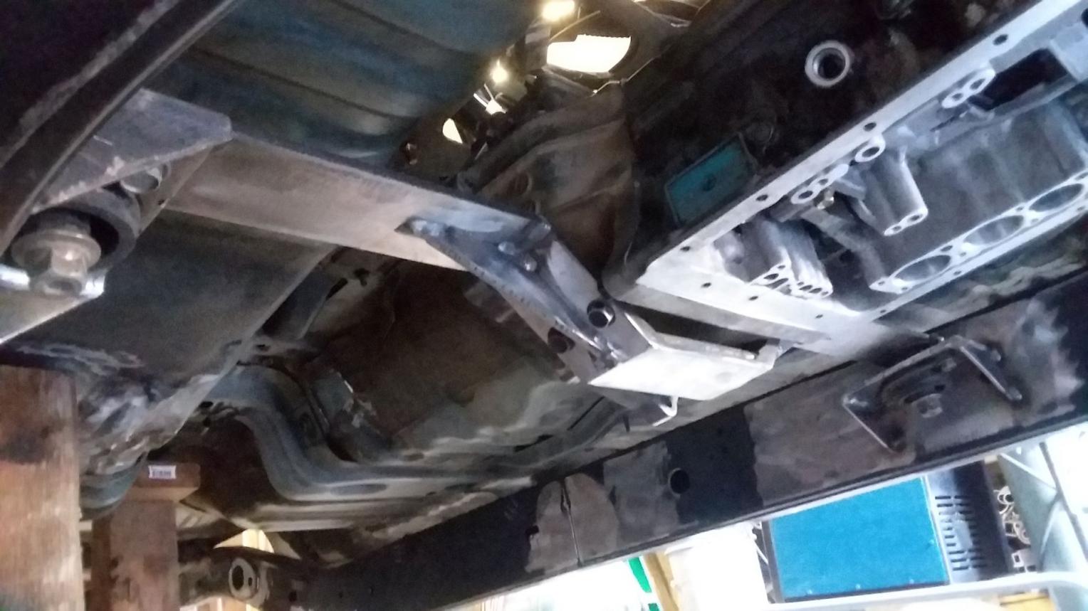

Messed around with my transmission support bracket for the 4wd conversion. Seems to be no way around me having to cut the 2wd horns off. Their placement is in the way, and not usable for easily adapting to the new trans bracket. I might just have to use the Trail Gear skid-plate after all. Drilling 6 holes in the frame won't be fun or easy, but I just don't trust my welding skills and not willing to pay a welder for a house-call. I can't even test fit the skid plate with the horns in place. Looks like it's going to take the leap of going all in.
