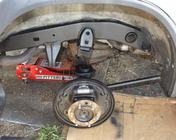

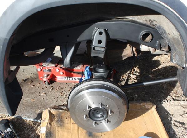

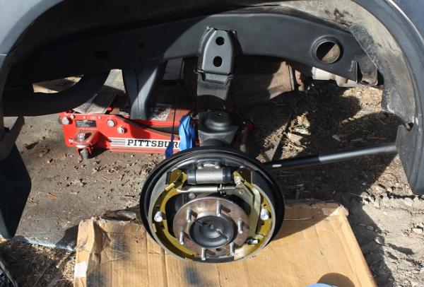

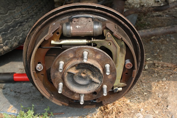

I did a complete rear brake job on my '96 along with some rust control. New drums, shoes, wheel cylinders and hardware. Came out real nice I thought. I have brand new tires and wheels along with a lift kit and I just could not put them on with the wheel well looking like this. Plus a great time to access all this stuff to work on it. This baby has 296K on it
This rig has seen a ton of miles with little to no love. That is changing as I have a huge list of things I am doing now!

Did you go full OEM on everything? Do you have part numbers? I'm looking to replace my rear brakes as well soon and would love a starting point.

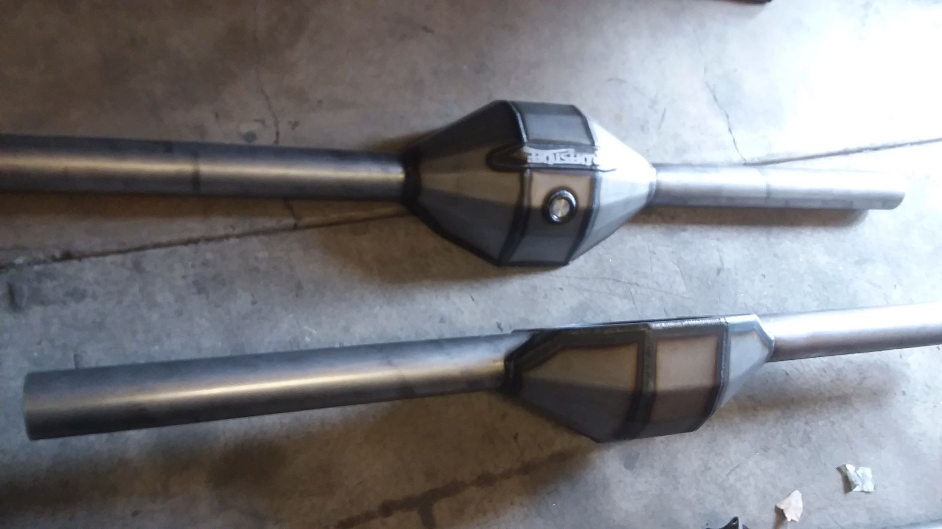

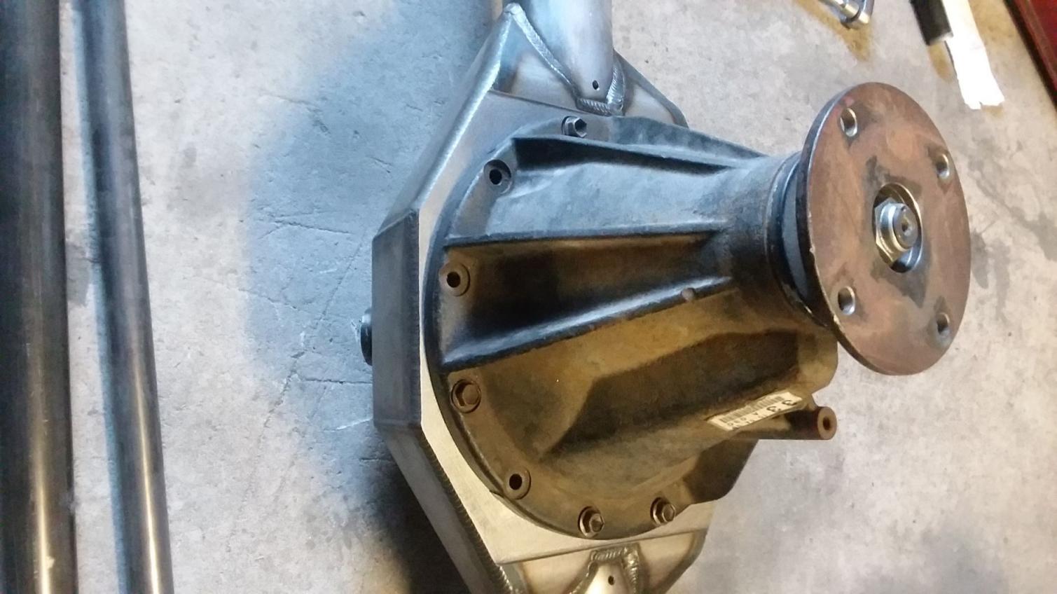

Got this nice axle housings but now have to send them back... the bolt pattern is upside down, the fill plug is on the bottom. The housing look pretty sweet, hopefully everything gets worked out. So far Ruff Stuff has been all over getting it right...
Hi there. I did NOT use OEM parts. I don't get kicked out of the club do I? I used Brembo drums and Centric shoes and hardware. The wheel cylinders were from A/C Delco. It all went together perfectly and functions just fine. I have not done a road test yet as I am installing a lift at the moment. If you would like part #'s on what I did use let me know.
