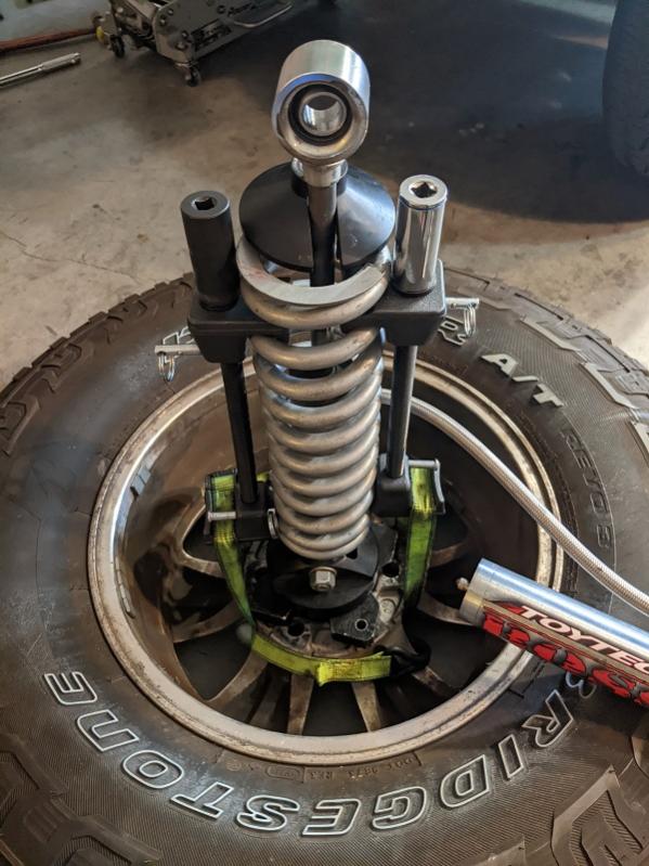

Installed some 400lb silver coils to my Toytec adjustable set up (perfect for my 2wd 3rz). However you may find out that the normal spring compressors don't quite work with the thinner diameter coils and shock body. So I had to come up with this kajigger to get the coils off. There were no loaner tools that would could do the job and all the auto shops don't want to compress coils because of liability reasons... I wish there were more small shops instead of all these corporate mechanics.

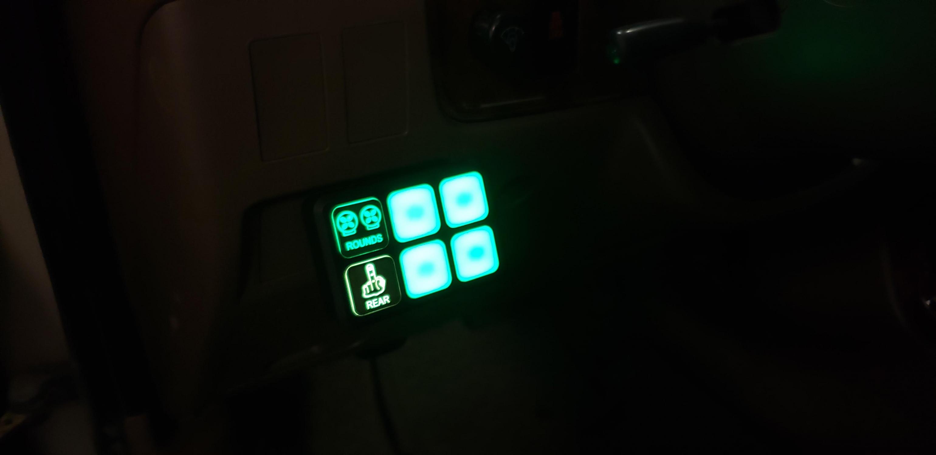

This happening in offseason Seat heater control in that location so I went LC rotary locker switch - your battery switch. Works, don't like having RR or RR & FR only function with LC switch after using it a while.
Thanks for confirming that the LC switch would fit there as I thought it might.
Looked at that option but agree, wanted more choices as to which locker was on when.
PS. Seat heater would be very nice (insert Homer drool emoji here)
