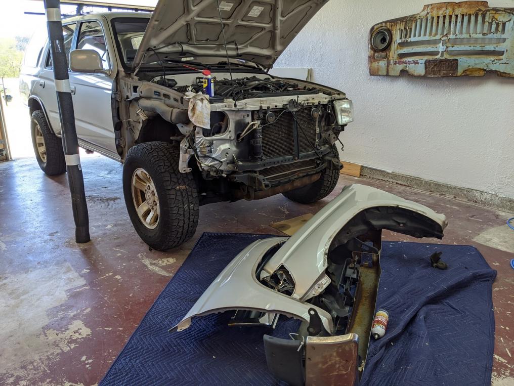

Removed running boards, bumpers (rear has some rust, front was mutilated), bad fenders and hood today. This is in preparation of picking up a 2000 in same Desert Dune for a donor vehicle.
Next up is OEM replacement of sway bar links, 99 springs, shocks, valve cover gaskets, timing belt, water pump and maybe a transmission flush to boot.
I'm not very adept at any of this but I'm pretty ok at google....
Anyway, can anyone see any preferred order of the mechanical work while I've got some body parts out of the way?

Don't flush the trans. Do a series of drain and fill fluid swaps driving it in between.
Coolant swap when you do timing chain and water pump. Valve covers and rear cam plugs at same time as timing chain, makes access easy.
The rest is the rest. I would consider all the front suspension bushings (LCA, steering rack, etc) at the same time you do front springs. How fresh are the brakes?
Sent from my Pixel 4 XL using Tapatalk
Misspoke on transmission "flush" and intend to drain/fill per Timmy Toolman video.
Will look into LCAs as well. Good point on brakes... List keeps getting longer.

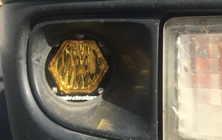

Test fit these in the stock fog light slot.
S1 wide cornering amber. Now to figure out if I want to use the existing pre wiring for factory fogs and get a new stalk with a switch or wire them up my self to a switch in the punch outs beneath the dash hmmm options options options... also got to figure out a mount bracket. Hmmm gonna look BA

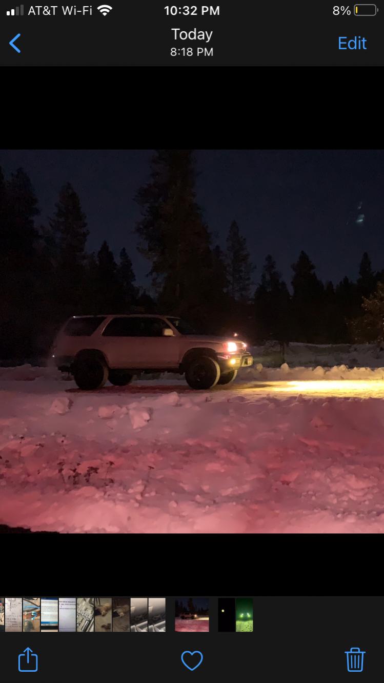

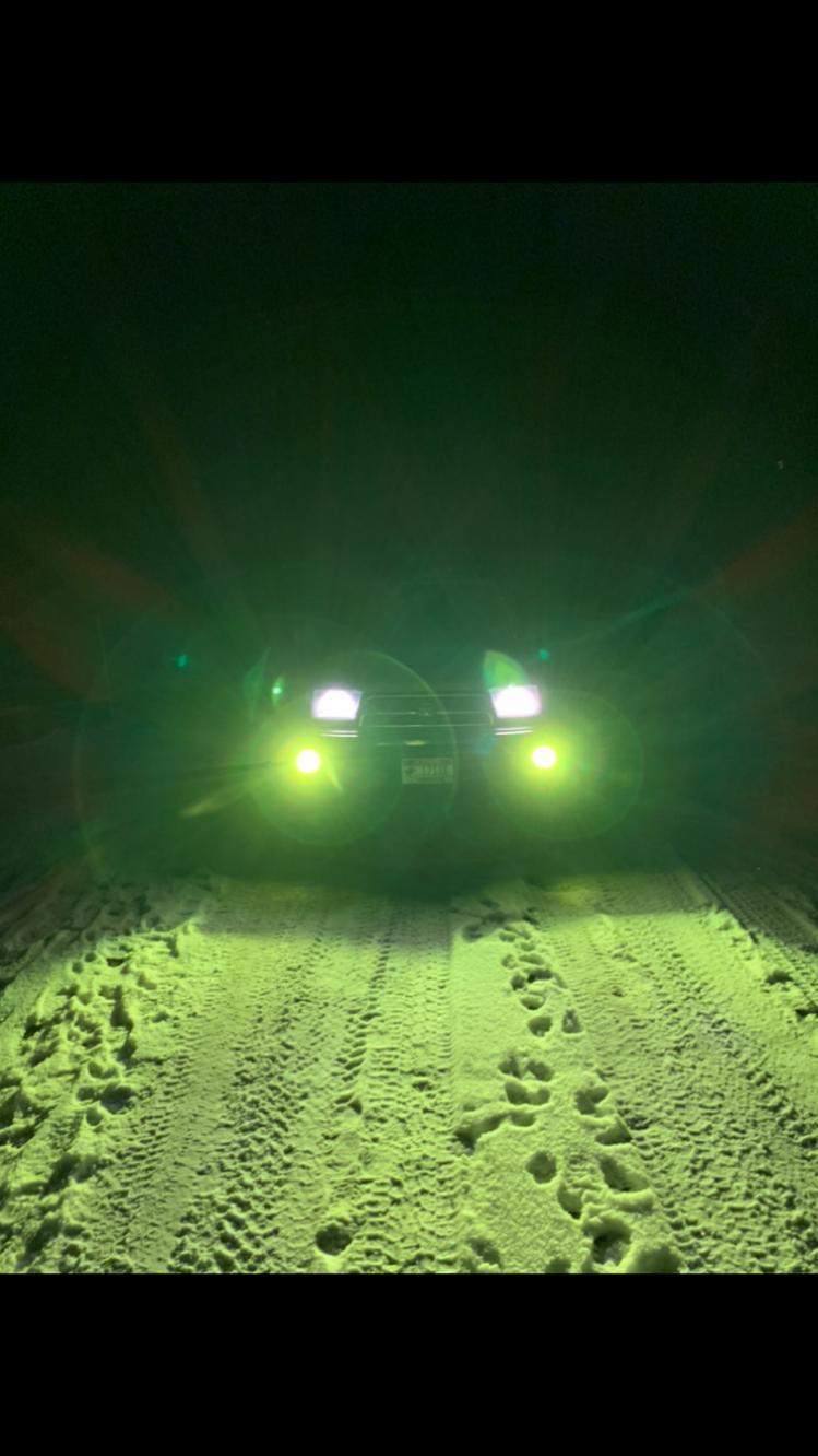

Finally installed these lights super easy install. Used some zinc bracing brackets from the hardware store to mount them into the bumper fog slots.

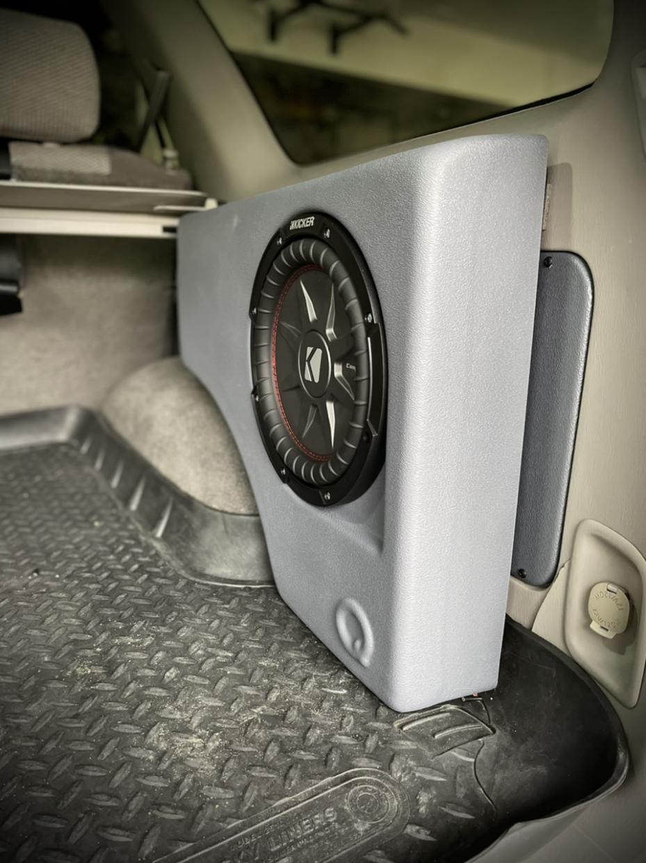

Upgraded sound system. Focal separates and coaxials. Kicker 10” sub in Qlogic enclosure. Wanted a little bass. This is perfect. Noico to reduce rattles and vibration.
