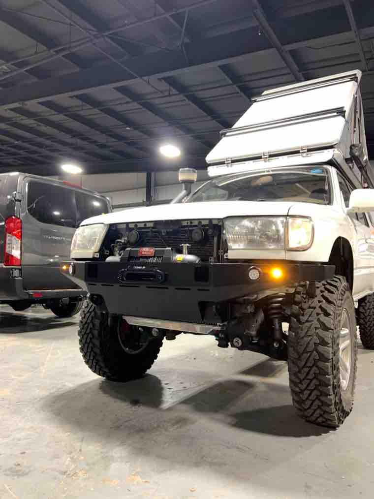

Those are pretty swanky man. I appreciate what you're after. If you keep that format though is it safe to say you won't be going offroad with it? I'm after ways to update the look of mine too.
I like the projectors but something about a stock headlight assembly for me can't be beat.
Thanks for taking a look! The headlights are original just swapped bulbs to LEDs. Keep the light color uniform you know? I'm a little OCD :D
The offroad comment is in reference to how low the DRLs are? They are a little higher than where the stock skid plate up front hits so my goal is to offroad it. I guess we'll see how the trail treats it!!

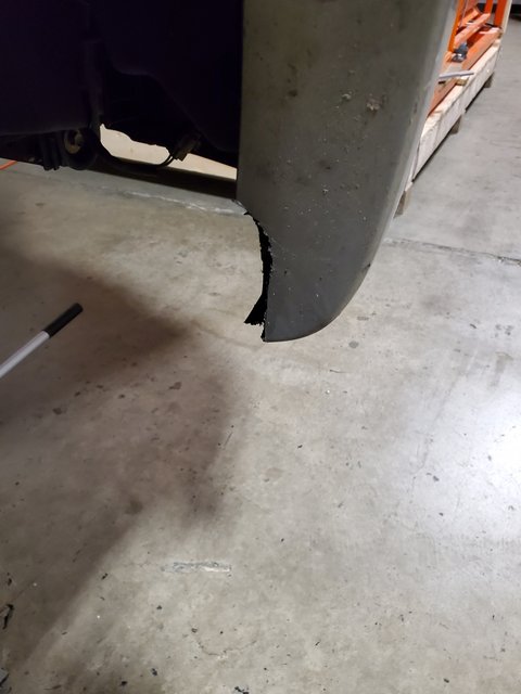

Put some 4th gen 5160's in to keep up with the 210v's. The base mount is wider than the 5100's, but the bushing is a different design, so they ended up having roughly a similar gap between the mount post on the axle and bolt. The 5160's are perfect (so far) for these springs! Firm to the point where it got rid of most of the body roll that came with the sway bar deletes, but soaks up all of the road still.
I also trimmed the limited flares up front because my 255/75/17 Duratracs were rubbing during braking in a turn after removing the sway bar. it wasn't hitting much and considering I'll be putting a new bumper on in the coming months I don't mind hacking this one.

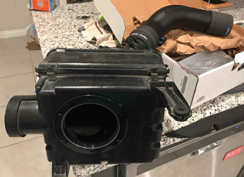

Replaced the crappy cold air intake/K&N air filter that was killing my MAFs with a stock airbox out of a wrecked 4runner.
Its amazing how much better it runs.

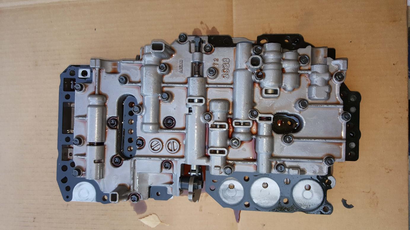

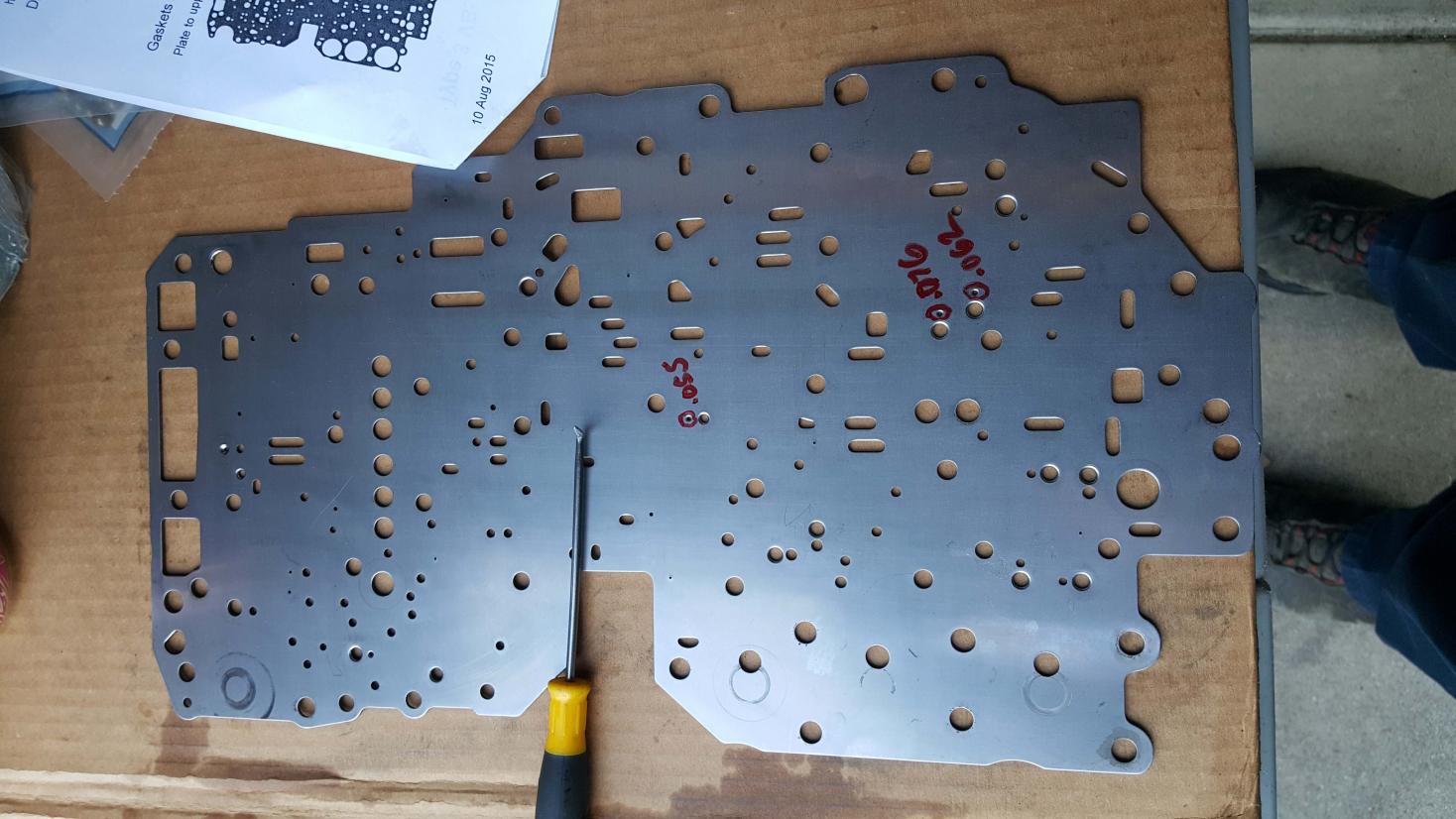

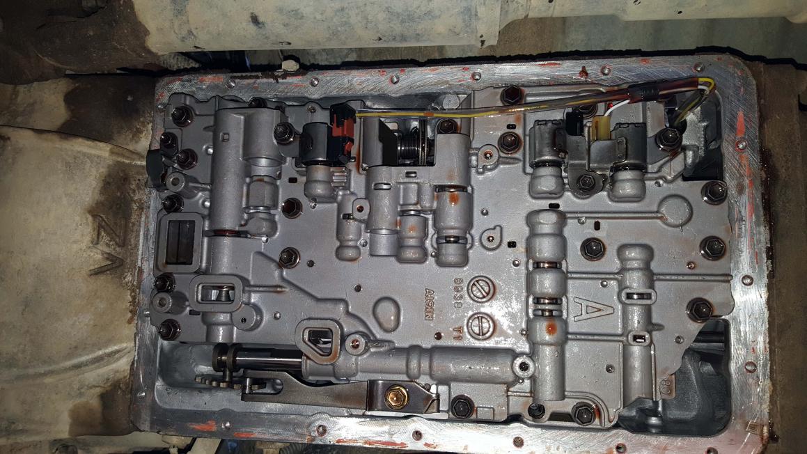

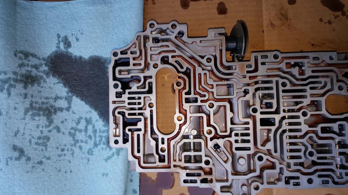

Started the transgo 340-hd-2 shift kit install. Everything is done and installed just need the fipg to cure. So tomorrow will be the flush/fill and test drive. I have the type 3 valve body and type B accumulator pistons, I also opted to do the low gear hold option (keeps trans is 1st gear when in the L position). Only part of it that was a real pain was getting the 2, 3, and 4th accumulator piston springs out. I have the "B" type that have the retainers holding the lower spring on. Tip for anyone doing this, use tons of assembly goop to hold the gear pistons and springs in place. Wear a face shield when working under the trans. I did get covered in tranny fluid. I crossed my T's and dotted my i's, im hoping there are no issues. Trans fluid was pretty dirty. Here are some pics.
Yep this was my Thanksgiving day for me. I had fun! Also this long weekend I'll finish rebuilding the mustang rear calipers and start the front tundra caliper rebuilds. Gotta get my brake upgrade/rear disc swap done.

Finished up the shift kit install. Flushed the remaining fluid (13 total quarts). Then installed a new magnafine inline filter. Test drove it and damn, this is exactly how it should be! So nice, short and crisp shifts. Seems temps are a bit lower too. Very smooth. I'm 100% satisfied, I should have done this sooner (been sitting on this for a half a year).
