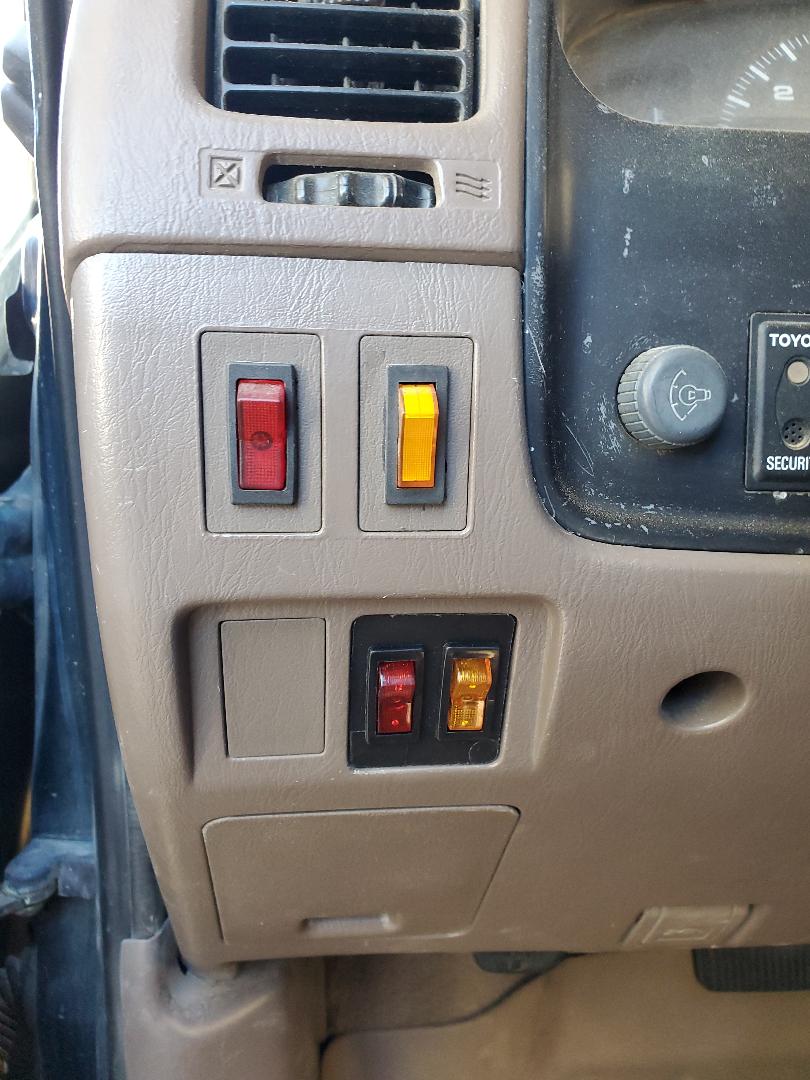

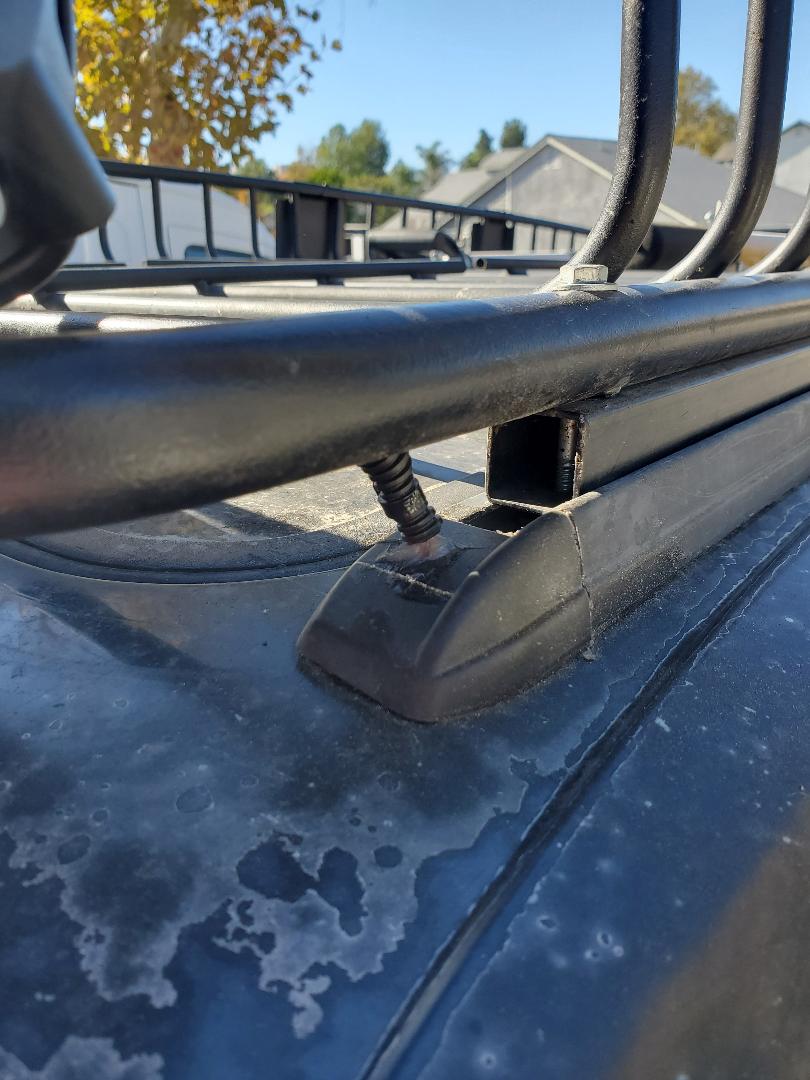

Do you have a write up on that roof rack wiring?
I have a bit of a different roof rack so my wiring will be different but here's where it comes out(picture). Pull the grab rail from the drivers roof post and pop the panel cover and you can fish the wire from under the dash, along the inside of the panel and into the headliner, then drill a hole thru the roof where ever you want it to exit. I wasn't thrilled with putting a hole in the roof but under the roof rail cap seemed like the best place. The wire has 2 layers of shrink wrap and the cap is filled with silicone and inside of the roof is silicones as well so it is not going to leak.

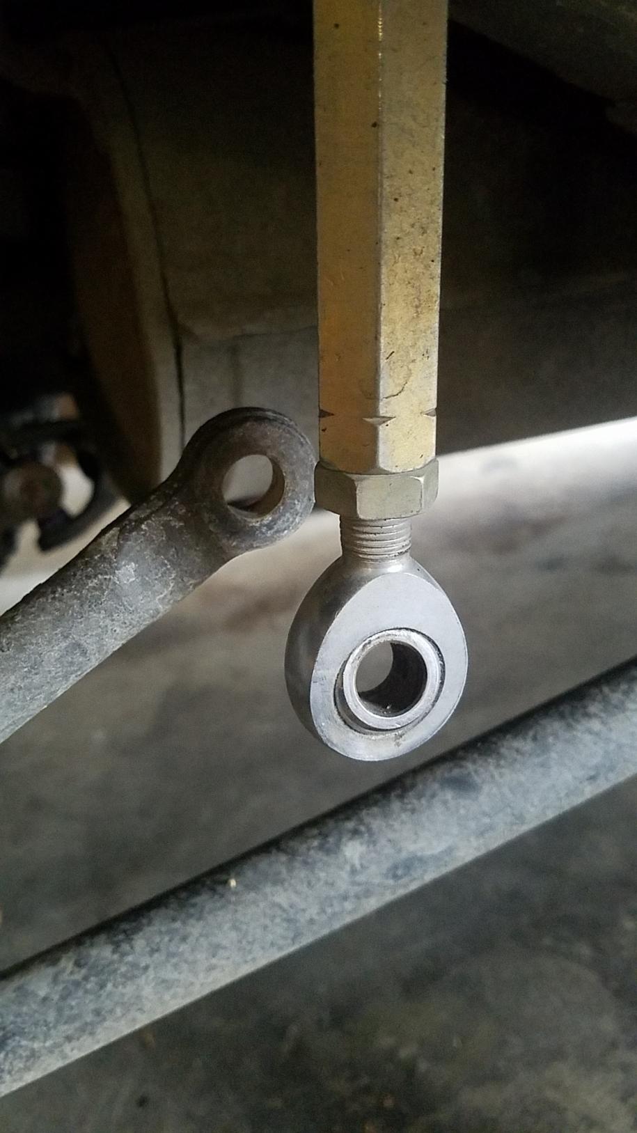

Broke the unbreakable links. Went a couple miles down a very light trail and the bolt sheared in two. Was wondering why my rear suddenly got bouncier.

Wow - that sucks. What other long/strong options are out there?
Well seeing as how I've driven multiple bone stock cars down that road dozens of times and never broken a part, let alone a sway bar end link, probably anything else. I'm going back to Moog and welding on a sleeve to extend them. If you're handy on a lathe, you can make these no problem.
If you're interested OCD is gonna be making a new version of these links with ball joints over heim joints, but like hell I'll be trying them or recommend anybody do. Especially with the pricing.
Mind you it was the bolt that sheared, not like the shaft of the link snapping, and that heim/bolt/spacer/nut mix up was giving me hell from the start. And many others. Single axis load isnt great for heim joints anyways so makes sense.

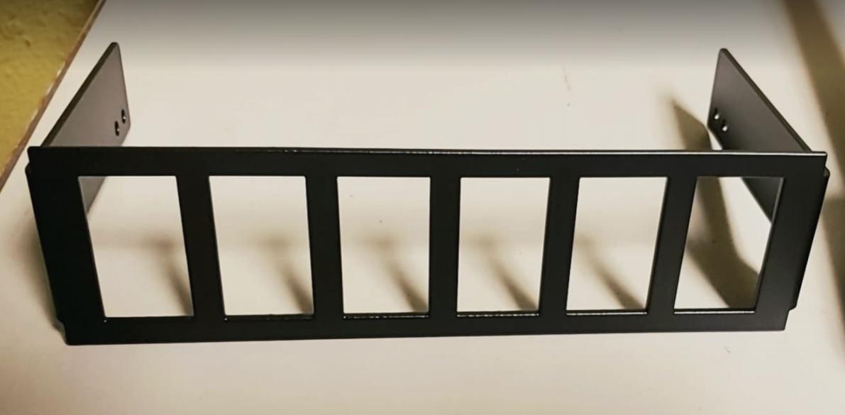

Got my switchplate from paranoid fabrications back from the powder coating shop.

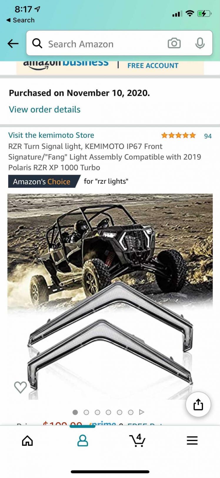

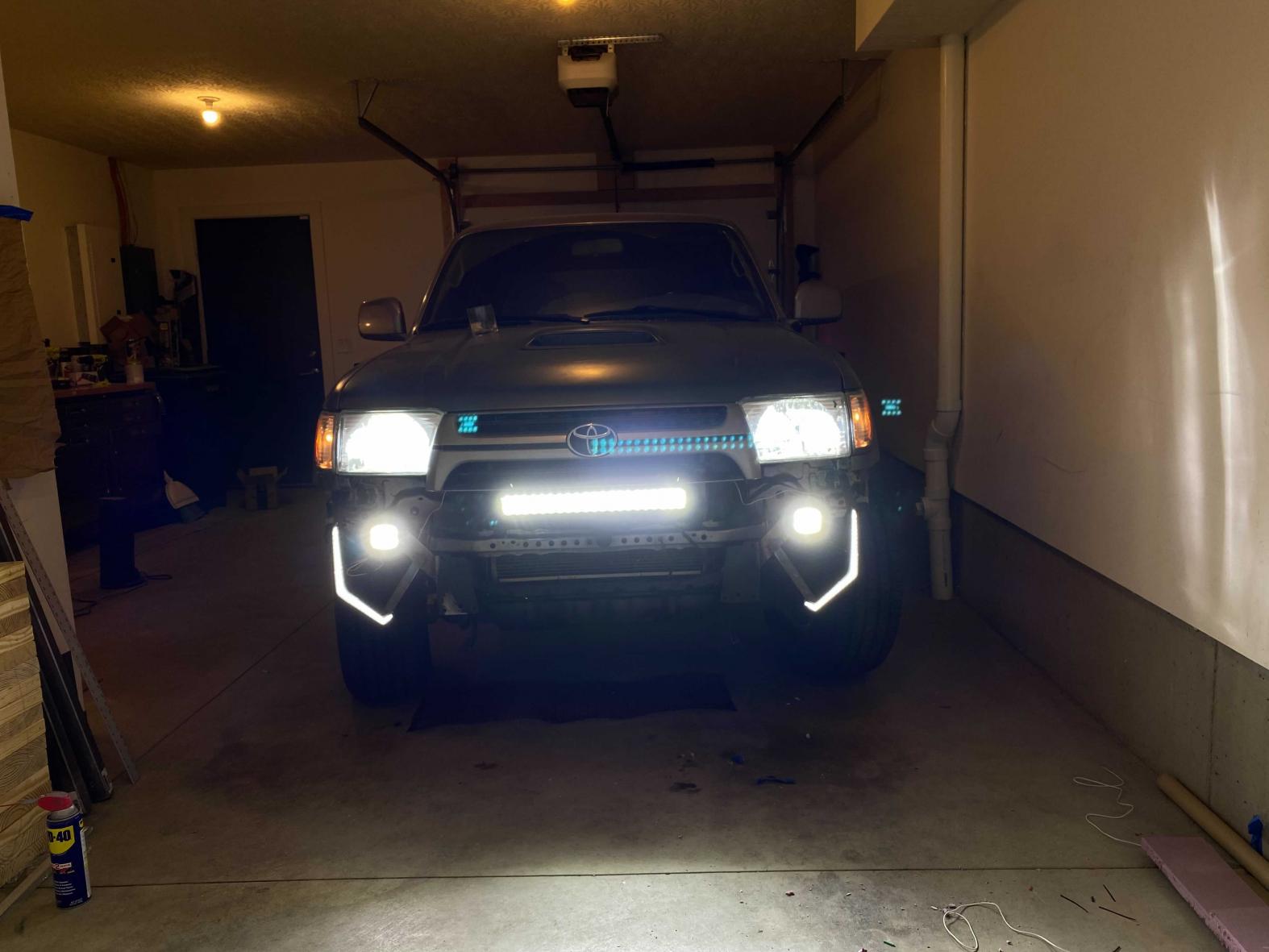

Custom Lighting! Fog, DRLs, and light bar
So I really wanted to modernize my 3rd gen's face and went shopping on Amazon for some nice DRLs + Turn signals that would fit the body/face lines. Pretty happy with how these all turned out. Now it's time to fabricate the new bumper from scratch.
