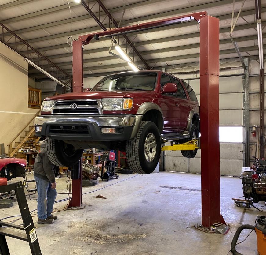

OK, so I found and acquired an exact match rust-free donor frame! :guitar2:
I'm going to try to get to my reply quota so I can start a new thread to hopefully post some before/after of the work.
is yours that nice red one you shared earlier?
