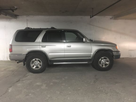

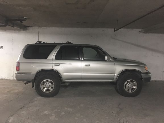

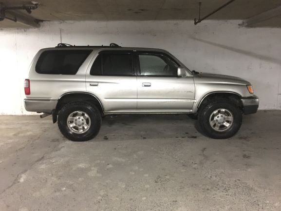

Removed my running boards and replaced my rear suspension with 5100s and 906s.
See images: Stock -> no running boards -> new rear suspension
