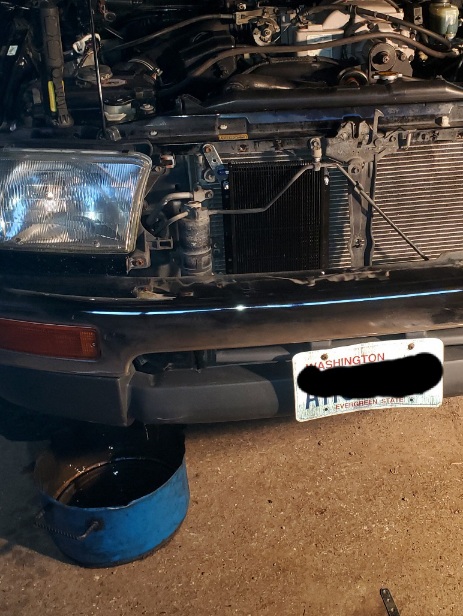

Trans high heat
First trip out in the snow trans light came on an got pretty warm so I installed the b&m 70268 like I've seen on here seems to be keeping it pretty cool gotta add trans temp gauge now to see how hot its actually getting

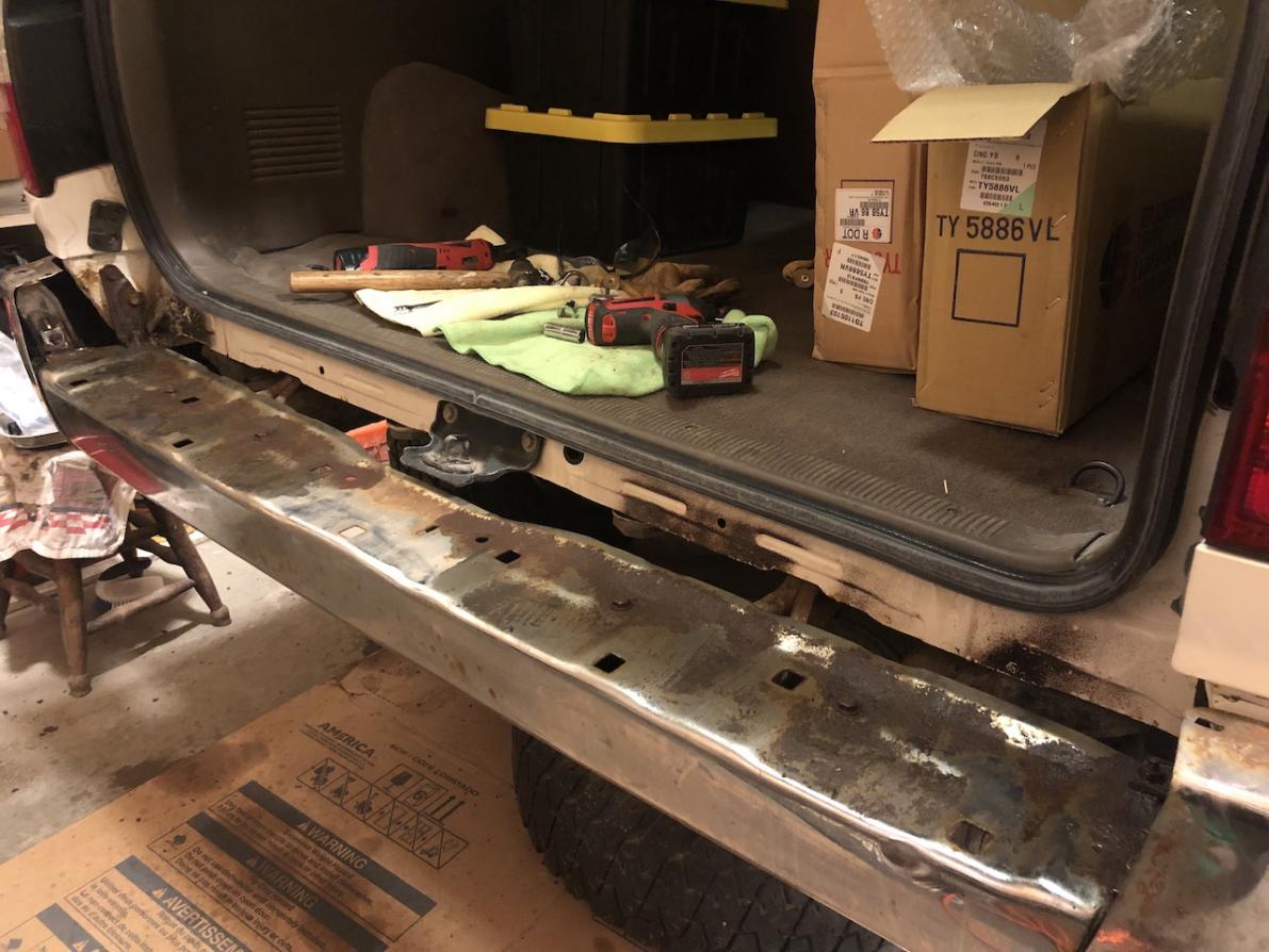

Started removal of my rear bumper. Replacing with TY replacement panels.
Operative word started!
Great resource for dismantling with Tim's video of an aftermarket bumper...just wish my bolts would zip off as easy as his!
Looks like I might destroy all of the bolts and need to buy new ones. $4 each at the dealer! Anyone know what size? M8?
edit: Toyota 3rd gen bolts +/- in length m6x1.0x20/m8x1.25x25/m10x1.25x30
