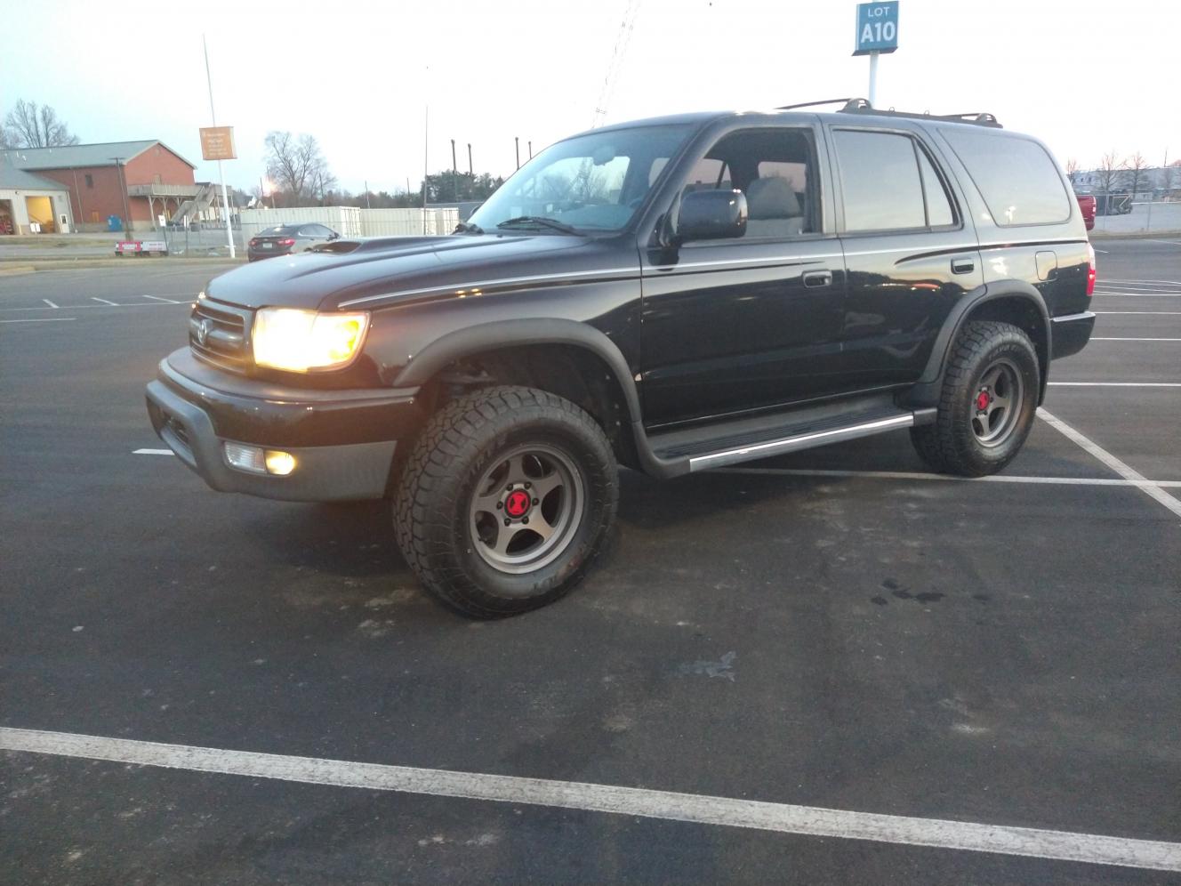

Installed new wheels and tires
Put some new wheels and tires on the wife's 4Runner (Natasha)
16x8 +0 FN Wheels Five Stars
Painted gun metal and matte cleared 2K
Personalized the center caps with Black Widow logos
TOYO TIRE OPEN COUNTRY A/T III 265-70-16 (stock size)
No lift

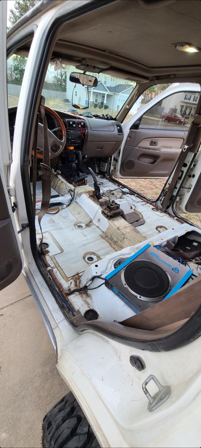

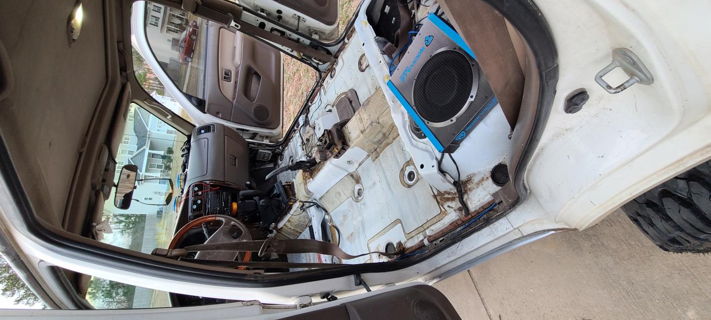

Well some water got in on the passenger side after I sunk her a few weeks ago and it just smelled terrible so I figured it was time to get rid of that 25 year old carpet.. btw it was disgusting so glad it's out. New carpet from stock interiors should be here tomorrow! I went with black because I like it in my car so well see how it turns out

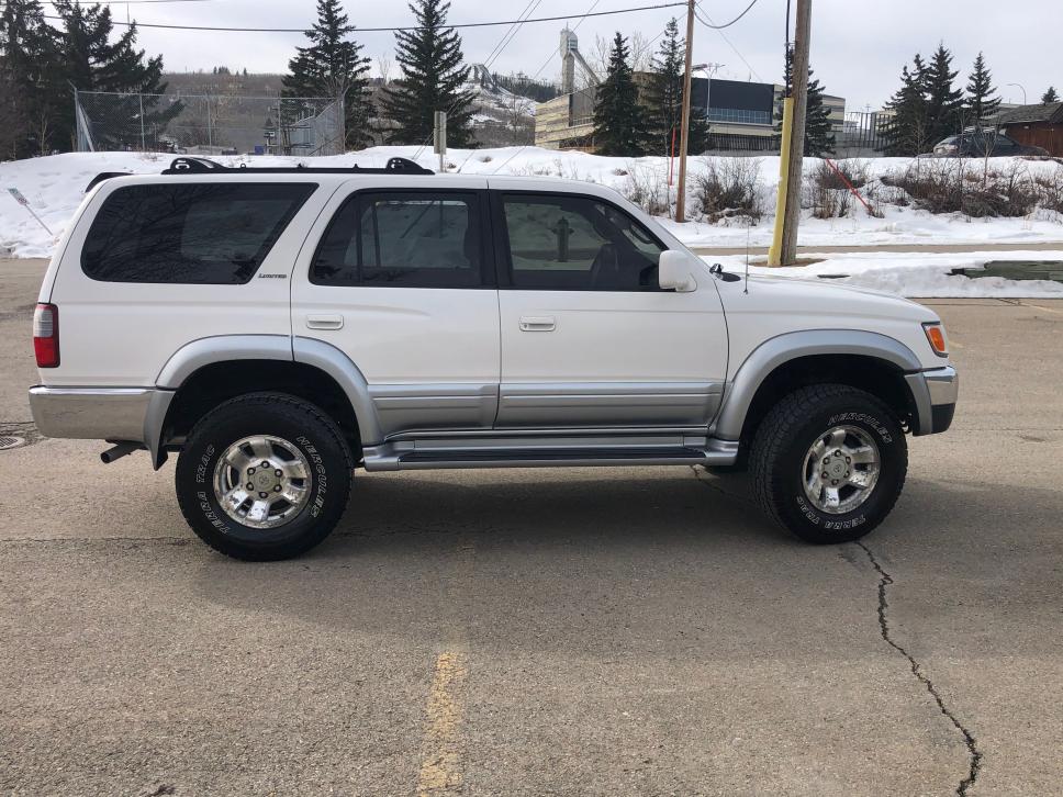

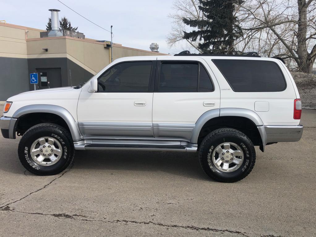

got it washed real good...need to decide on some rims to fill out to the edge of the flares..probably -10 o/s or so. Looking at 285 75 16 Duratracs for sure! Parked at the abandoned local church not the handicapped stall.

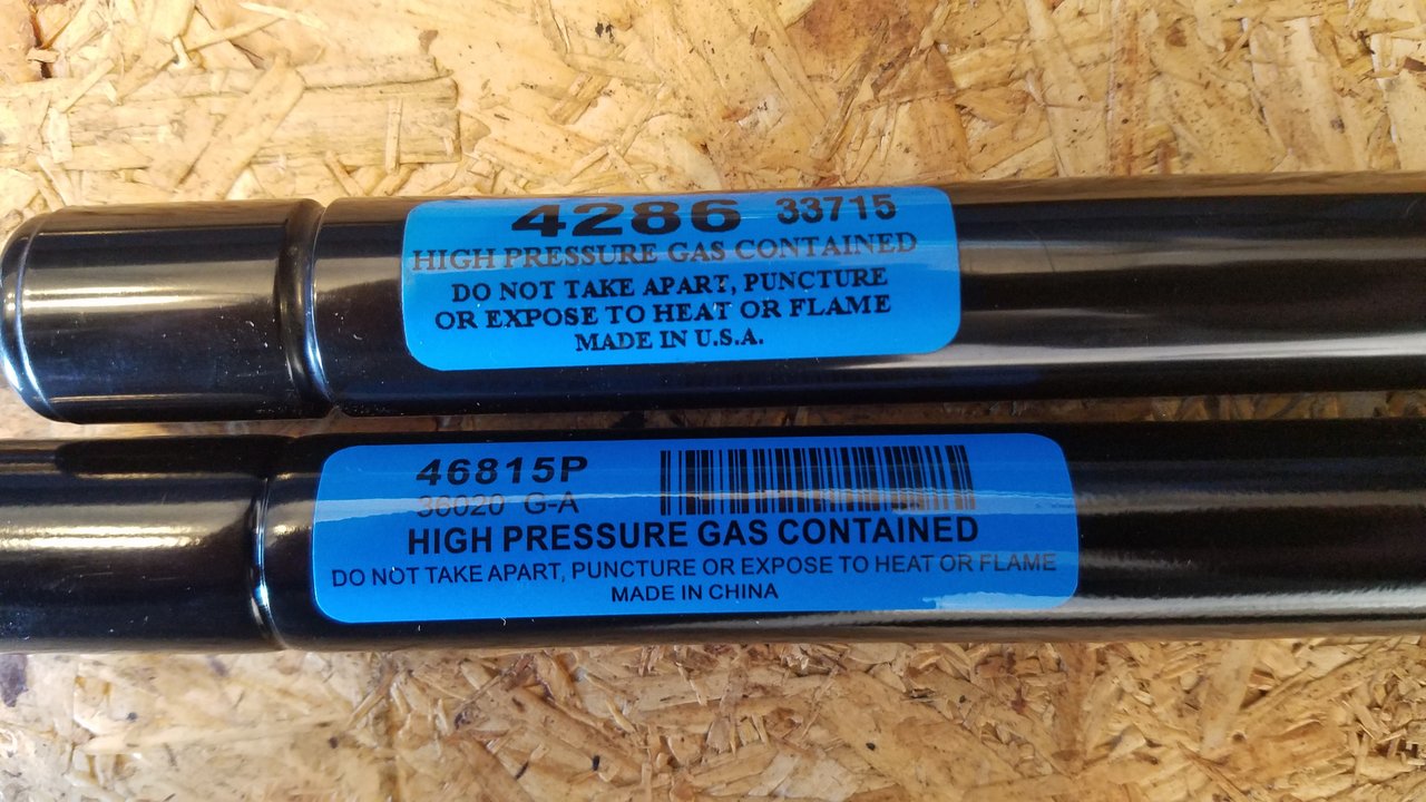

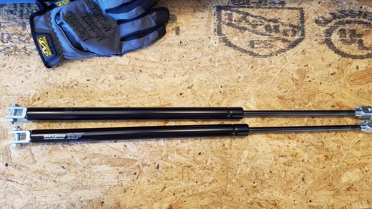

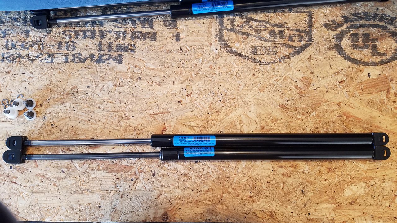

Sent these "MaxPow" rear hatch struts I just installed back to Amazon, after making the mistake of trusting Amazon reviews because I couldn't be bothered doing the proper research.
After reading the forum like I should have done, I got these StrongArm 6815 which I'm happy with. I like them better than the worn out StrongArm 4286 I had before because they work better in the cold and open well with the rear window down. It looks like they are simply 4286s with slightly longer gas cylinders. They are made in China now though. I had to squash the end brackets very slightly in a vice to allow the E-clips on to the pins properly otherwise no probs.

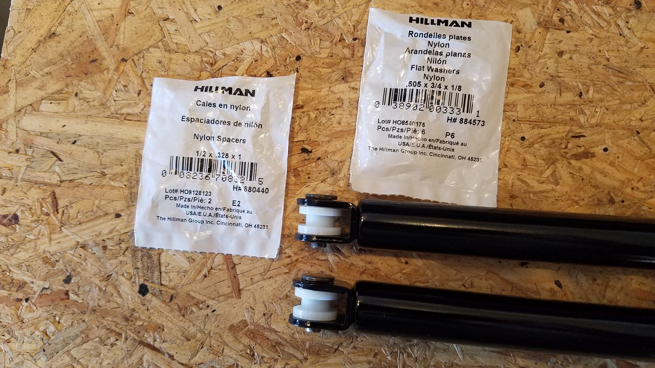

The obligatory T4R approved nylon bushings from Lowes. Don't bother with Menards and Home Depot go straight to lowes for those 1/8" thick washers. I tried cutting these with a small swing around tubing cutter with little success so used the vice and hacksaw method and fine tuned with a file.

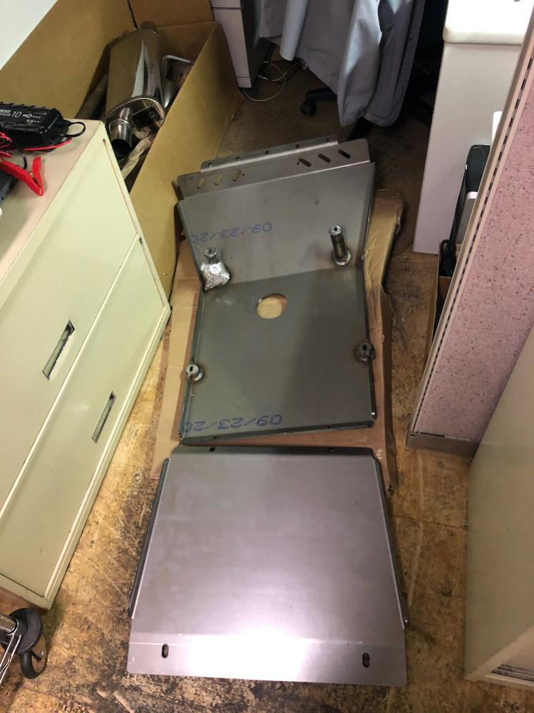

Laid hands on skids
Not so much what I did today, but getting actual hands on a set of engine and trans skids is 90% of the battle. They quoted a 4-6 week lead time and they came in just under 4 weeks - not bad. Now to prime, paint, and bolt up. These 4XI skids and the Shrockworks sliders make the rig a lot more ready for some serious off-road low-riding. This set is HEAVY at nearly 70lbs.
MF Overland kit in pic as well - ready to go on this weekend, too.
how easy/difficult did you find this installation? i’ve yet to do work myself on my 99 4R that i bought a few months ago but i want to start with a similar project, so curious how to know how you found it.

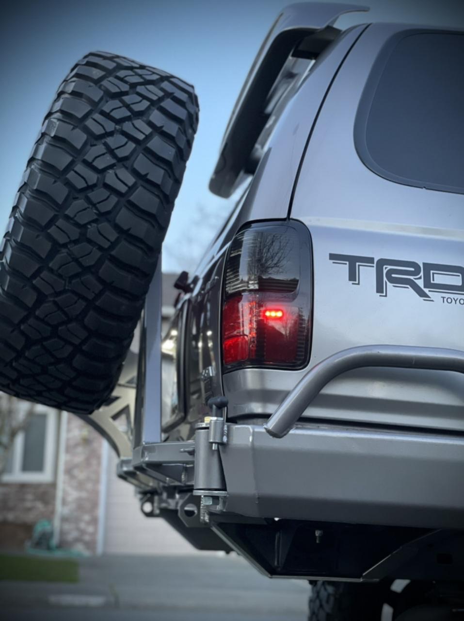

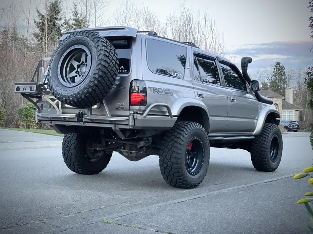

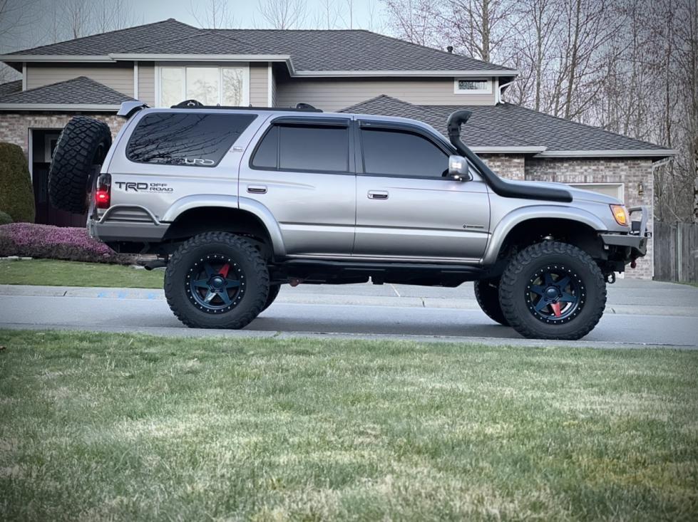

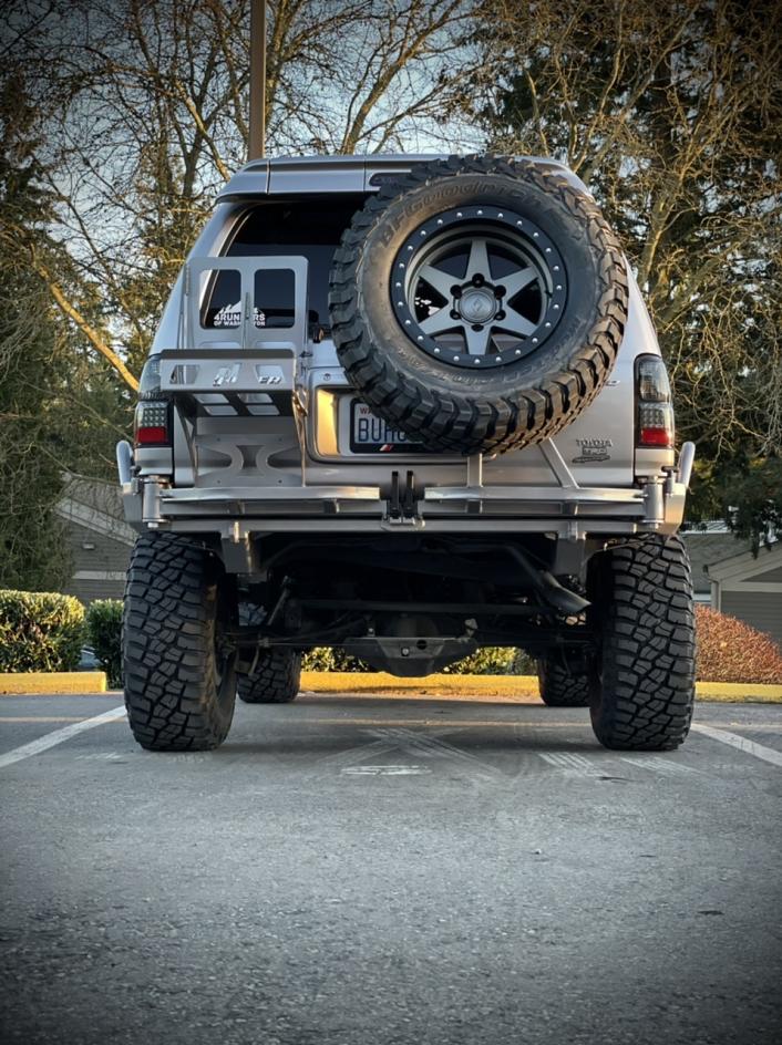

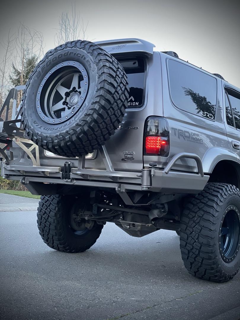

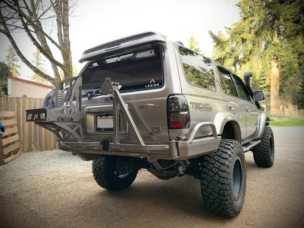

Yesterday Integrated metalworks installed a Nguyen Works dual swingout powder coated color matched Thundercloud Metallic. Had the spare tire balanced and mounted at Discount tire today.
SCS BR6
Matte Gunmetal spare
Stealth Blue all around
17x9” -38 offset
BFG MT KM3 285/70/17
