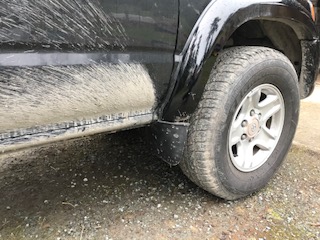

Installed front mudflaps after i hacked them up to fit. I think they look alright though with a little weather stripping to make it flush with the fender flares.

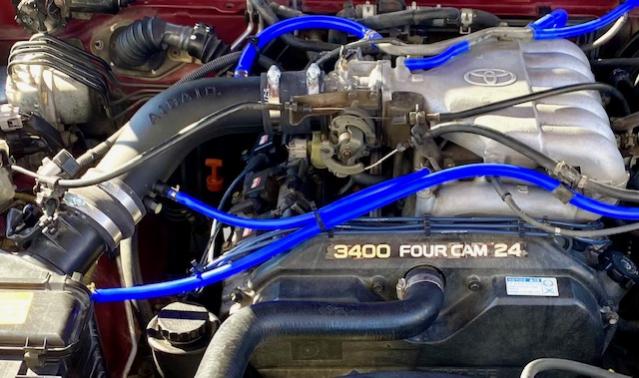

Replaced some more hoses, took out the factory intake silencer and swapped in this airraid tube. Frees up a lot of space in the engine bay.

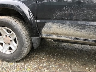

Did the passenger side first and ended up with a gap so i made sure to take by time on the drivers side. Happy with how it turned out! At least on the LH Side lol
