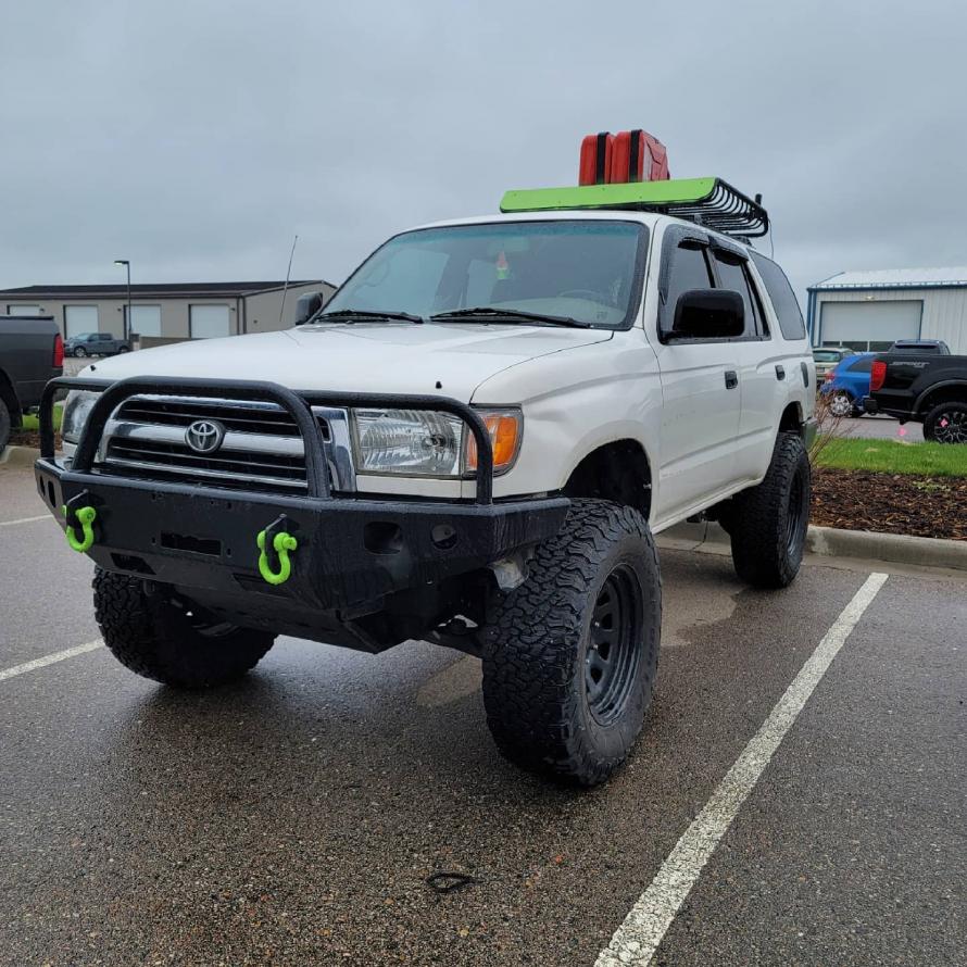

Reattached the roof rack after a little paint and mounting the gas can holder. next part of it is to mount my traction boards to it with a little ghetto-rigging. it'll be sturdy af though. Need to replace headlights back to original, remove the spare tire from under the rear (I have the new spare in the cabin). Small items and then I think it will be done...for now. I'm heading to Moab in a couple weeks for its maiden voyage so that'll be fun :)
