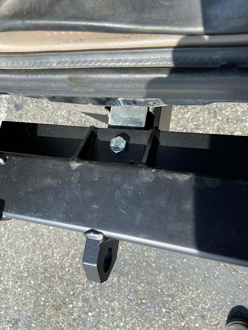

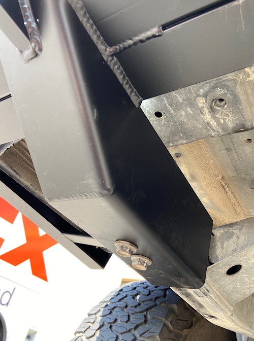

I was thinking the same rear, could you take some photos of how it mounted?
It only uses 3 bolts on each side of the frame. The 2 rear most factory ones underneath, and one that you have to drill the top of the frame to add for the 3rd bolt. You do have to cut a small triangle shaped piece off the back of the frame to clear the angled part of the mounting plate.

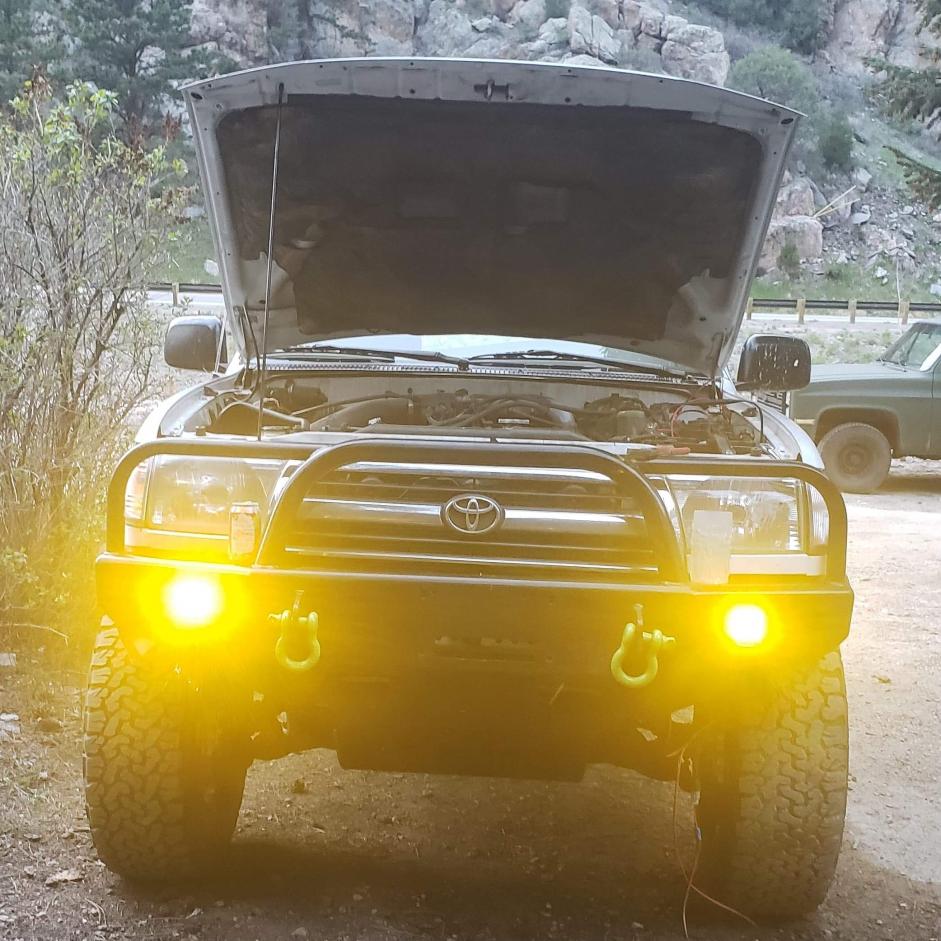

Installed spot lights, (they're getting the amber taken off and moved to the center) and bought fogs today and ordered LEDs for signals. Those will arrive monday. It will be ready for Moab come Thursday when I leave hahaha

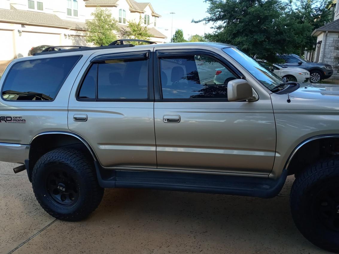

[MENTION=424911]13rown[/MENTION] nice Rack! Looked at those but I ordered a Prinsu for the $avings. In the meantime, also did some silly little Mods that made a surprising difference.
1. Steering wheels wrap ($12.00 and dressed the interior up big time).
2. AVS window Vents installed.
3. Borla 40665 muffler welded in (I highly recommend)!
