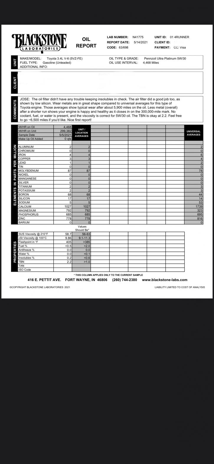

Received my first Blackstone UOA report! I literally cannot believe how incredible my first report reads. I am so incredibly happy about it and wanted to share it with others. Not sure if there’s an official UOA thread on here, but I haven’t found one yet

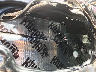

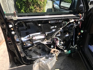

Yesterday I upgraded my front speakers to Kicker 46CSC654s, just something decent on a budget to improve my listening experience. While I was in there I sound deadened the front doors with kilmat. Can't speak to the effect yet but I'll be driving to work monday and am excited to test it out! I was in a hurry and baking in the sun so I only got a couple photos.

This is inspiring. I love it.

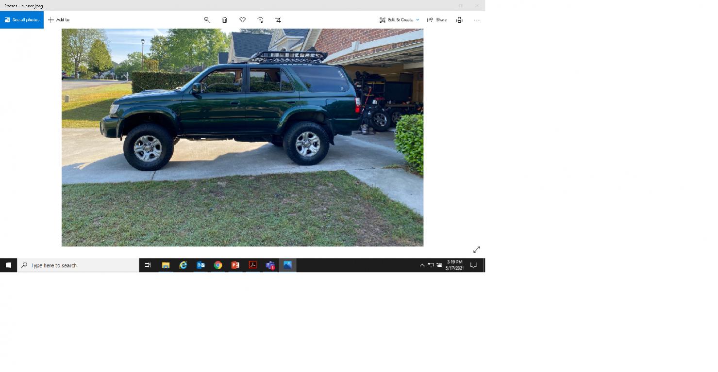

Over the past few weeks, OEM LBJ’s, TBU (OEM Rotors and pads, NAPA total eclipse calipers 231mm), Energy Suspension sway bar bushings and end link bushings, 4Crawler diff drop.

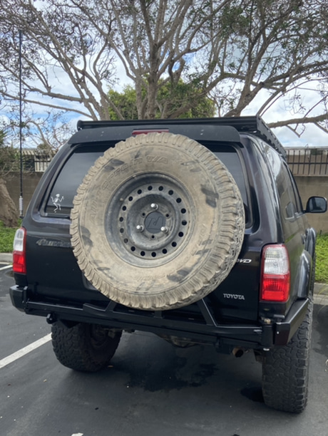

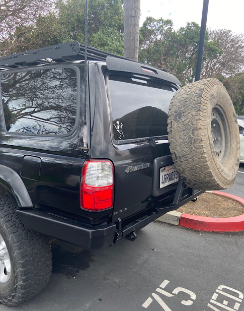

I installed a Nguyen Works rear swing out bumper yesterday. Nice to get that spare off of the panhard bar finally.

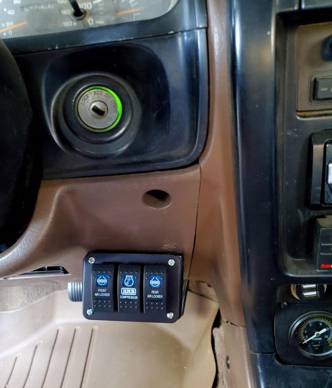

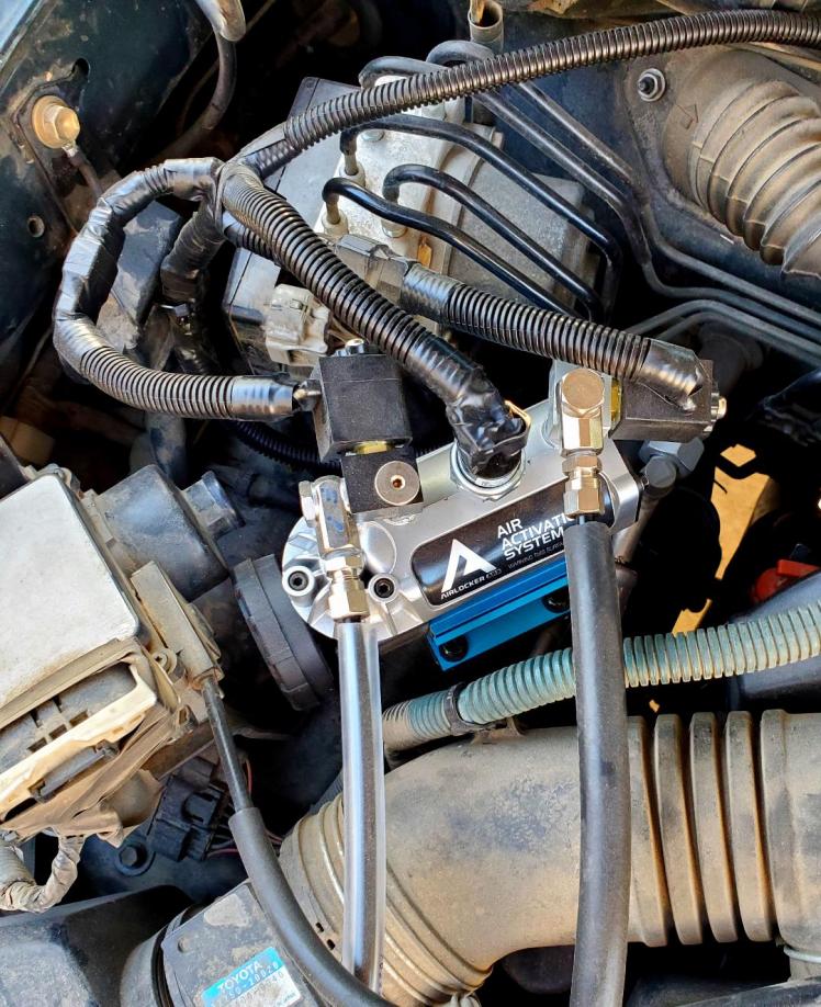

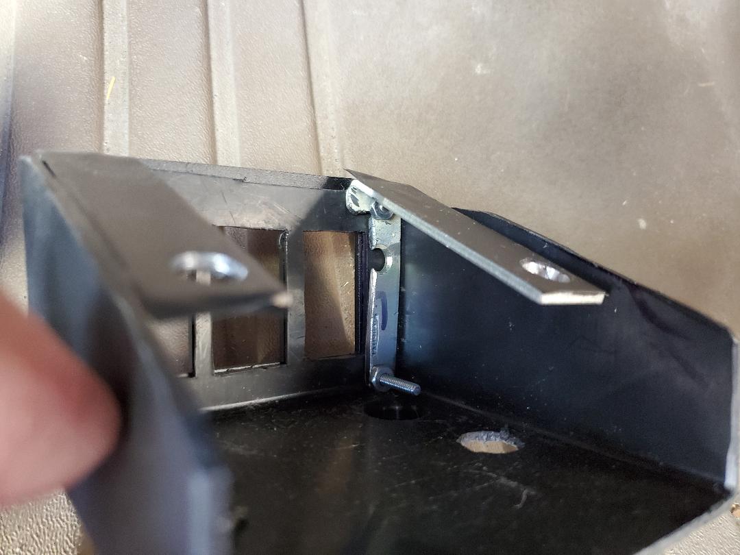

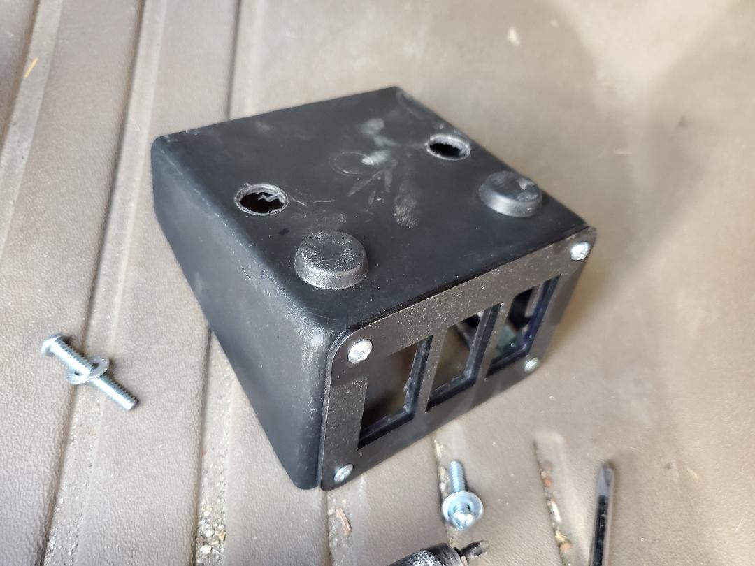

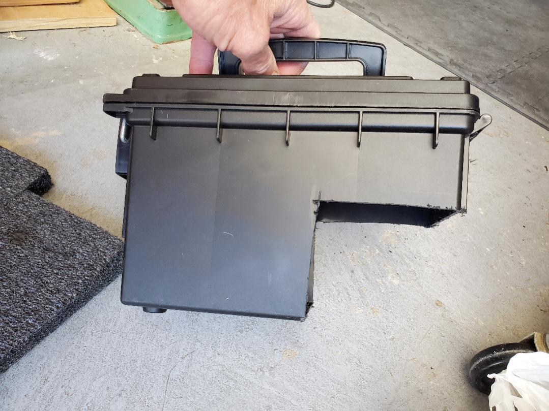

Finally got everything hooked up after getting the wrong wiring harness, ARB claimed it had been modified even though it was factory sealed and shrink wrapped, then had a bad seal in the front locker even though it wasn't in the recall. Improvised a surface mount from a $4 walmart ammo box. Still waiting on the refund from ARB for the R&R labor, they said 4-6 weeks.
