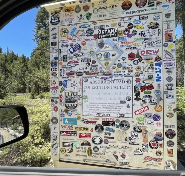

Absorbent pads, though.....learn something every day.

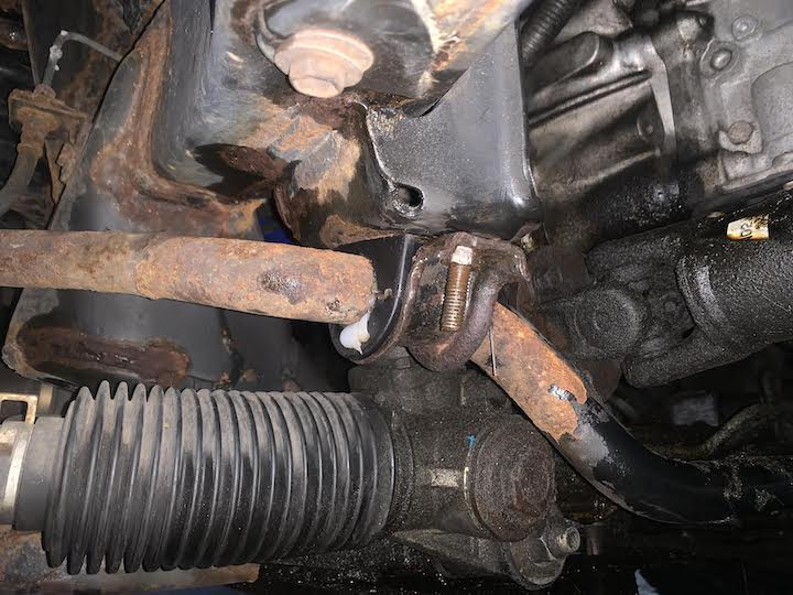

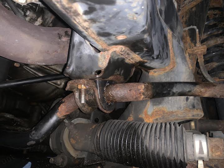

Installed the front sway bar bushings... What a f****** mess to install as every single bolt is rusty and both bolts on the passenger side holding in the bracket sheared off. I'm glad I ordered new hardware for the brackets.
Driving it with the new bushings, I could immediately tell the difference. I can corner with confidence now and it's a much stable ride. These are Energy Suspension Bushings and they are great! I didn't have time for the end link bushings so thats another day
