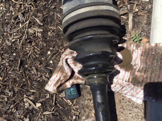

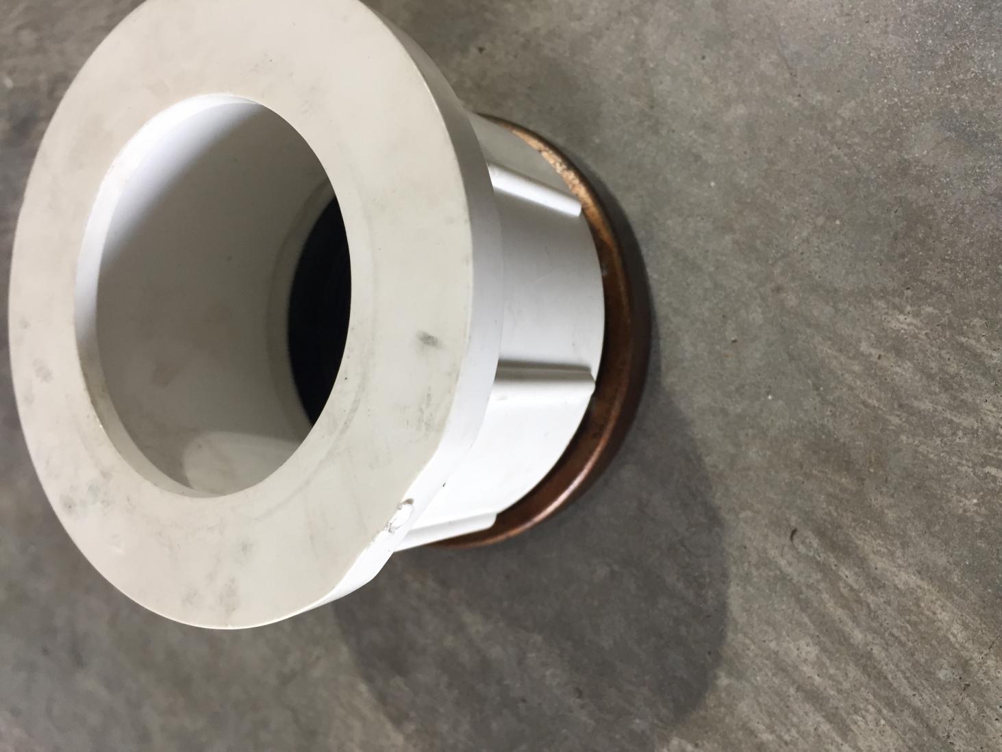

Replaced my passenger side CV axel

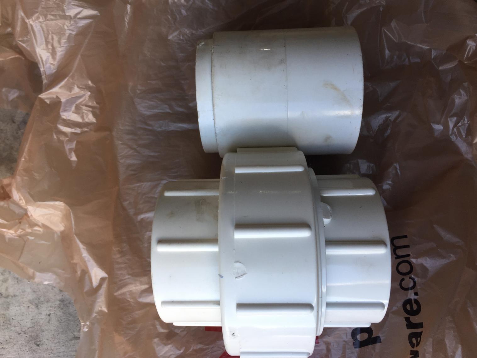

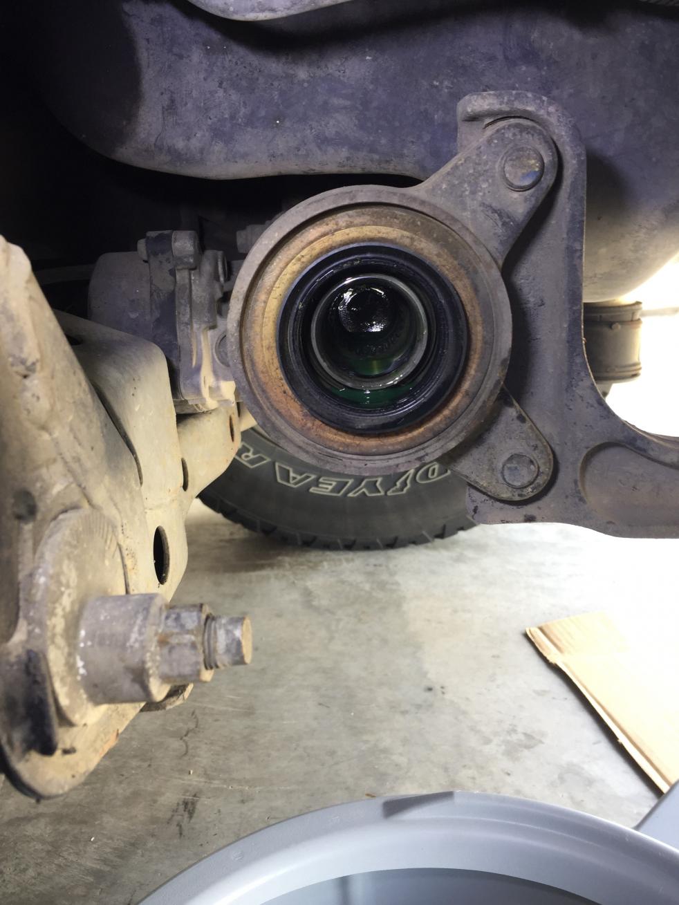

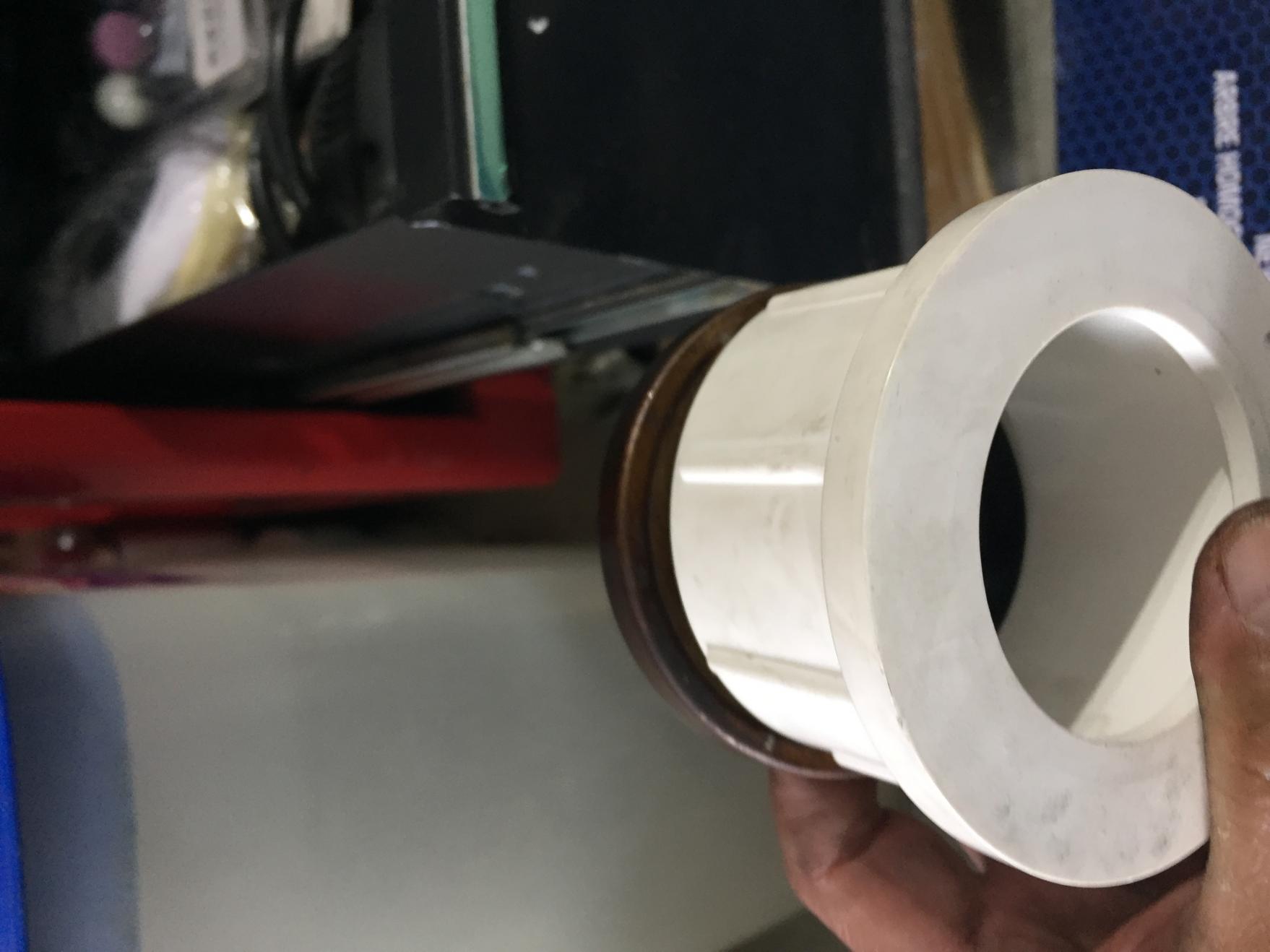

A few days ago I noticed an oil leak under the right front wheel a quick inspection found a torn CV booth. I had called a local shop to get them to do the job but I was quoted $500 so I decided to just spent $184 on a new CV axel, inner seal, oil seal removal tool, a set o of 3/8” drive Allen sockets and a 2”PVC union to properly seat the new seal. I had used PVC coupling in the past to install new camshaft and front crank oil seal. I want to share this with the greater community .
thanks for sharing that, I knew there had to be some size pvc that would fit the seal well....now if it just had a cap so when you smack it in the center to drive the seal in
again, thanks
Got front tires and an alignment. Over the past two weekends I replaced the upper/lower ball joints, inner/outer tie rods and rack and pinion bushings (blown out, the rack would move side to side). The loose bushings and bad ball joints caused a lot of wear on the tires. Got a new battery too. Good day. I’m doing the timing belt, ignition packs and drive belts next week
I was able to just tap in the seal then when 80% was seated I just used more force. I check each time to make sure it was flush since the old one was also flush. If you want a cap just trace the surface on a 3/8” plywood & cut with a jog saw and glue in on or drill 2 small holes and use a counter sunk screw.
