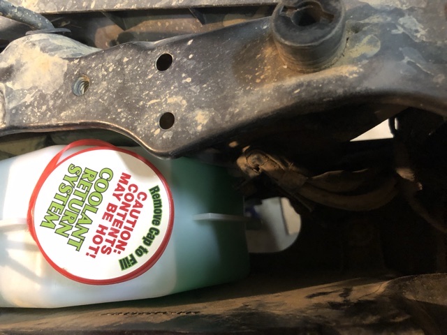

I combined my blinker lights with my marker lights to have a running light/blinker in one. And replaced my washer fluid reservoir with a coolant overflow, all in preparation for my AOR bumper that should be showing up soon!!!

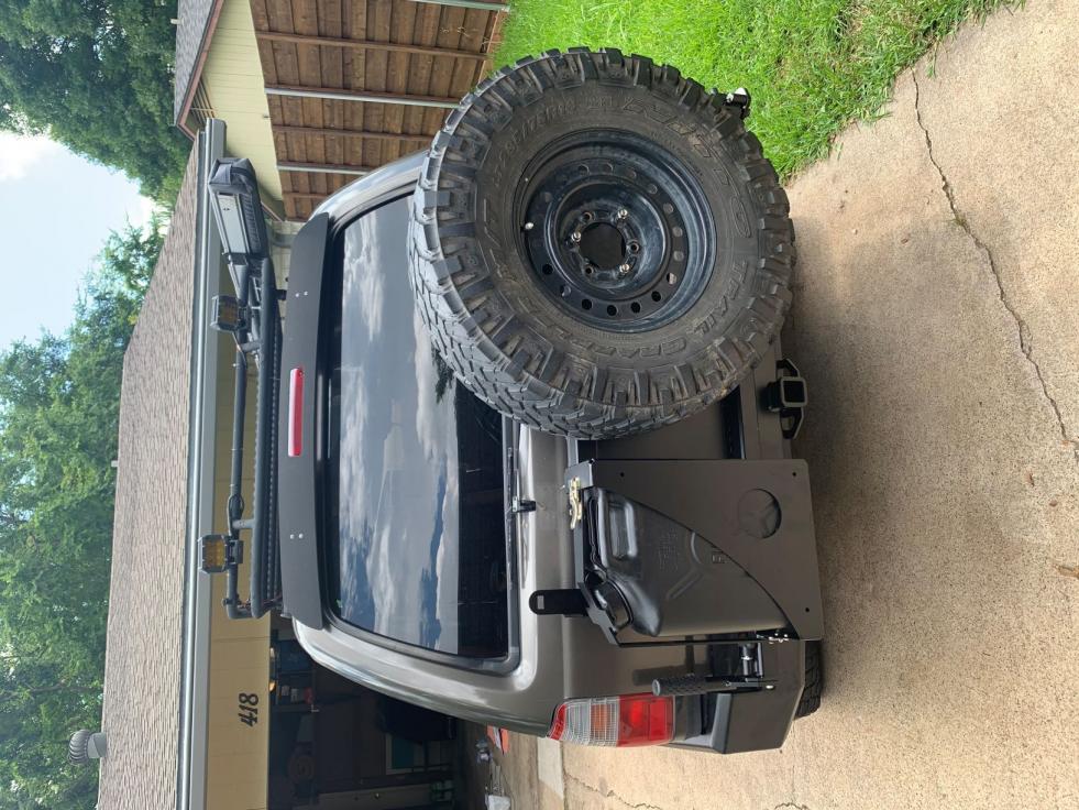

4x Innovations Swingout Install
Finally added my 4x Innovations swingout bumper. Super easy install and so far loving it.
Cheers to no longer having to carry my tire on the roof rack. (My garage especially thanks me)

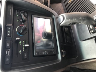

Finally got around to installing a new headunit and antenna. I went with a taco whip and a Sony XAV-AX1000. The HD has been on backorder from crutchfield for at least a month so i was getting pretty antsy to tackle this considering i've had the antenna and assembly for a while and wanted to get it all done at the same time.
Worst part of this job was pulling out the old antenna believe it or not. I was yanking on it and broke it off inside the firewall so i had to spend 30 minutes or so fishing it out with a makeshift hook that i fashioned from the old antenna, lol. I also tied a string onto what i thought was the antenna wire but turned out i got that wrong so i had to fanagle the wire back up and retie it then pull it out. Regardless of my mishaps, all my wiring went smooth, no shorts and i'm getting power so i'm super stoked about that. This is the last big mod i'm doing for a while (I think...). This Sony paired with some new Kicker speakers all around and the front and rear doors sound deadened are going to sound great! :rockon:

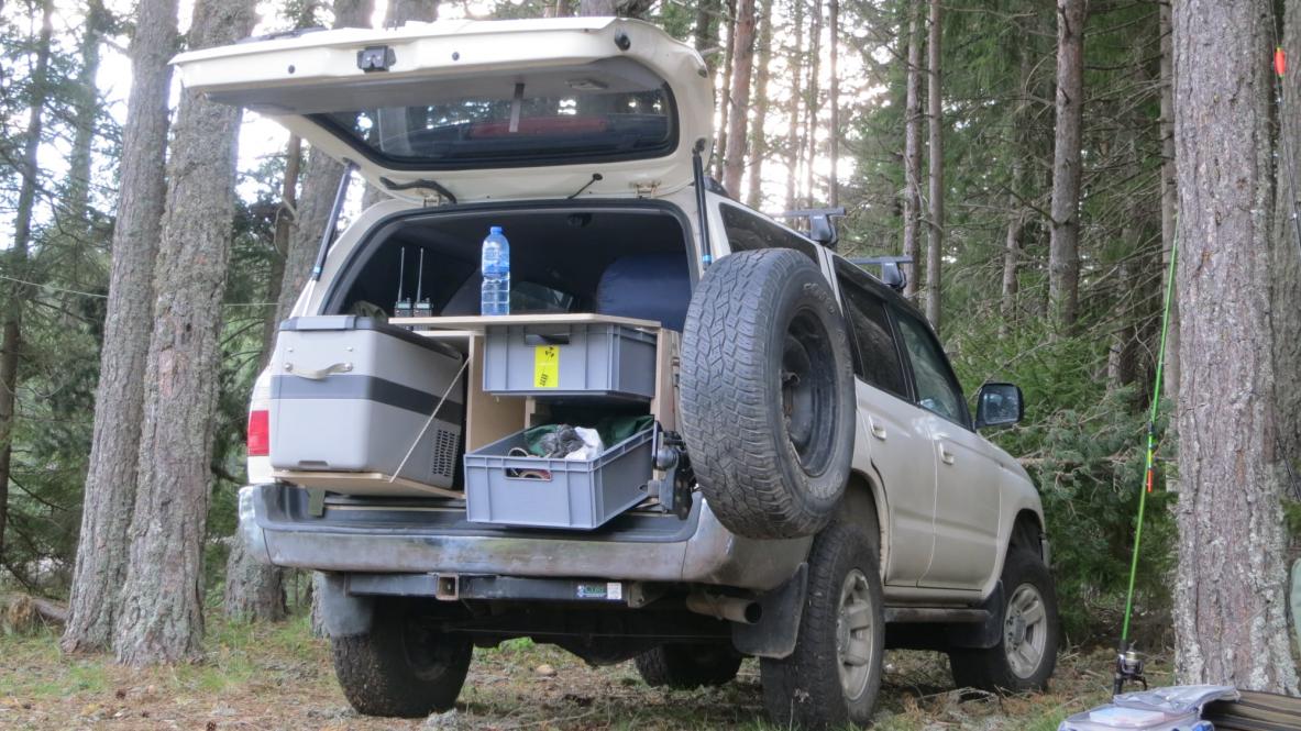

Testing my new fridge setup! Holds pretty good!
Almost autonomous!

Heck yeah - Bulgaria! What is the minimalist spare tire swing-out setup you seem to have there? I didn't see it in your photos....
