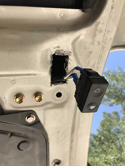

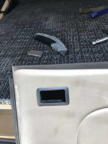

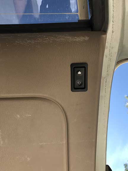

Installed rear window switch for camping. Turned out great!

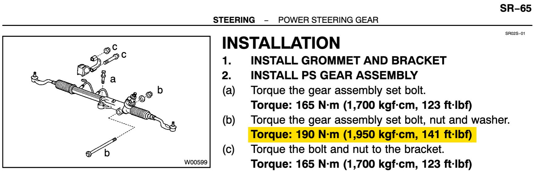

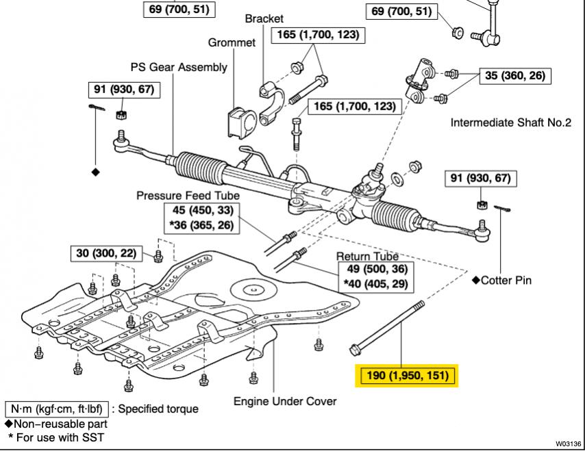

Now I'm worried. I'm looking at a 1998 4Runner FSM. On the rack components page it shows 151 ft/lbf for that driver's side bolt.
On the installation page it shows 141 ft/lbf.
I cranked that sucker to 151. The Nm and kgf numbers are the same for both so I'm assuming the 151 is an actual typo since that newton meter number does convert to about 141.
Am I okay just backing it off or did I possibly compromise the bushing or do some other sort of damage?
EDIT: sorry about the attachment size. I'm just full of errors today.

That bolts should torque up on a steel sleeve, not the bushing itself. The difference from 141 to 151 is a rounding error for a parts store torque wrench anyway — don’t worry about it!

Thanks, I completely forgot about that sleeve. I happened to notice that discrepancy and started thinking about LBJ bolts.

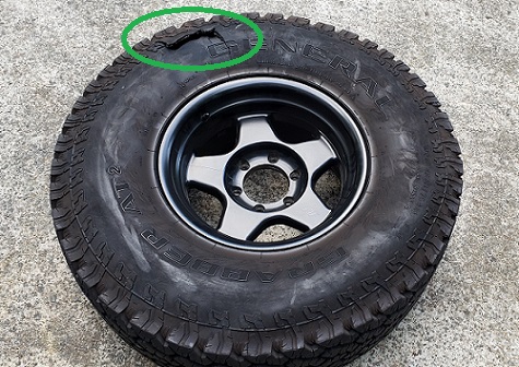

I've considered relying on my plug kit & portable compressor since I have 35s & my spare is a 31. There were even periods where I had leave the spare off when I knew I was going to be doing rear suspension work over multiple weekends but would feel slightly uneasy about not having any type of spare so I would eventually put it back on. A couple months ago a semi truck clipped my rear tire blowing it out making my plug kit useless. I called a tow truck because I was on the side of the interstate during traffic. When the police arrived they escorted me to a safer spot. I decided to just put on my spare since I was further away from traffic. I put my spare in the front & my front 35 in the rear. To my knowledge I don't think it would have mattered too much in 2wd and think it would have been more of an issue in 4WD but did it anyway. Three 35s & one 31 looked goofy but it got me home. It was a good thing b/c I later saw a message from the tow company saying that they weren't going to be able to make it to my location.
Lesson learned for me is that having a spare, plug kit, compressor, etc are all good things to have in a daily driver.

as shown above,...a plug kit would not have done a thing for that. My daughet in law got a nail that went almost sideways into the tread, and it was impossible to plug ( we tried).
At least haveing the wrong size spare will get you home, in 2wd.
