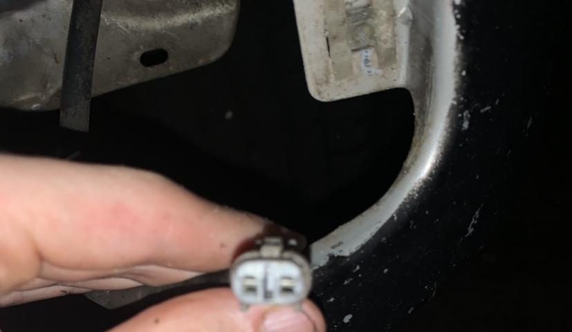

I am going to replace the wiring pigtail connectir for my blinkers on the bumper
I have a 1997 4Runner the wires that went to the right turn signal light in the bumper melted i replaced the blinker assembly but I had to tape the wires inside the connector due to not finding the pigtail I need help finding the model/part number of this connector
Is it the plastic connector housing that's broken? If that's the case, there should be a 5 digit number on the housing. Put 90980 before it & that's the part number for the housing. You can use a depinning tool to remove the old housing & install the new one but when I did it the old housing started to break apart.

It was the wires that melted? How'd it happen?

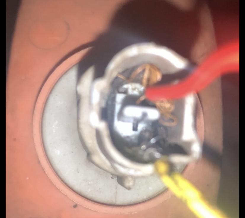

The vehicle has electrical issues and a high voltage went through the entire blinker fuse when I had right turn signal on I fixed the short it was a wire shorting to the frame of the chassis of the vehicle.
It is the wire shown in the picture I attached
I have no way of plugging in the blinker so I had to tape the wires to the blinker pins on the assembly the whole wire melted and the connector melted to the old assembly so I had to cut it and add some new wires but I have no pigtail for the blinker now this cable and connector has no numbers on it anywhere

I need another one of these shown in this image the wires and pigtail so I can plug the pigtail in but this one is already sold but when I look at manufacturer part number on listing it shows custom made subaru connector which toyota shares but it has no number
I have no blinker pigtail to plug in so I had to tape the wires inside the connector on the assembly every time I hit a pothole or a bump the wires move and my blinker stops working
If you see the image attached this is how I had to tape my wires to my blinker
I need the connector same one as show on the ebay link every little bump the tape comes loose and it is annoying What I did is I put wires in there like it is shown in image then put tape inside and around it to hold the wires in place but it doesnt do a good job

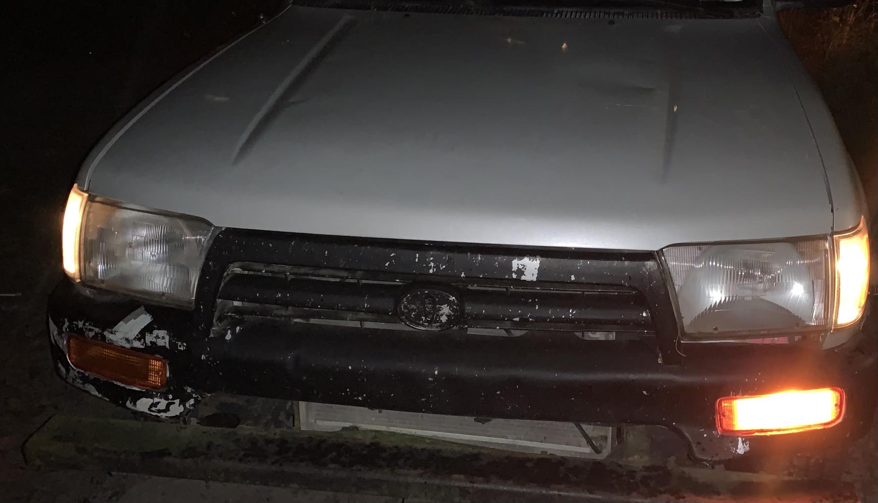

So All I have is a left turn signal not a right one you can see the hazard light is on only one side lights up

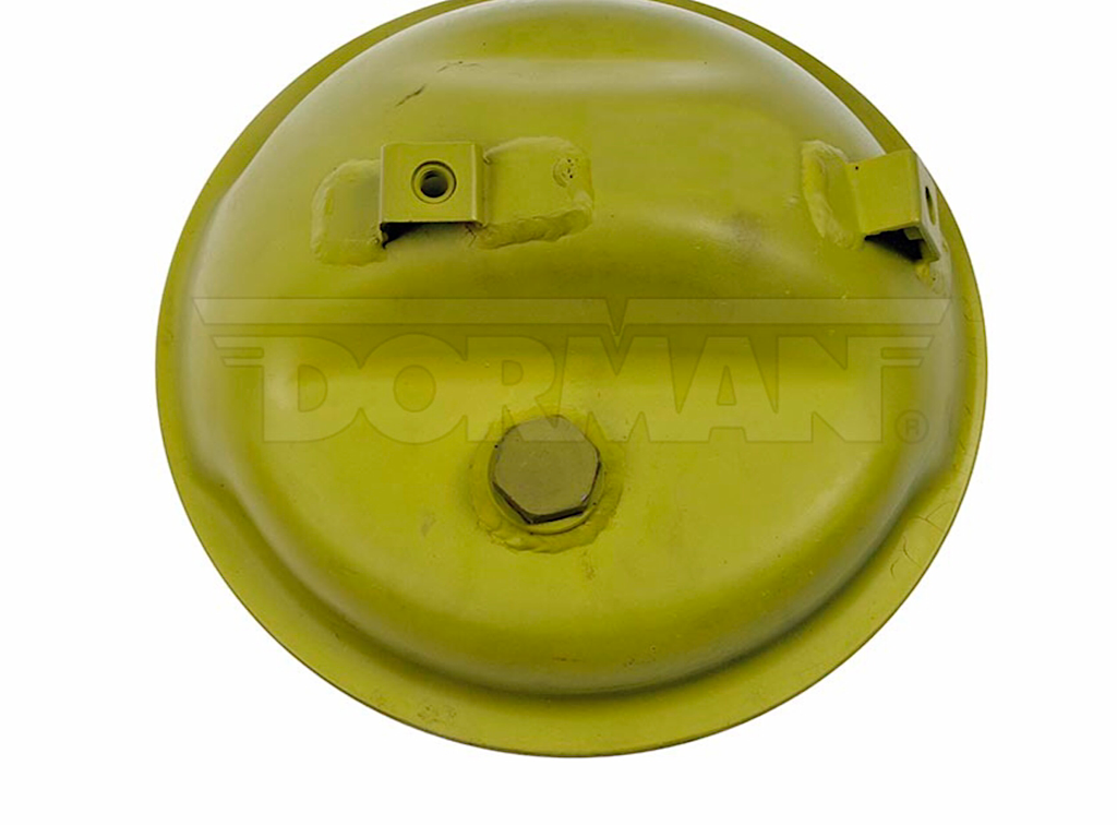

Over the weekend I discovered gear oil leaking from my rear differential. This is something that I was expecting would happen. The thin sheet metal that forms the cover over the back of the differential has rusted to the point that there in now a leak from a pin hole rust-through. I even bought a weld-on replacement cover a few months ago in anticipation of this day.

When I get the axle assembly out of the truck I’m going to totally strip it so that I can cut the old cover off and get the whole works over to a welder to get that new cover installed.

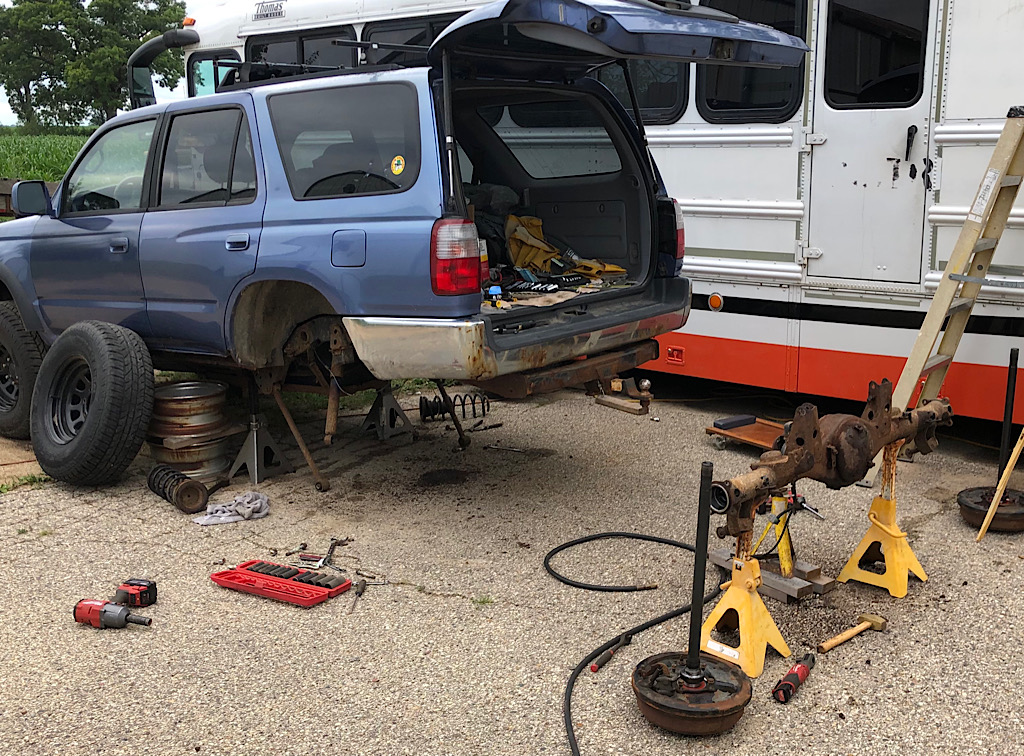

I pulled the rear axle assembly so I can weld a replacement back cover on it to repair an oil leak. Rust sucks. Was surprised that the bolts that hold the suspension links came out so easily. I expected them to be rusted solid like the leaf spring eye bolts on my 1st gen 4runners. In fact I only broke one bolt on the whole job so far, a small one that secured a brake line bracket.
Need to install some shocks, springs, brake lines and sway bar links while I’ve got it all apart. Maybe suspension links too. Definitely going to clean up the axle housing and paint it.

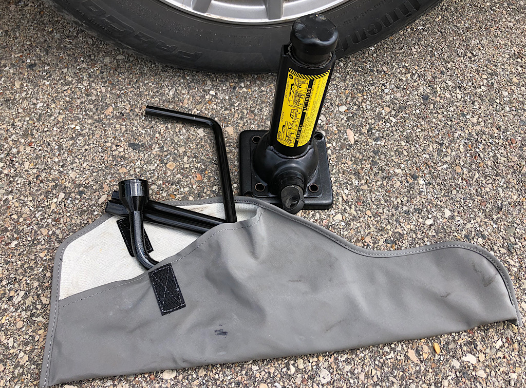

When I bought my 4Runner a couple years ago I didn’t notice that the OEM jack and the tire change tool kit were missing. So yesterday when I wanted to lower my spare tire to get it out of the way to do some work on the rear axle I was reminded that I didn’t have those items. So I made a call to my friendly local auto wrecker to inquire about the availability of the stuff. Well it turned out that they had a kit from a Sequoia that they would let me have for $40. I think that’s a screaming deal. I see jacks alone going for $75 on eBay, and the tool kit for similar. I have been finding some crazy deals on 3rd GEN parts lately.
