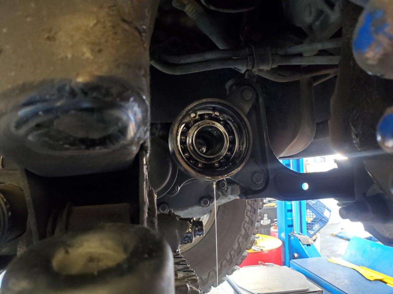

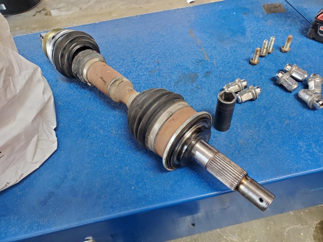

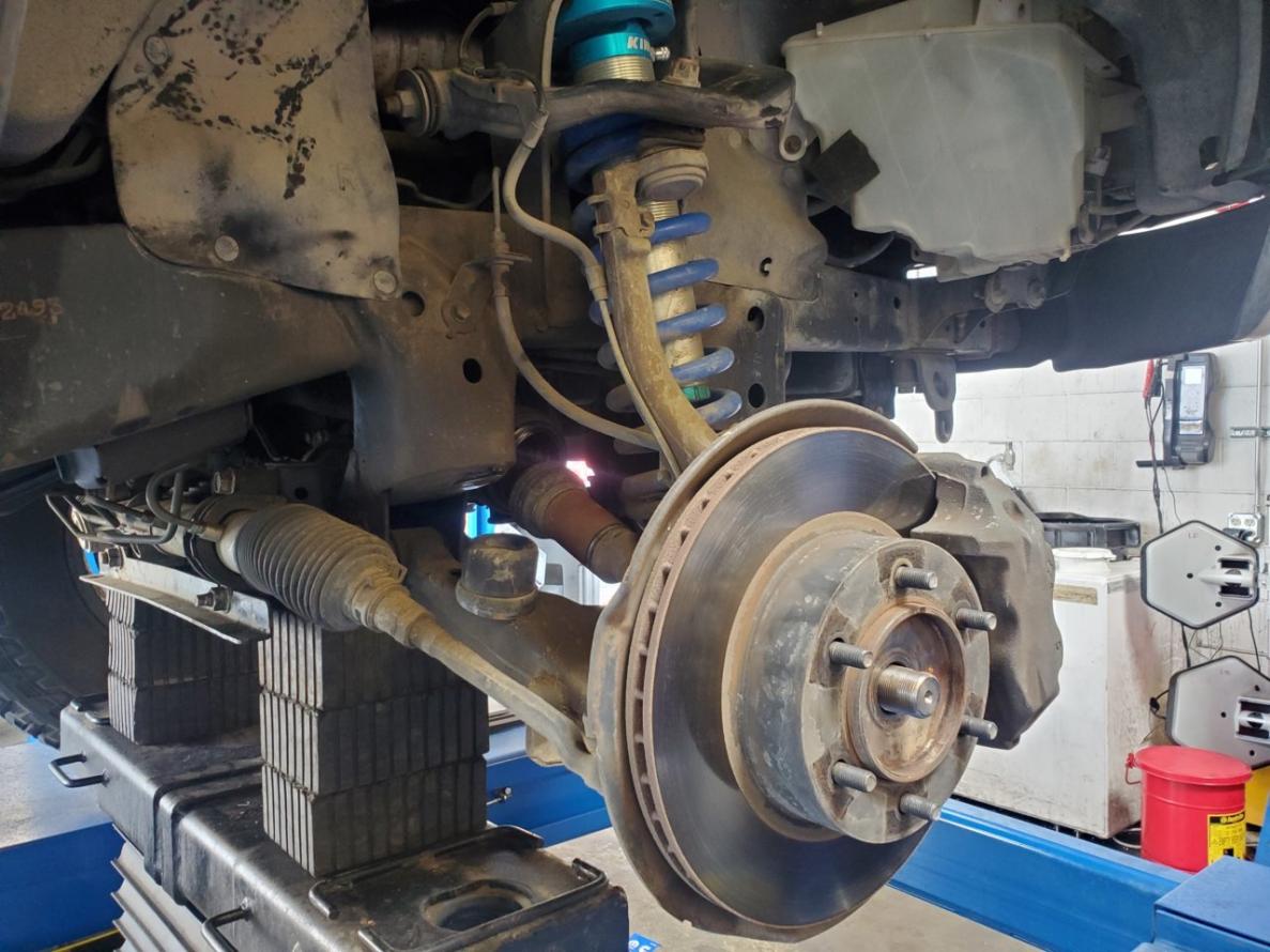

Replaced my CV axle seal; I'll need to replace the CV axles too (both) as the boots are torn but that's for another day.

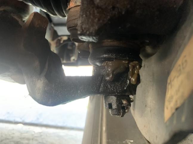

I replaced my steering rack bushings today with the Energy Suspension Kit which made my steering much more responsive which was amazing. While I was under there I greased all the zerk fittings from the axle shaft which will make me sleep at night good (first time greased in 10+ years). Inspecting both lower ball joints while I was under there, I found the right joint leaking grease out the boot which made me realize I need to replace at least the right side ASAP. Other than that it's been a great day :)
