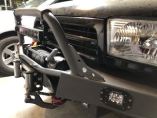

Clocked, mounted, and relocated the control box for my Badlands 9k winch.. this thing was $290 on sale. We’ll see how long it lasts…

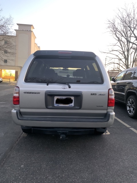

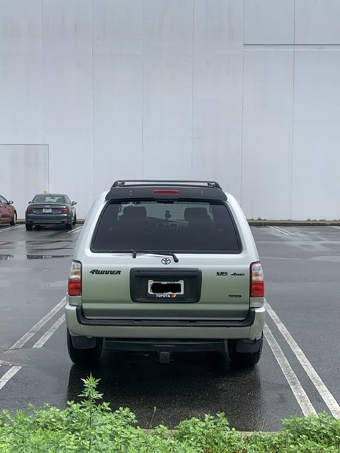

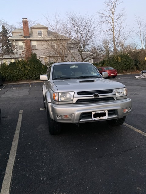

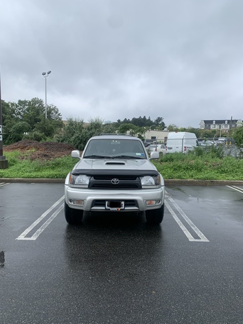

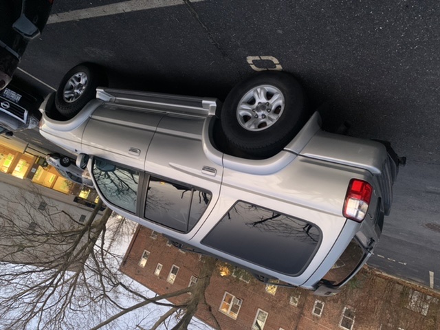

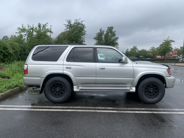

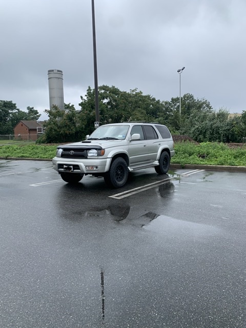

Before and after
Added the bug deflector, some new headlight housings , black grille, license plate frame , plasti dipped plastic trim pieces on the tailgate black because they were faded pretty bad, and just recently added 265/75/r16 falcon wildpeaks with 16x8 pro comps. A tad of rubbing , may take the running boards off next .

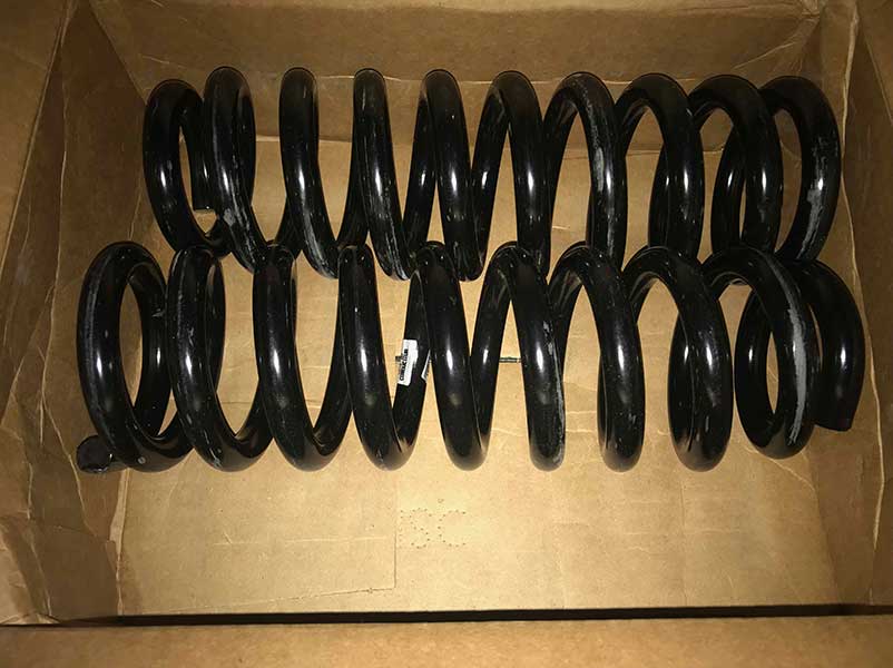

Replaced Rear Shocks and Springs
The front and rear AC/DELCO coils finally showed up from RockAuto today. KYB shocks/struts have been here for a week. I'd planned on doing the fronts first since I assumed the rears will be a bigger improvement but I'm still working up the courage to deal with spring compressors.
Had a hell of a time getting the driver's side rear shock out. Was very glad I bought flex head ratchets and wrenches last week (just in case). It would've been nice if KYBs had the allen head to stabilize it. I made do with a pipe wrench.
Got everything back together and double checked all my notes to make sure I hadn't forgotten anything and went for a test drive. I was enjoying the new ride, feeling quite proud of myself but began to worry when I started to hear a rattling metal sound coming from the back when I hit the brakes, sometimes when I punched the gas, too. I thought for sure something hadn't gotten tightened properly. It didn't sound like the metal folding chairs I had in the back but I slowly drove home to take them out and see if that was the culprit.
Turns out I'd forgotten that I'd put the box with the front coils in the back. Dumbass.
One more job completed that I never thought I'd do myself. Thanks T4R.ORG (and Timmy)!
