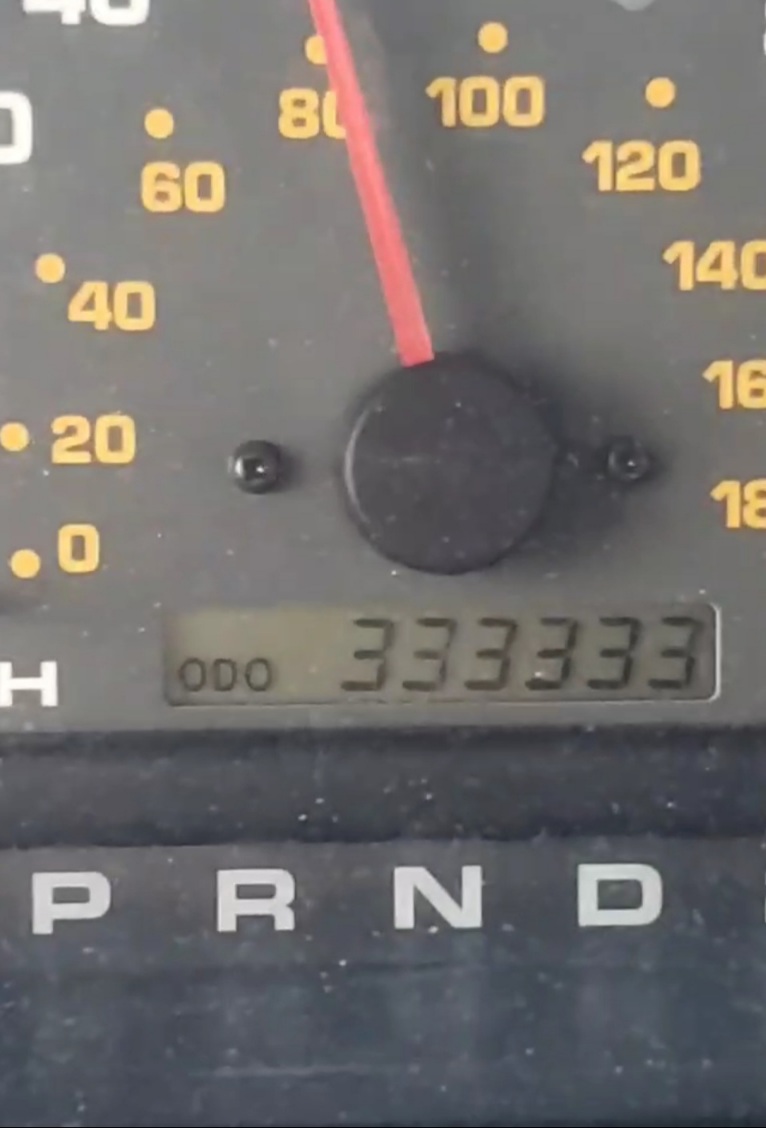

The elite 300k club
Hit the angel number 333,333 a couple days ago.:flypig:

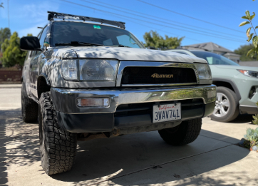

Finished up my satoshi mod...took me way too long, but am pleased with how it turned out! Going to replace the rest of my badges with the gold ones I picked out of the junkyard. Probably will remove the back '4Runner' one, perhaps put the small Toyota logo centered on the license plate molding instead.

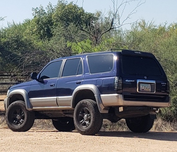

Installed the Dobinson lift and JBA UCAs, so much bling!
Also decided to spruce up my flat black Pro Comp wheels. After trying a few colors, I like the Rustoleum Hammered Gray, that looks like a keeper.
Before:
After:
Still need to figure something out for centercaps.
