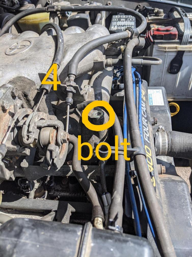

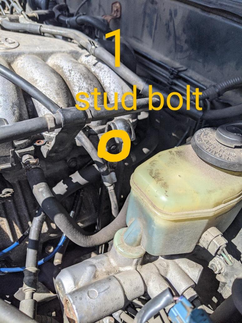

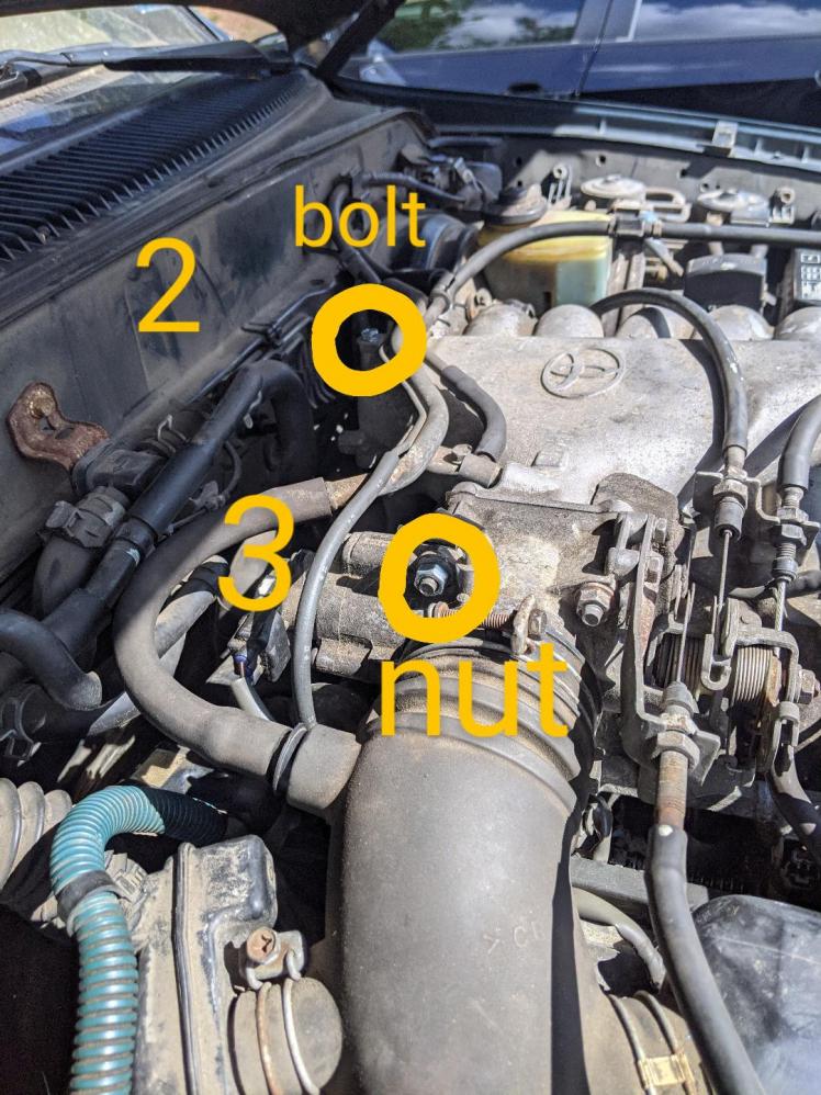

I hired someone from craigslist to replace valve cover gasket and thermostat, he didn't install the ring gasket to the thermostat, I hope it will work, but the valve cover job is horrible horrible, because there are 4 missing bolts and nuts, and i missing stud, he said it's ok, the plenum cover is still secure, it was 1 wk ago, and I am still looking to buy the missing bults/nuts, I just can't find them, no more mobile mechanic !!!

1998 4Runner missing bolts and nuts, pleae HELP!!
I have been looking for these bolts and nuts for two weeks now, on and off, ordered a few from Toyota dealers, but they don't fit, I was unable to locate part number, can't find any diagram with part numbers. If you know the specs for these bolts and nuts shown in the photos, please help!!
