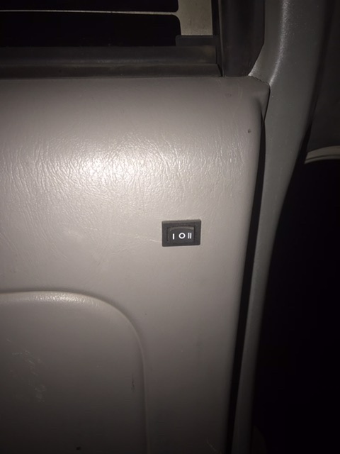

Lift gate window mod
Can’t believe I didn’t do this mod sooner. Only took about 20 minutes. Used a leftover switch from another vehicle I was working on last year. Soldered in the three wires at the window module and flushed the switch into the panel. Definitely going to make my solo camping trips more enjoyable!
