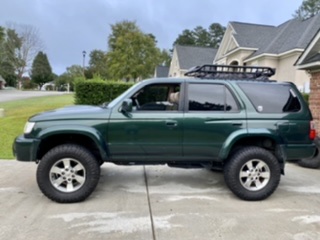

Went from 16’s to 17’s but thinking now I like 16’s better….love the Ridge Graps though!

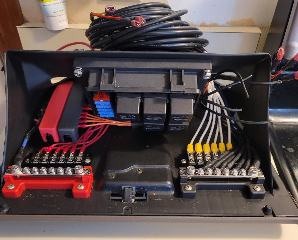

Fabricated a Glovebox Aux Electrical System
Thinking about doing another and selling. Package would consist of everything pictured completely wired fused and relayed circuits including: (6) prewired 2 pin sealed connectors for hooking up lights and other loads, (6) 3 pin sealed connectors for switches, 6 prewired 10' switch leads and quick disconnects for battery leads.
Would anyone be interested in this? What would you be willing to pay?
The idea is to be able to completely disconnect everything at the glovebox and remove if needed.
Pic for reference.
Thanks.
If anyone is interested PM for details. I'll need a couple weeks to source another glovebox to start the whole 'core' process. That way, if do DO want it, you'll get it 3-5 days after paying and just return your glovebox as a core.
I'll update with links to install video and demonstration.

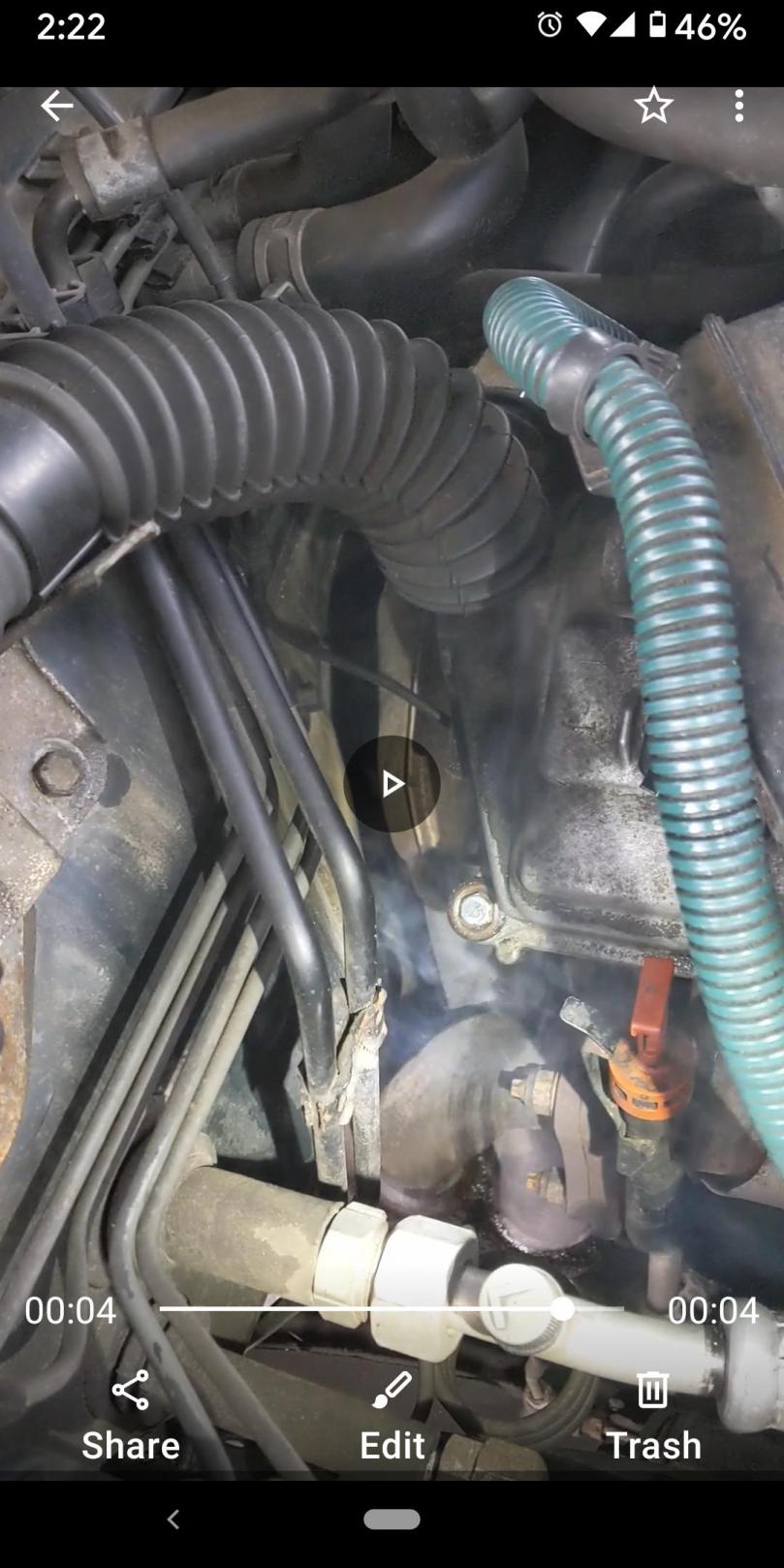

Smoke from engine near firewall passenger side, 1998 T4R.
I am at a loss here, got white smoke when cold start in the morning. Recently replaced valve cover gasket. Smell something burning but little smoke when driving, coolant/oil level all good, looks like droppings accumulated thru the night thus seeing smoke 20 seconds after cold start. Can someone point me to the right direction.

Cam plugs?
not sure, probably not, because smoke from passenger side near firewall, cam plug kind of middle ish
This guy circled in green:
Mine were leaking after a valve cover job (on both sides). Passenger side oil leak would roll down near the starter, but some would hit the header and smoke.
Photo is from after they were both replaced.
YMMV of course. Best of luck

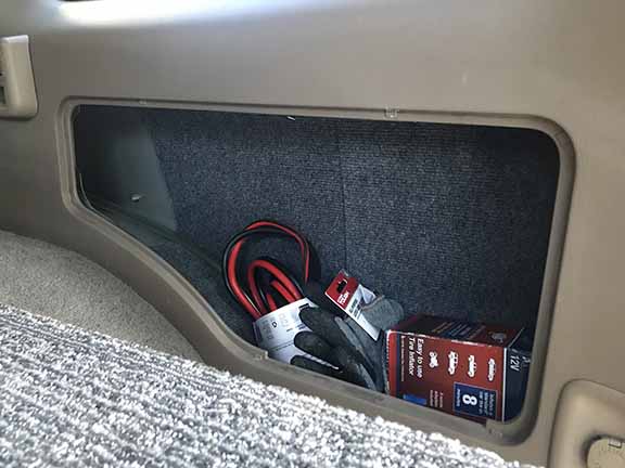

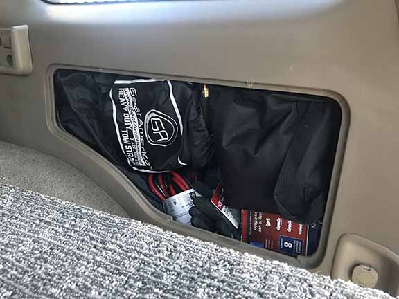

Rear cargo mod. Now I can fit my tow straps and folding solar panel in addition to what was in there originally
