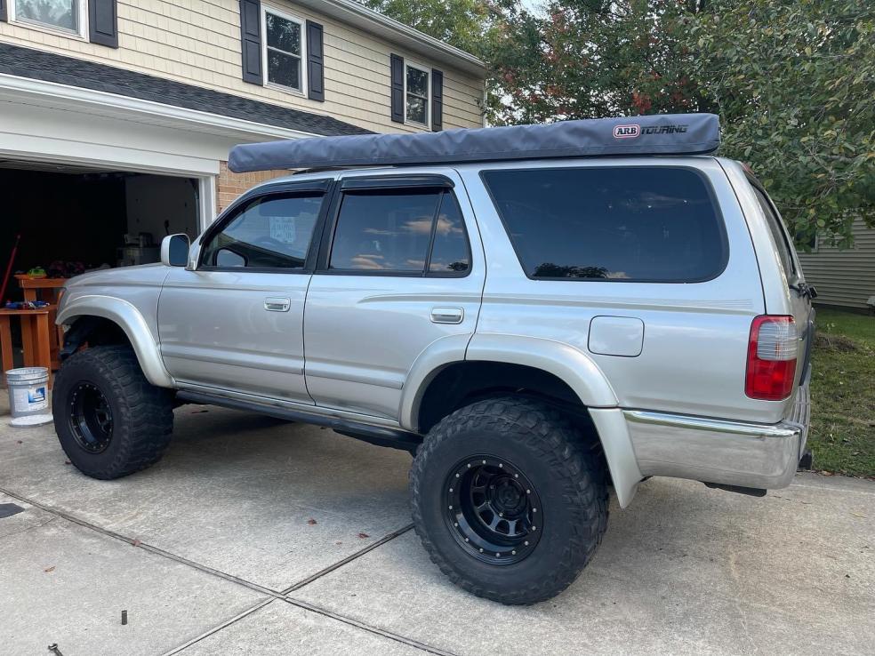

New member here. Thanks for the ad! Here’s my 00’. Just finished installing JBA’s UCA’s, energy lca bushings, and mounting my DIY 270 degree awning.
