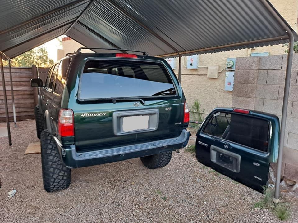

Scored at the junkyard this weekend. Pulled an almost perfect fully assembled tailgate , 01-02 tail lights, and full sport interior trim pieces. Also took off my roofrack.
