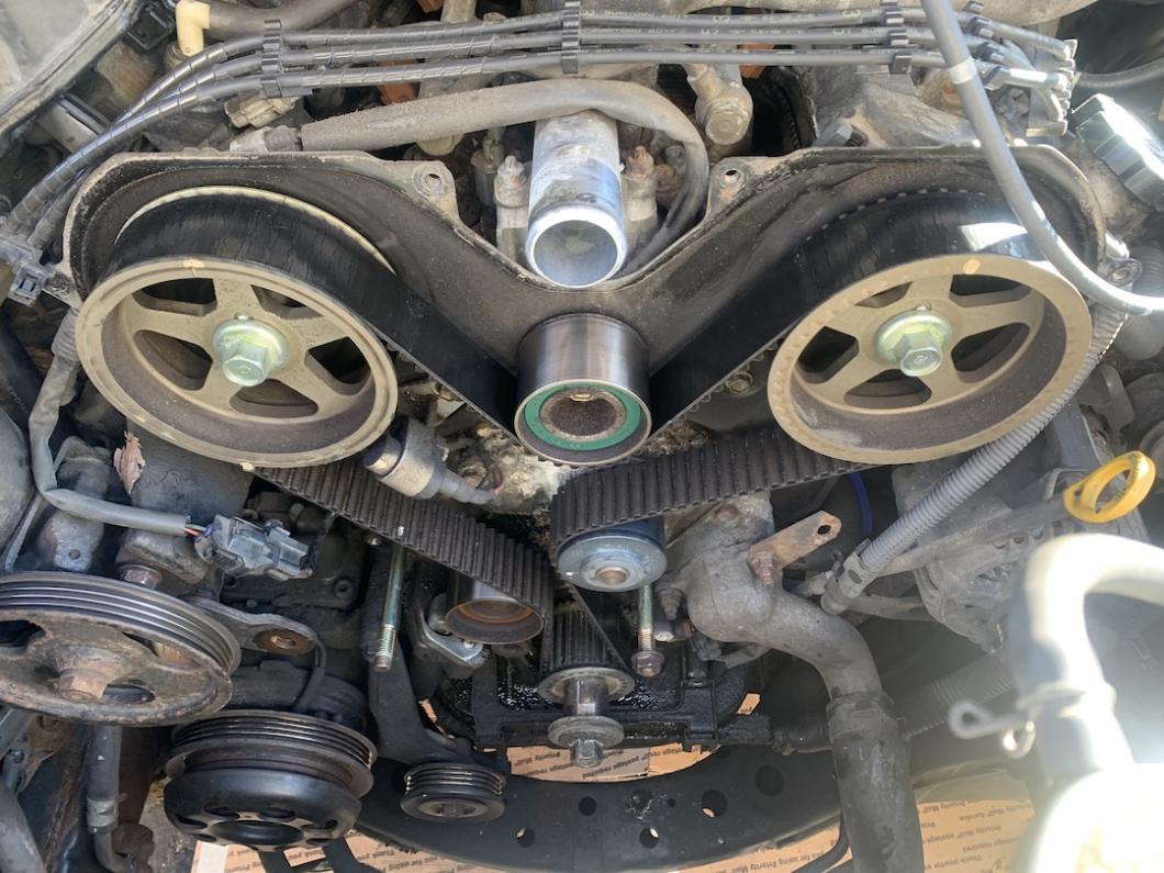

Timing belt day! Everything was toast at 230k and all components were factory from 99'

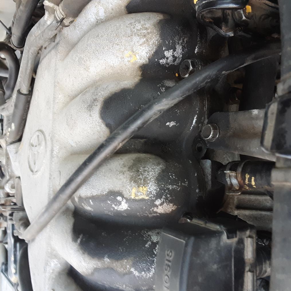

The reason I mentioned the gasket (should have said intake plenum rather than manifold to be clear) was because I changed it from paper to metallic after I removed it to replace an injector. If there was a leak at the two plenum halves at the #4 pipe, could this not cause the condition?
Try spraying carb cleaner (or similar) on that gasket area while the engine is running and warmed up. If the rpm's change then you've found your problem. If you disassemble to check the gasket you may or may not be able to see anything wrong with the gasket.

Thanks, I'll try that.
I pulled the injector from my '02 parts vehicle and replaced my #3 with it. I cleaned and installed new o-rings on all of them.

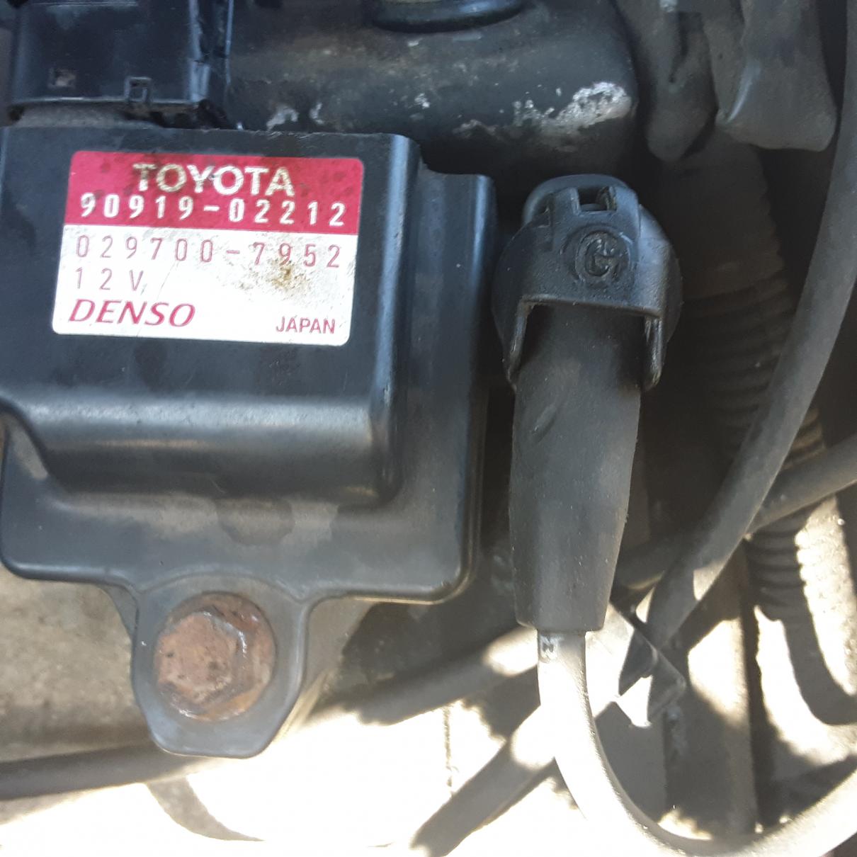

Sprayed all the ignition parts with this, and the miss went away. Cleared the codes and they didn't come back (yet). It had been very wet here recently and there was a freeze the night before the roughness started. Fingers crossed as I'm not too thrilled at the prospect of messing with the injectors.
