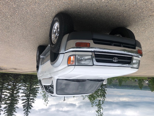

1997 New To Me!
I purchased it...!!!
Took me a couple of months to find a pre-facelift 3rd Gen in a manual that was not trashed out.
I got super lucky and found this '97 that also has the rear locker. 2 owner with 240,200 miles. Runs and drives almost perfect and looks great!
Promptly drove over to the WeatherTech store and picked up some floor mats, rotated the tires (needed it badly but tires are good shape overall) and finished putting 74 miles on it by swinging over to Tokyo Joes for some good grub.

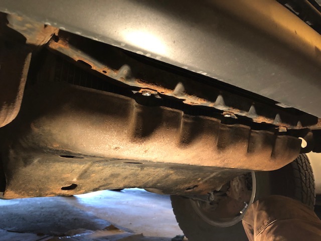

Added front skid plate. Only got 4 of 5 bolts but made sure to add anti-seize to them. Looks like bolt broke off at some point.
Going to leave back piece off for now. Trying to decide if I should paint it and what color..maybe hammered black?
