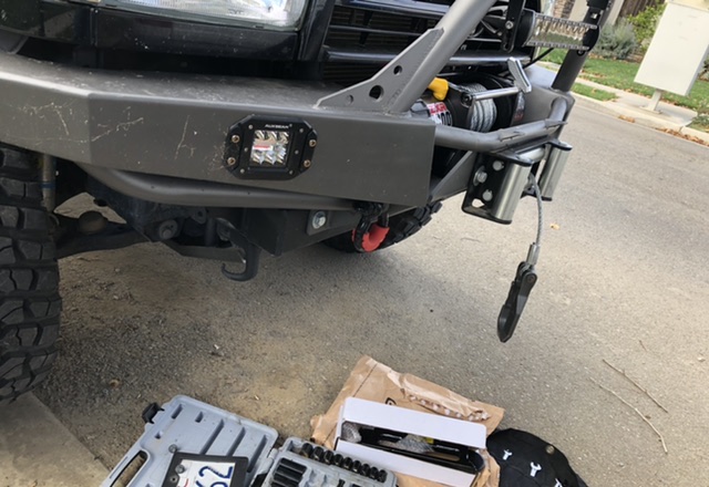

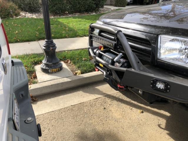

Replaced the bulky roller fairlead that came with my winch with a steel hawse style I snagged off of Amazon. You can almost see my front license plate now.
