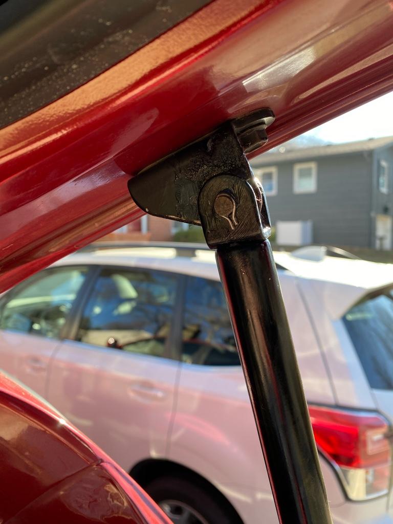

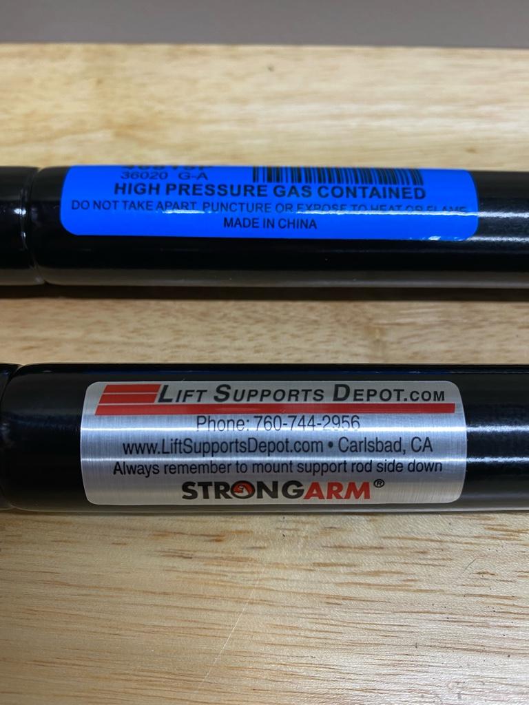

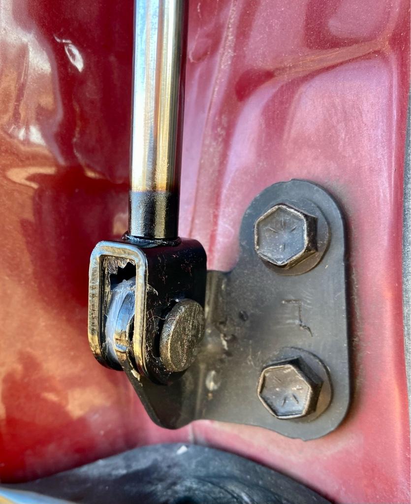

Installed Strongarm 6815 Liftgate Supports.

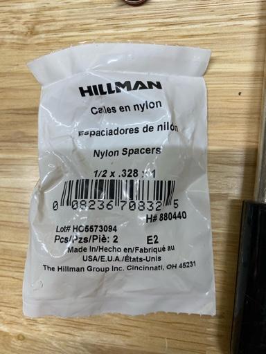

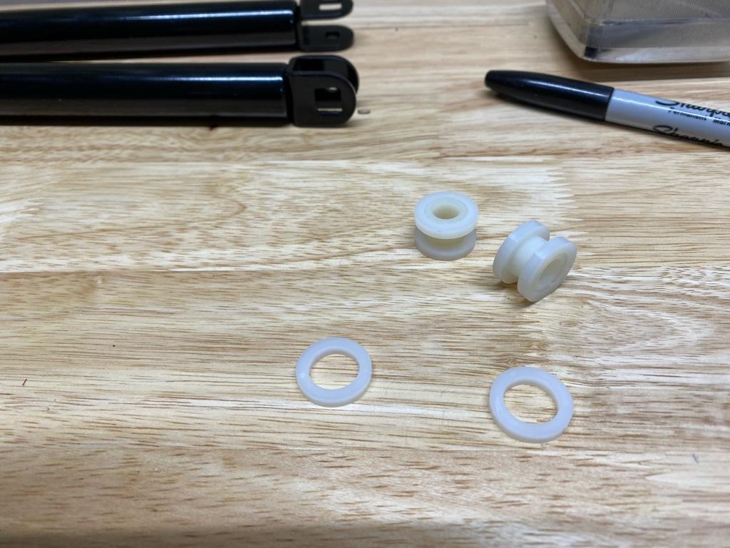

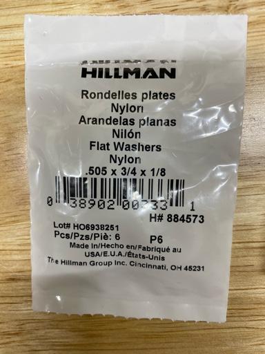

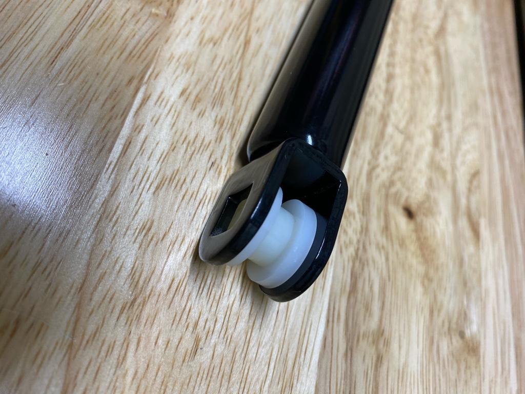

Made new bushings with Hillman 880440 nylon spacers, Hillman 884573 nylon flat washers.

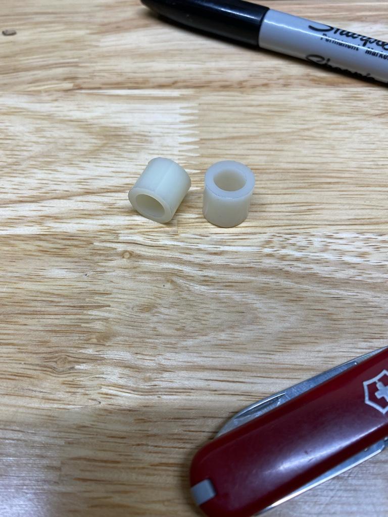

Cut a spacer in half:
Press on a washer at each end of a shortened spacer to create a nice bushing. (You’ll need one such assembled bushing per side for the top, plus one plain washer per side for the bottom.)

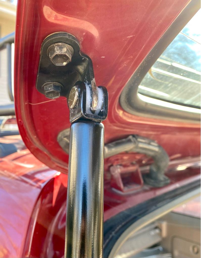

Test fit looks good.

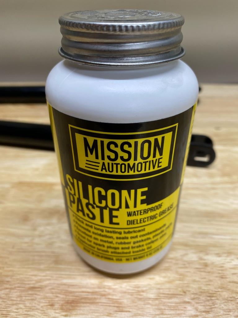

Install with a generous amount of silicone.

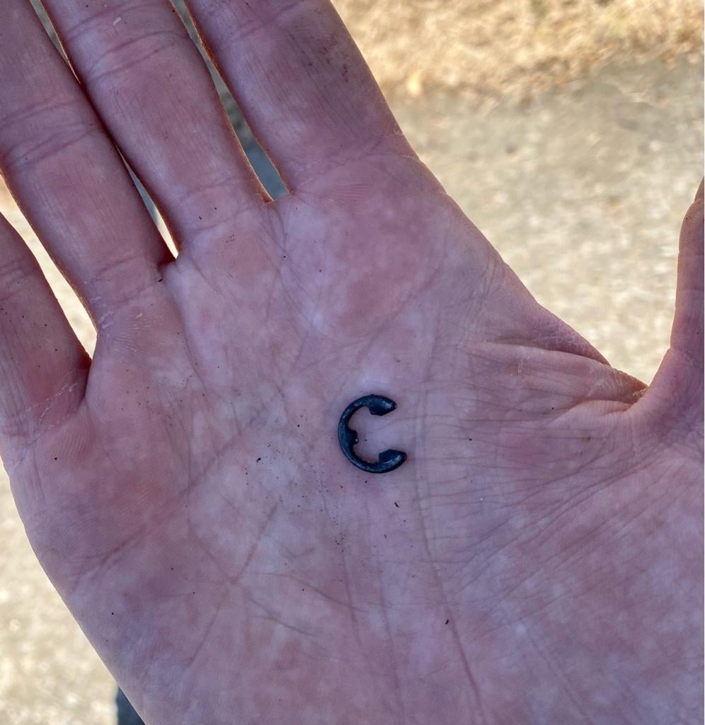

I dropped an e-clip in the grass during removal, and after searching with a magnet for some time, I gave up and decided to improvise with some baling wire.
The baling wire seemed like a decent fit and might have been OK to leave in place. But I decided to look again, and after another few minutes of searching, I found it!
So be careful when popping off those little e-clips..
The lift gate works so much better now, and other people won’t hit their heads anymore!! (I still will…)

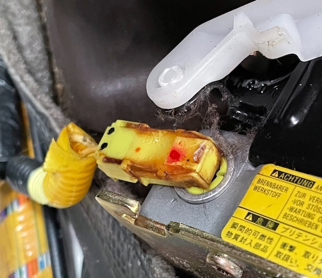

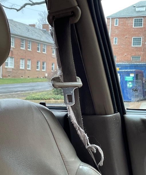

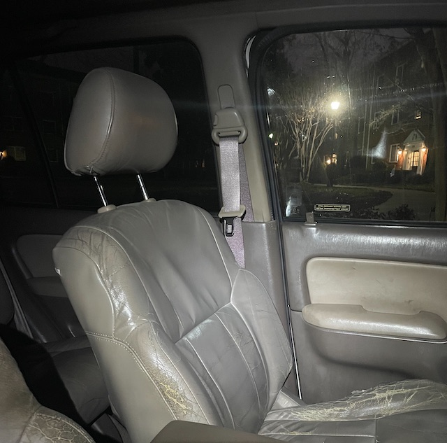

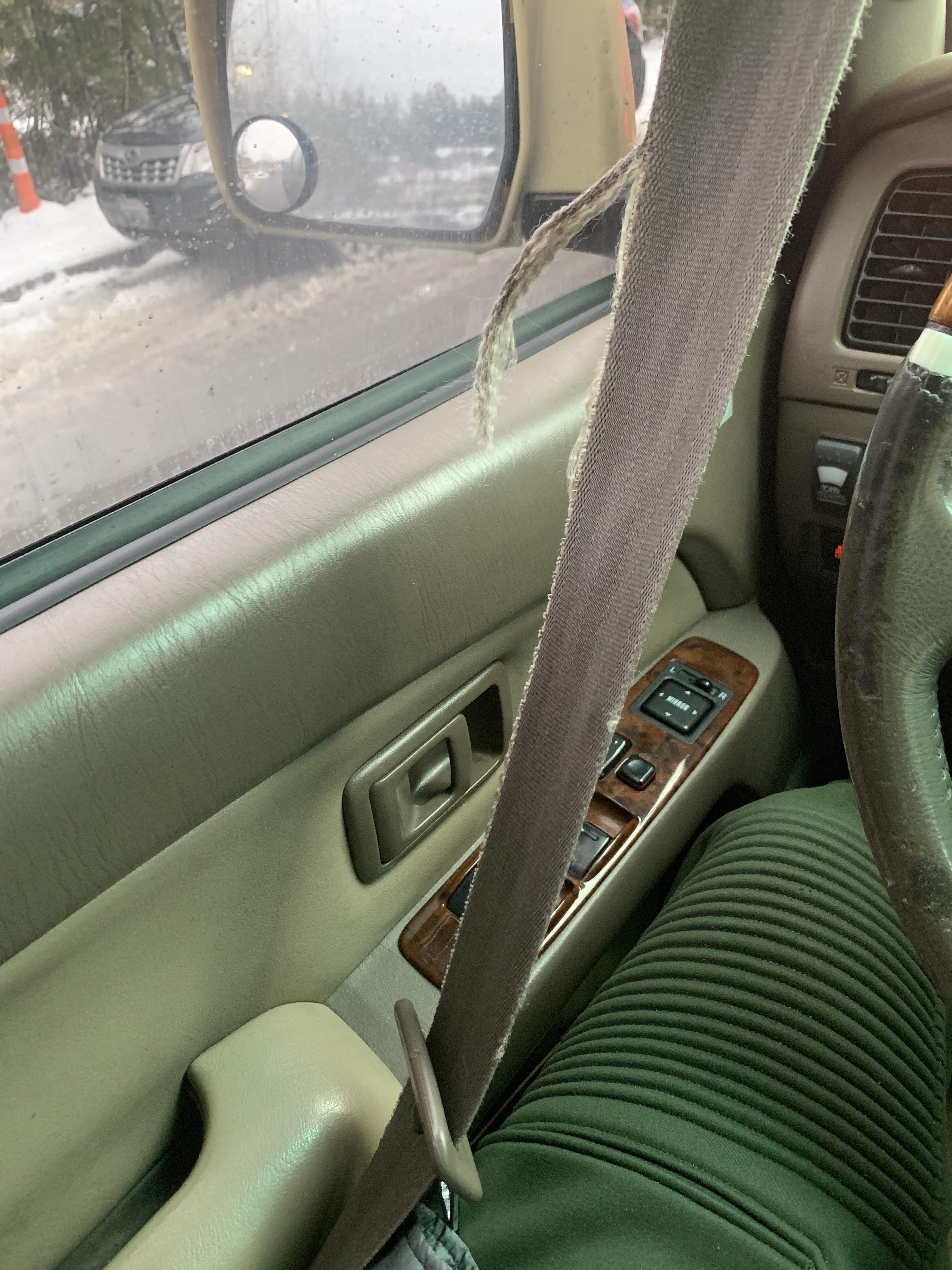

Driver's seat belt. Part # is: 7322035491E0
If you're a daily driver like me and have an old frayed seat belt, this is a high impact repair that makes an incredible difference in the quality of the driving experience.
Tools needed are a 10mm short socket, 14 mm short socket, trim tool, and JIS screwdriver for the floor trim.
Be careful not to yank too hard when you remove the old assembly near the floor because the yellow wire for the seat belt light doesn't have much slack and looks easy to break.
Pics: 1. Before, 2. Yellow Seat Belt Light Wire & Connector, 3. After
Mines is not as bad as yours and when it was all frayed I cut it off with my knife. That’s why the top looks like that and it’s fraying again. Stupid me had an extra good drivers belt, but threw it away last summer when I was cleaning
